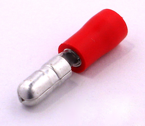

The OE connection is known for being poor, so chances are someone has cut it off and used the "bullet" connectors shown in your pic. No problem if they are done properly and water tight, but as you blew the fuse, maybe they aren't perfect and shorted.

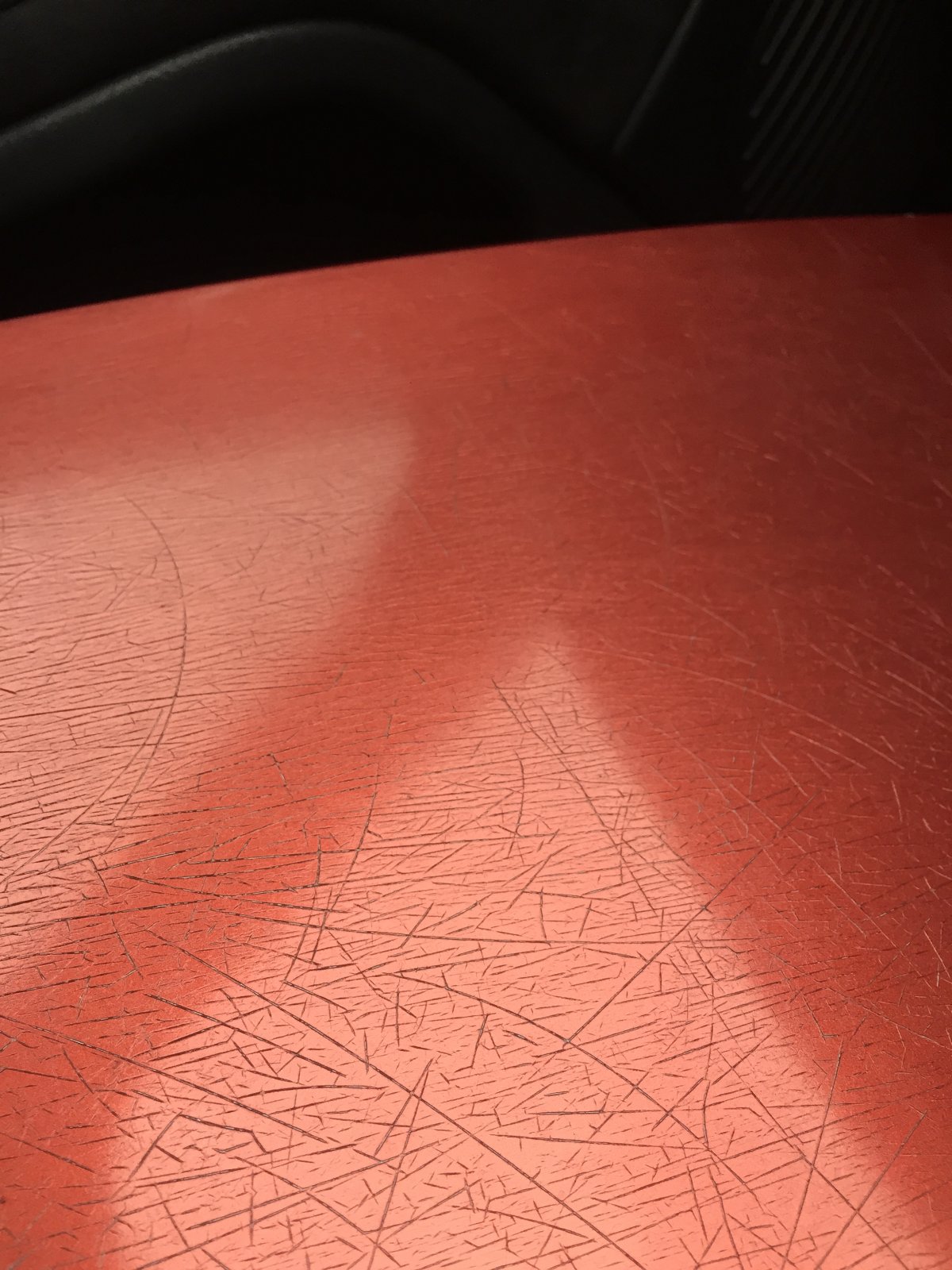

The prev. owner had it painted to match the car, and it looked great when I first bought it, but over the last couple of years it has worsened and 'crazed'. So it's currently at the bodyshop being painted.

Good stuff, will look miles better

What I had meant @Davyy was that because the bullet connectors had the 2 female parts on the brake light side, that on the other side they'll look like this most likely.
So could've easily touched and shorted out.

Ah, yeah ive got them wrapped with electrical tape together, so probably touching right now!
