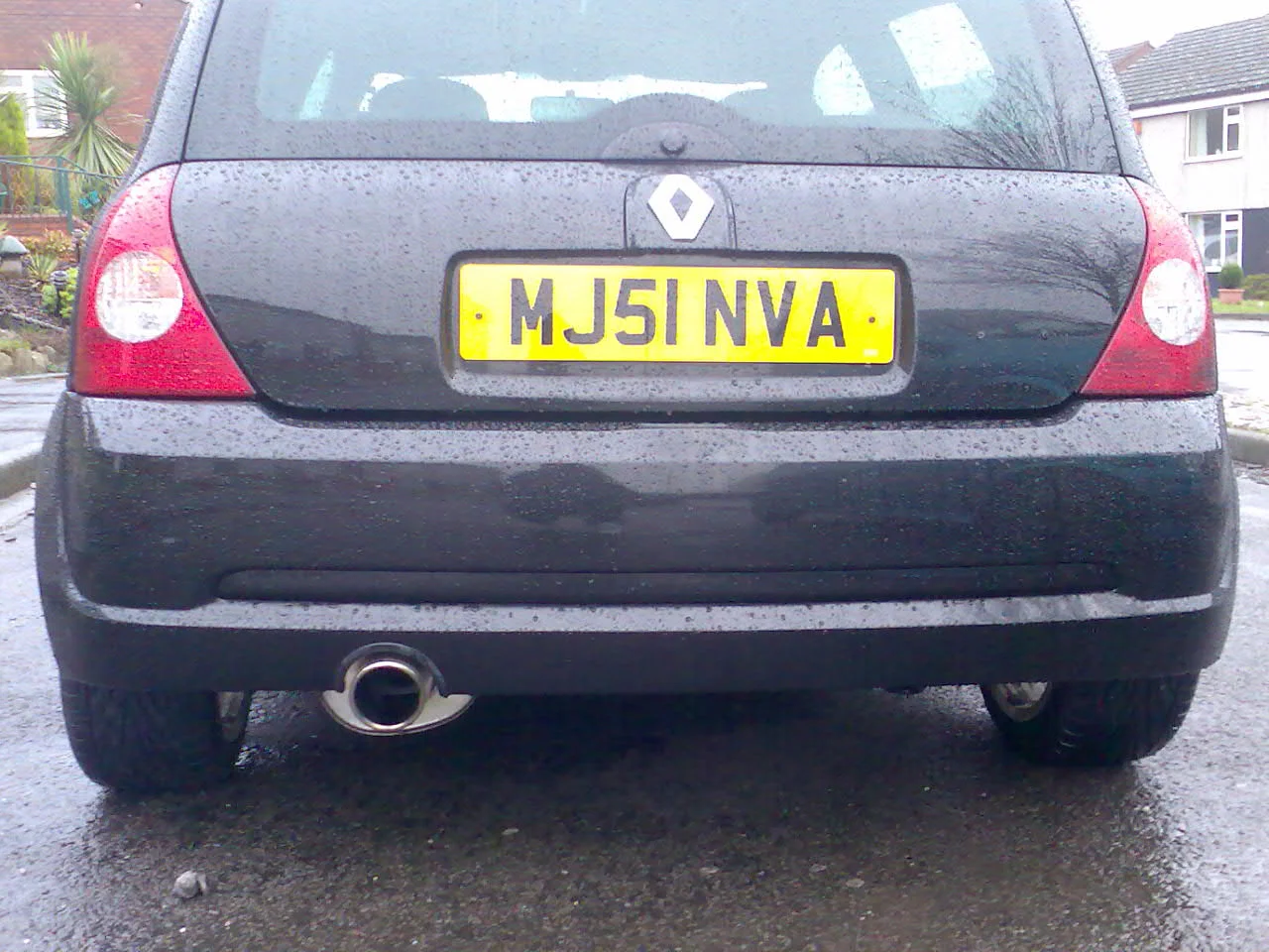

Ive done mine, filled the hole and colour coded it!

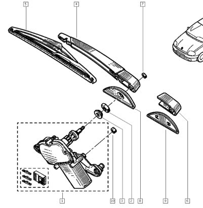

No 9 looks like a blanking bit? Couldn't be sure though, doesn't list a price (old dialogys)
8200/245/091 is the part number if anyones interested
I used a peice of plastic to glue on the back (t stop the filler falling through) and just used body filler and wet and dry to mould it into a dome so it didnt look flat and gay! Then sprayed with pearl black and lacquerd over it. All the paint and filler can be brought from Halfords......
