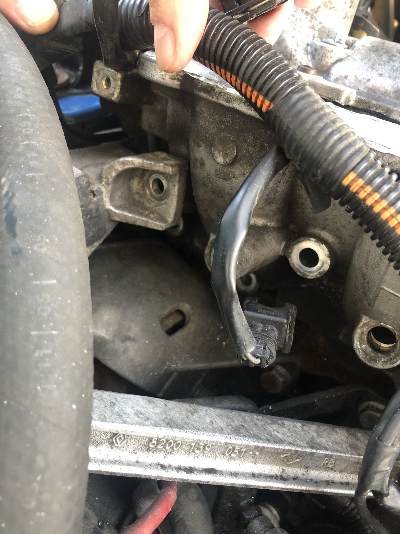

Having problems removing the bottom inlet! Is there a guide anywhere? All the bolts are out but can’t get it to move from the alternator bracket. Any advice? Cheers!

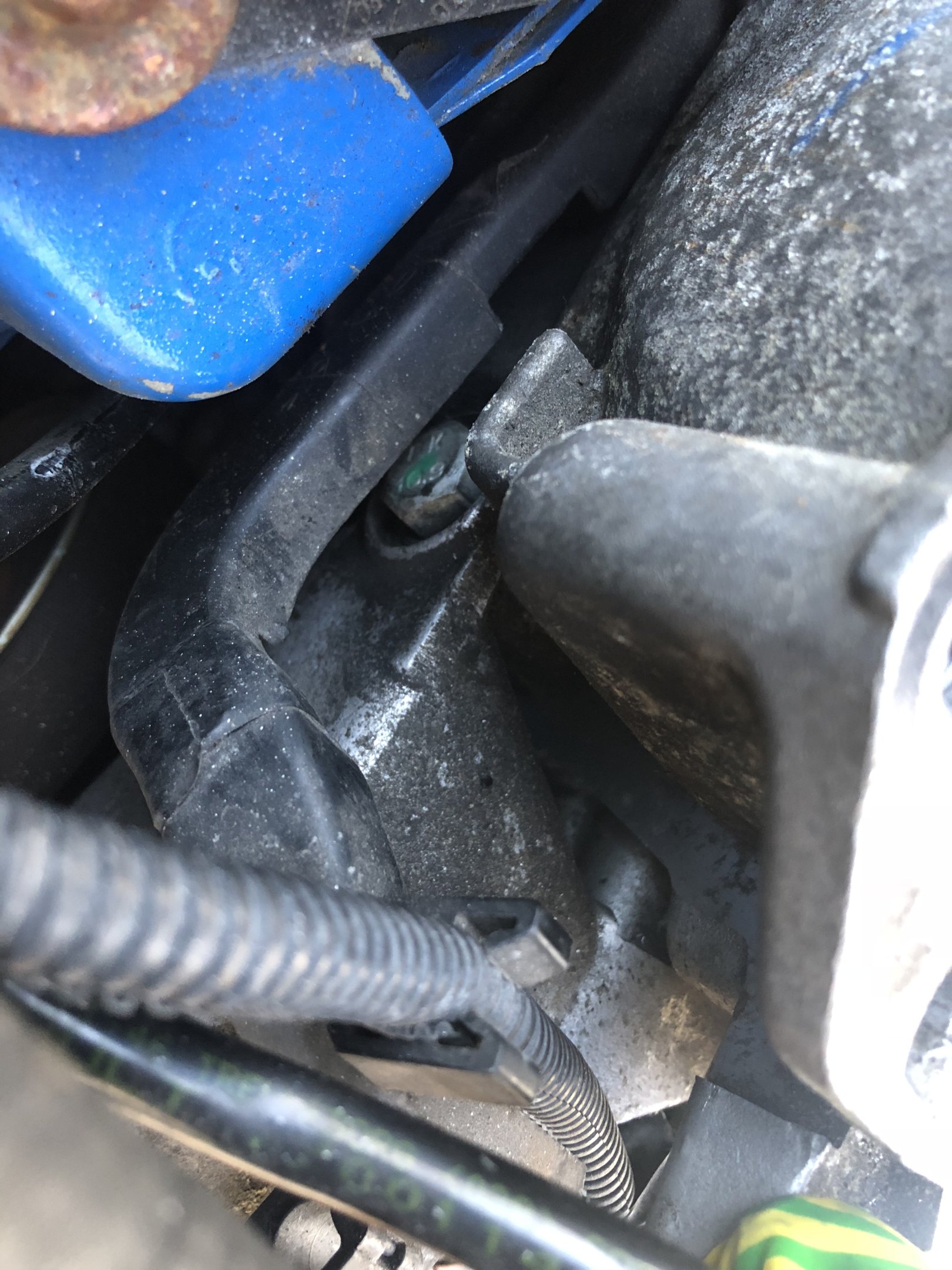

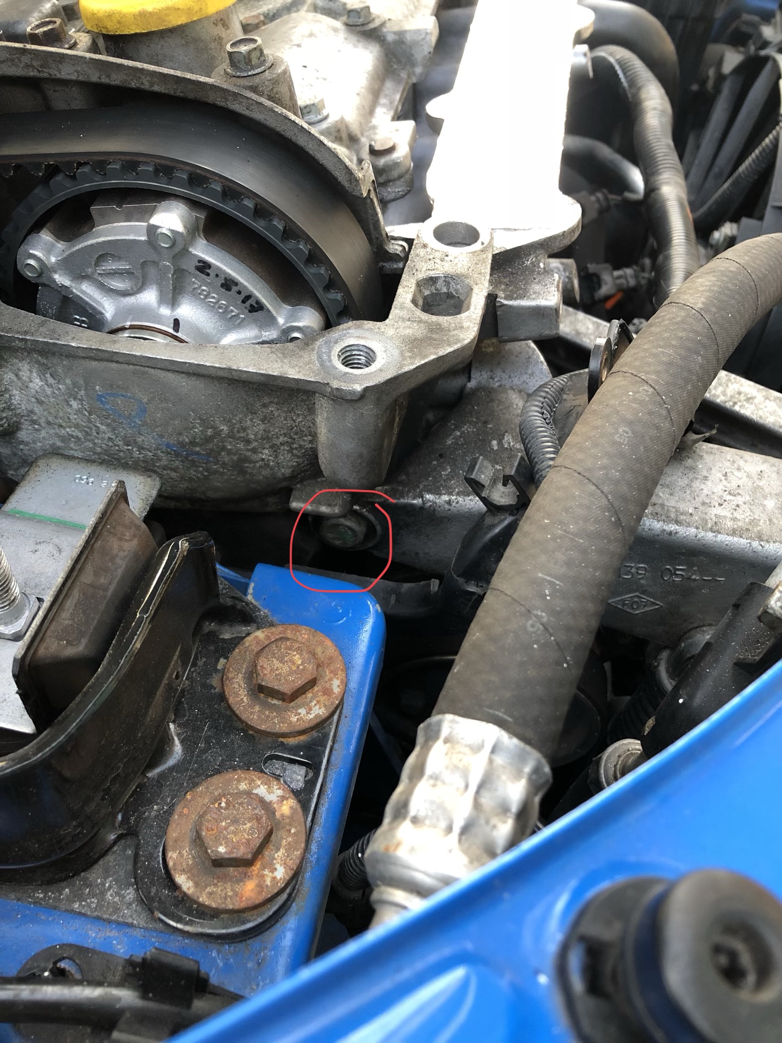

theres a bolt on the left hand side of the engine, and one down through the cambelt cover did you get them one too?
No I’ve just found that one! Is it ok to remove? It looks to be holding the alternator?

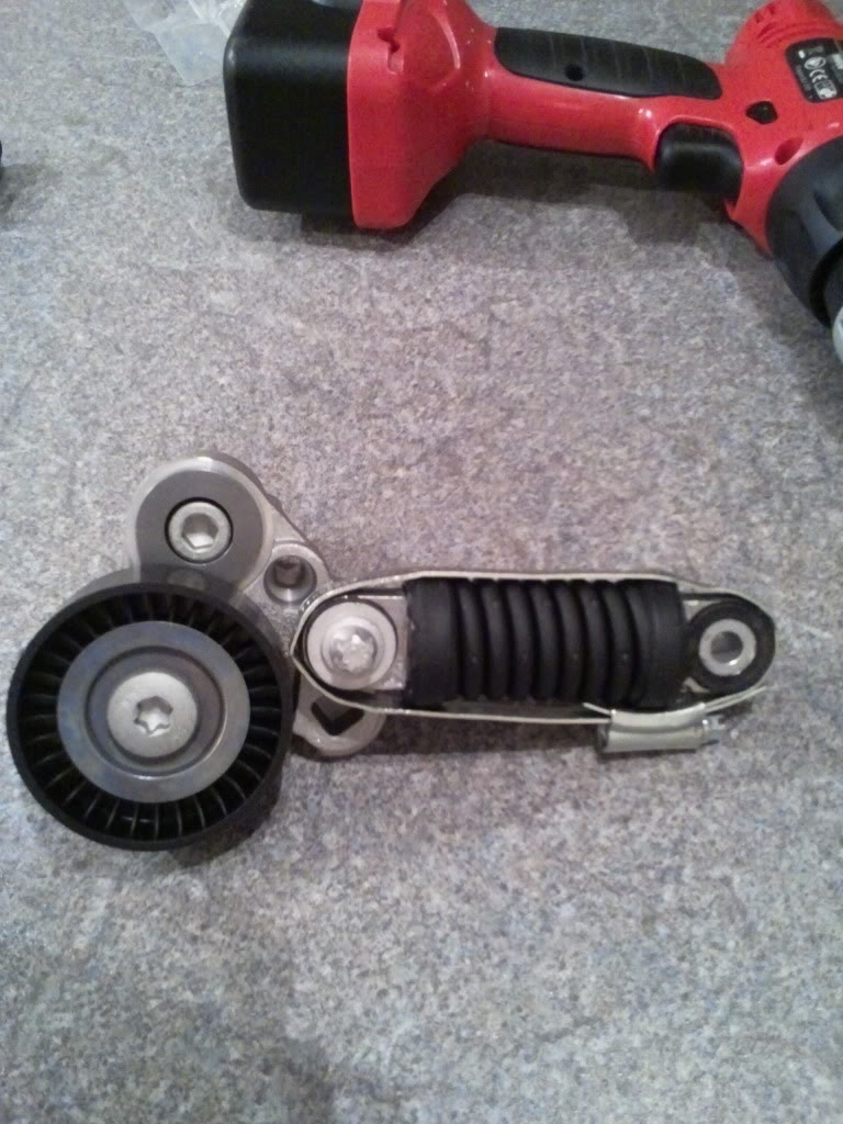

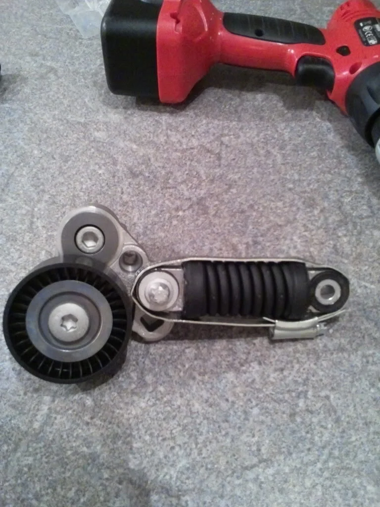

jubilee clip around the tensioner, you can just get away with tipping it forwards as it doesn't actually need to move that much.
