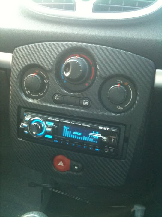

Here you go, sorry about the piss poor iphone quality:
Thank you! That look mint! With the circles where the vent controls are did you find it hard to not let it like gather, cause when i did the strips above my glove box when i got to the ends had to do a lot of of little cuts lol to make it fit round or is that me being quite backwards how I've done it lol
Cheers mate, Ive had quite abit of experience with vinyl wrapping so wasnt to difficult to be honest, you just need to be patient. When it come to the curves just take you time and heat it up with a heat gun/hairdryer and begin to slowly stretch it.
