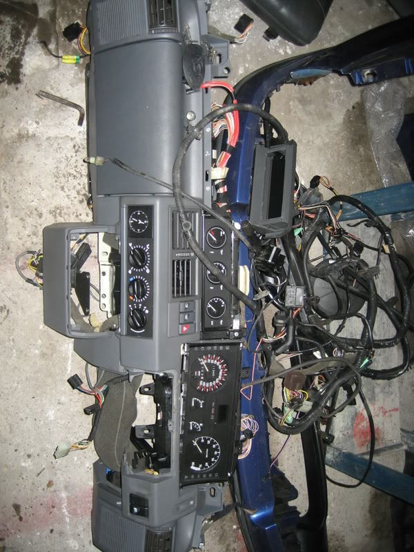

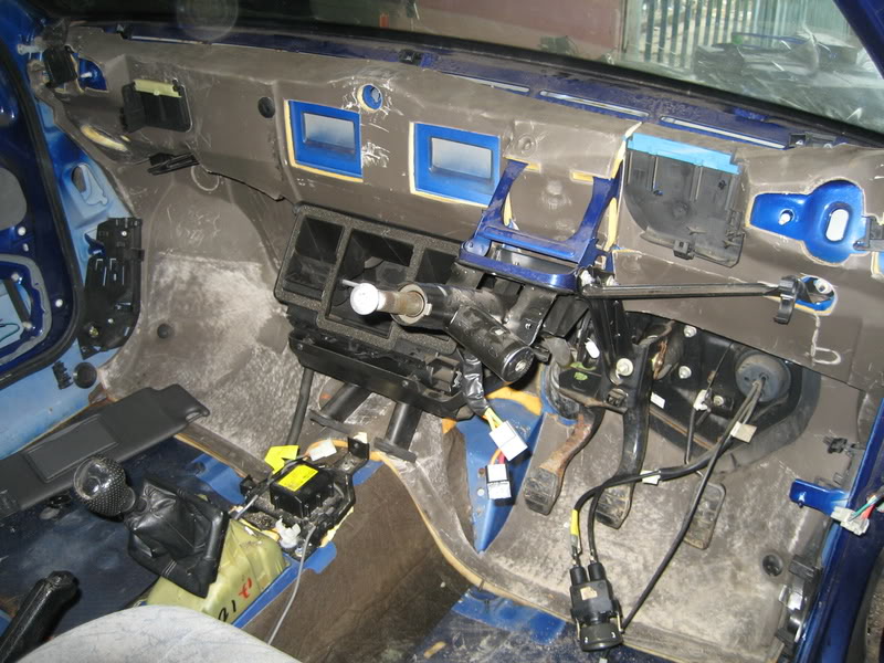

Undo the 4 10mm nuts (2 on either side, 1 top and 1 at the bottom) and pull the dash forward a bit. You'll then be able to see 2 multiplugs on either side. There are also plugs right in each top corner that need to be undone. Disconnect these and assuming Ive/you've not forgotten anything you'll end up with this
If I remember anything else I'll add it. Sorry if its not 100% been a few weeks since I last did it!
