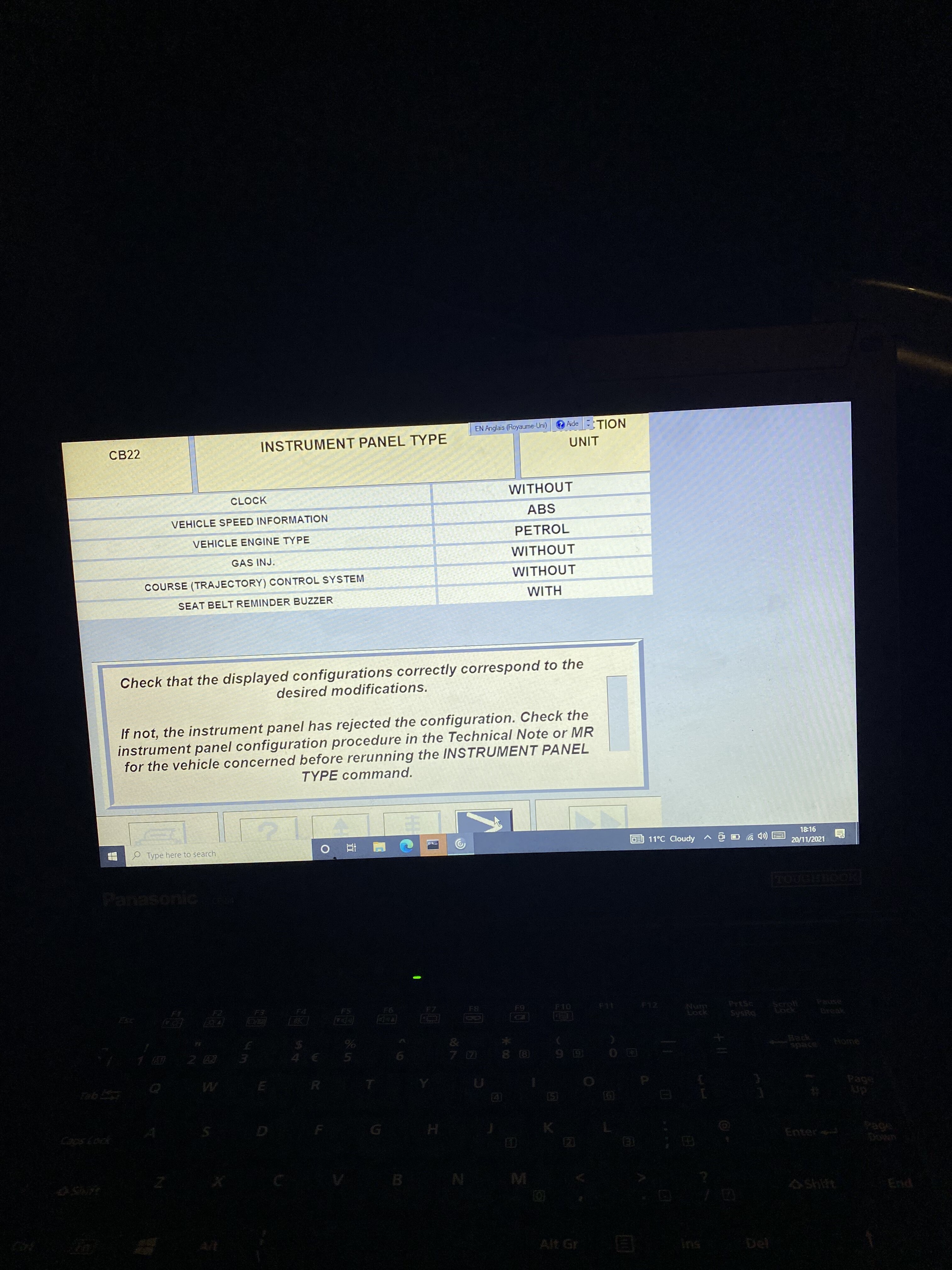

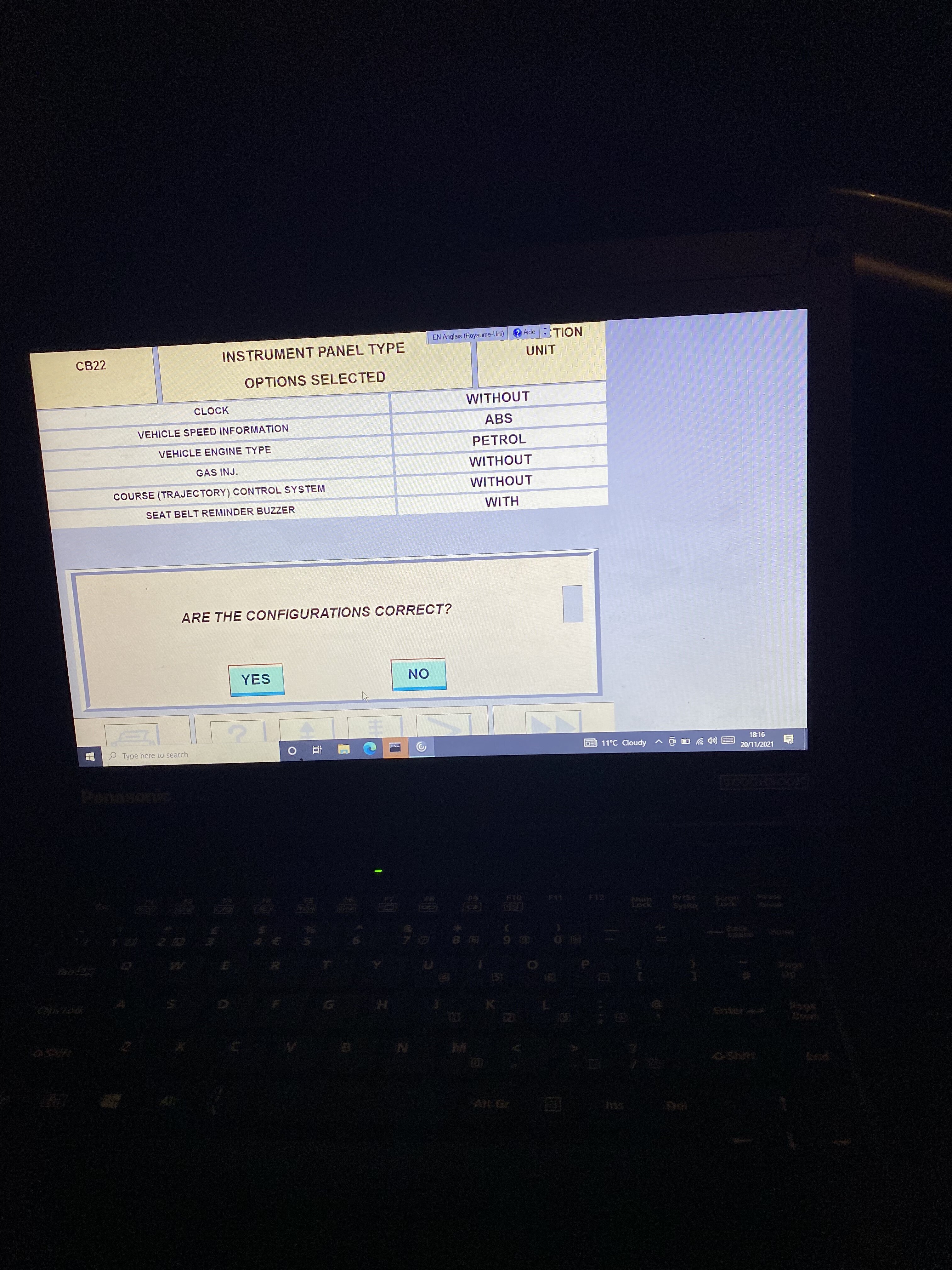

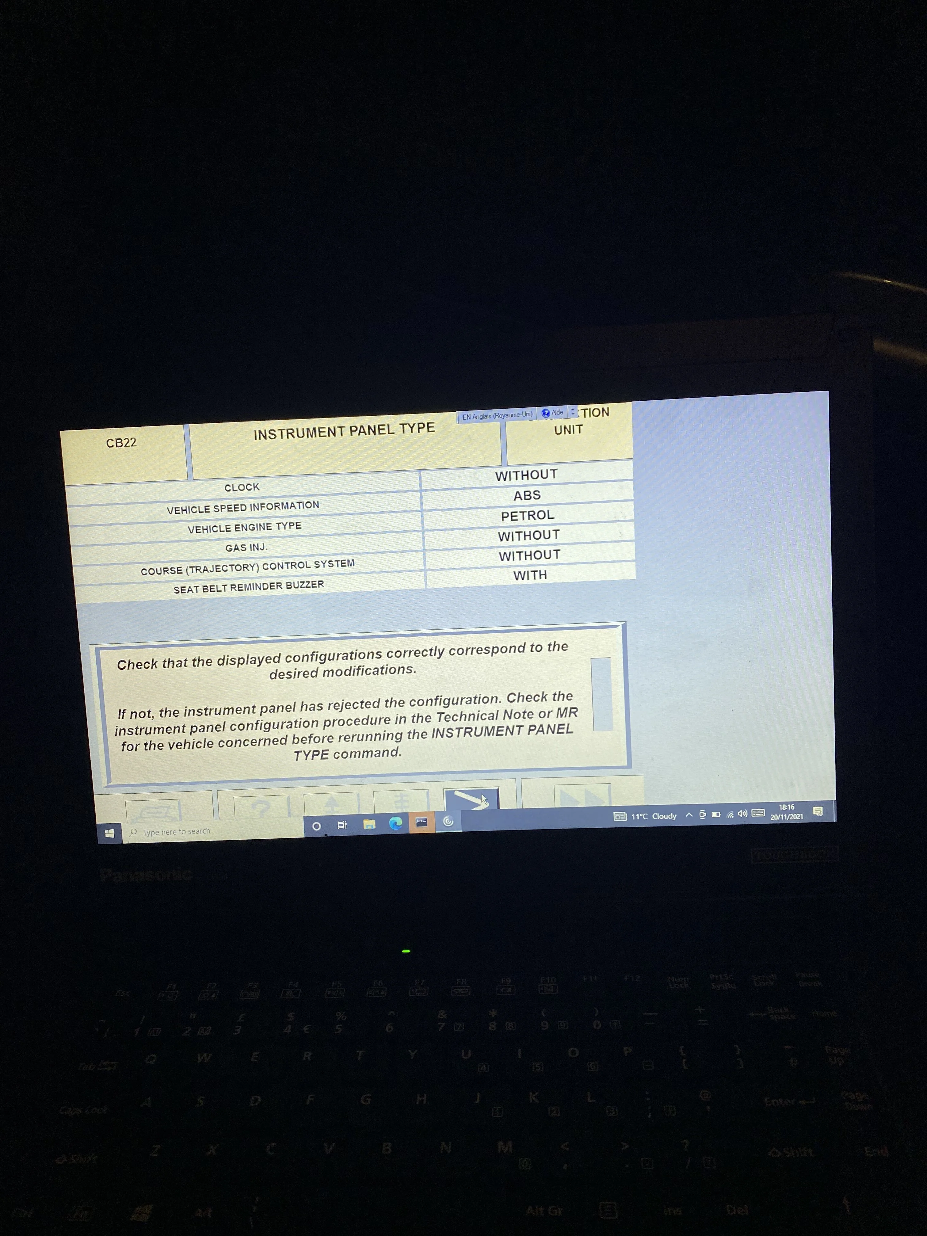

Incase anyone is interested I managed to do
It, bit of a headscratcher but if someone wants to completely remove the esp lights and not have to push a switch anymore there is a way.
or if they have fitted a quick steering rack to their road car 👍👍👍

I turned the trajectory control off on my old Kangoo and got rid of the multiplex issues with clip. Does the asr still kick in as its only disabling the light on the clocks from memory. Mine was cup setup no abs so did not have any issues in that respect.
Nothing kicks in with the Yaw sensor disconnected. Even with the dash configuration when the yaw sensor is connected it still did have a hint of kicking in.. obviously with the quick rack it exaggerates everything. But as said with yaw disconnected and the configuration set without trajectory it’s perfect, and most importantly no lights!!
And ABS is totally un affected!
