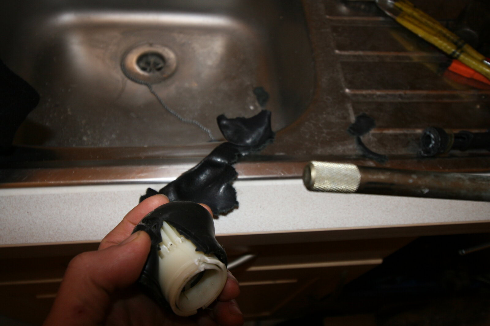

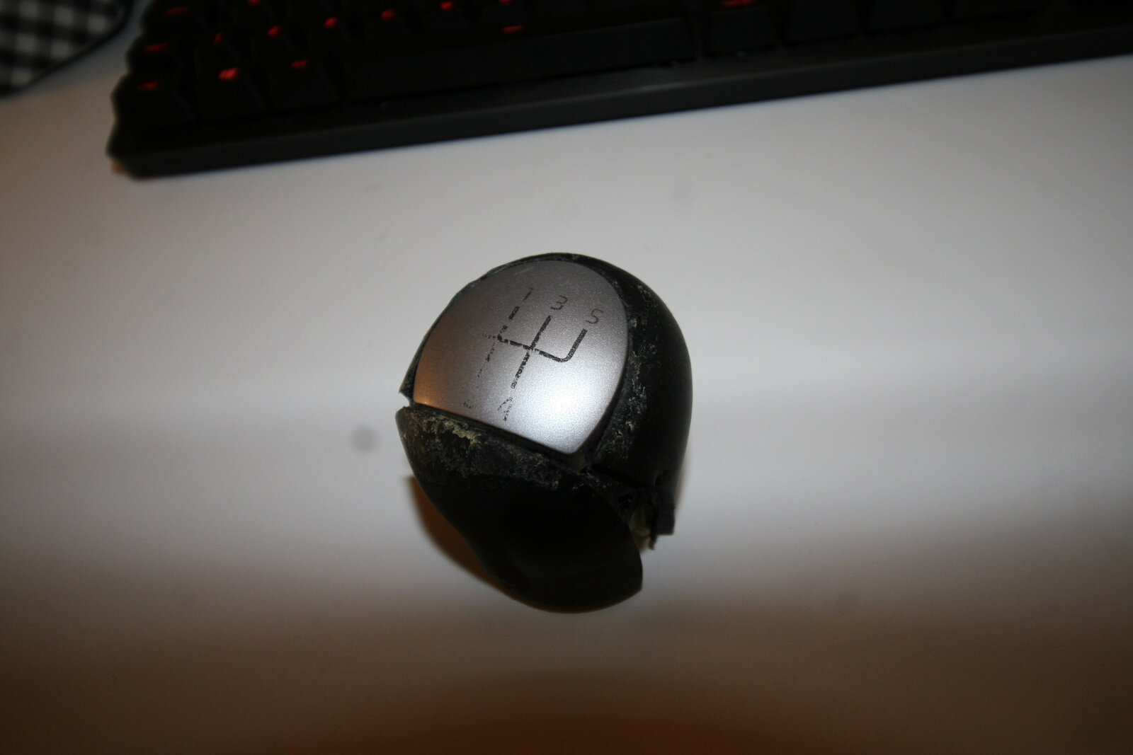

Well got it off. Twisting it destroyed the leather but it peeled off and the insides was still intact so I peeled back the rubber and twisted the plastic which got it off. Its the leather that screws things, I could of cut the stitching off the leather and taken it off intact
