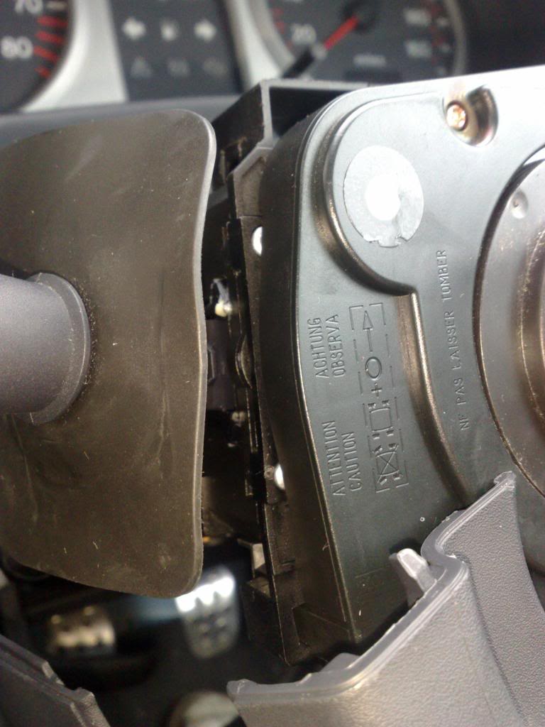

This is what im faced with, any ideas?
Do you think its the same as a 97 plate 1.2 Clio ?
If so.....

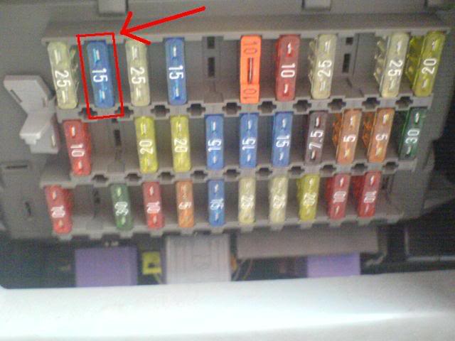

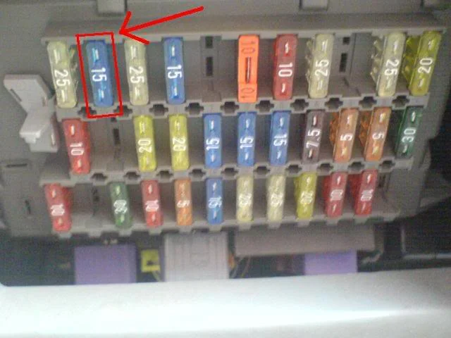

Then remove the SRS fuse for the airbag as you are working close by

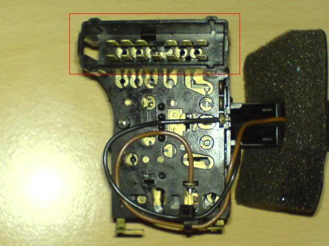

Then remove the wring noting there the positions of the two bottom wires.

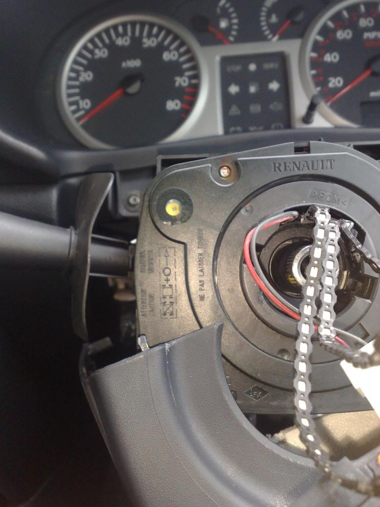

Take the ESP sensor off, make sure you dont move the steering or the sensor or it will end up being bin bait.

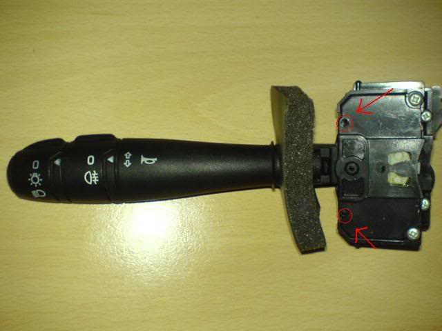

Then undo the 2 screws that hold in the stalk assembly.

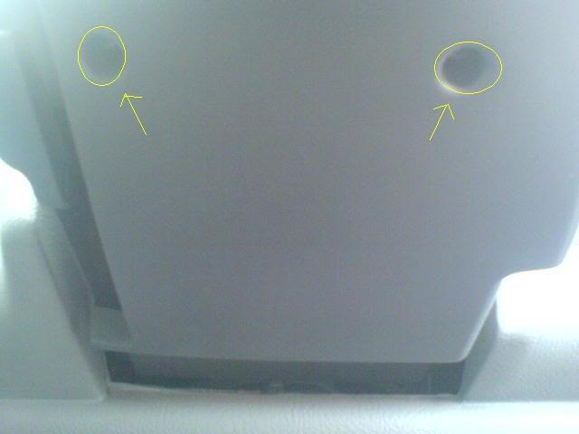

Ouch this dosnt sound good, so undo the security screw things (5 sided with the pin in middle) pull the black shroud towards until enough room to get at the screws

waiting (LMAO E-celeb!) on matthew to finish work to see if i can borrow his 5 sided torq bit

Is the ESP sensor the unit seen in pics one and two? If so, how do I remove this correctly? As above, I'm swaping indicator stalk and there doesn't seem to be any info on this model of car.
