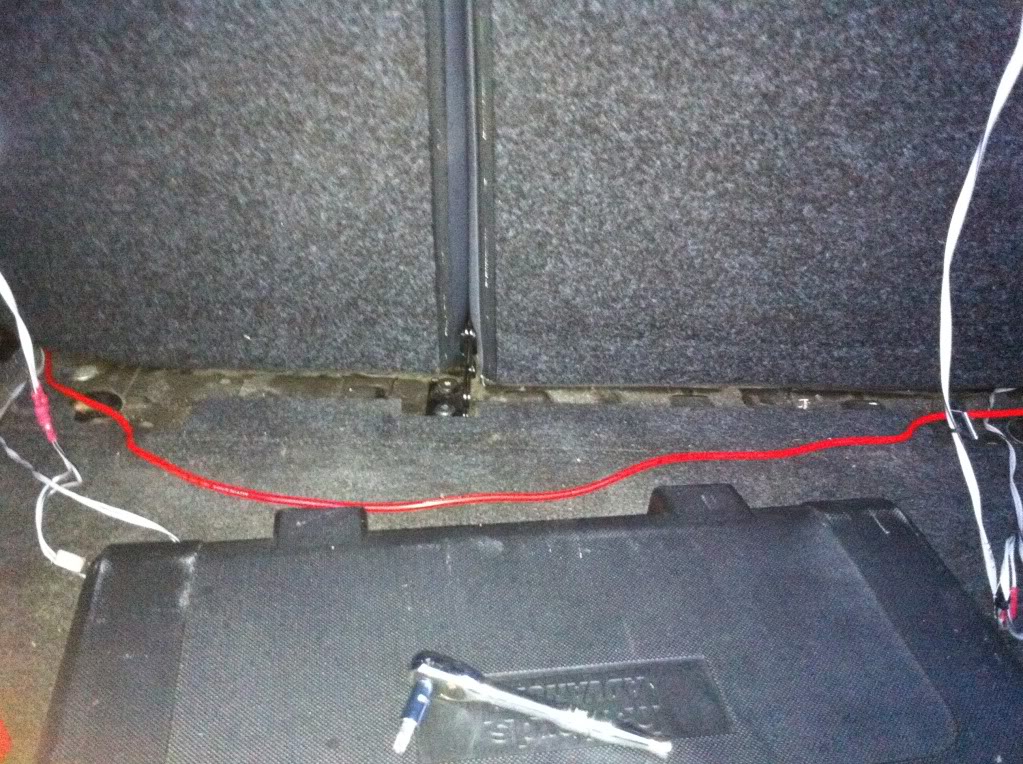

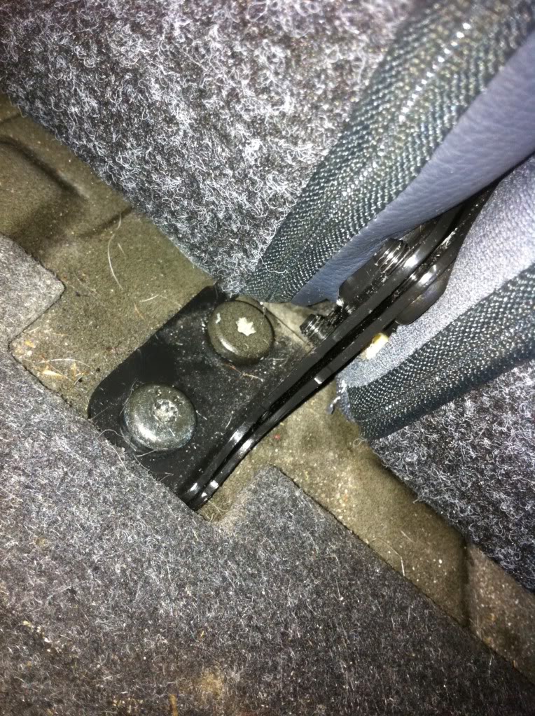

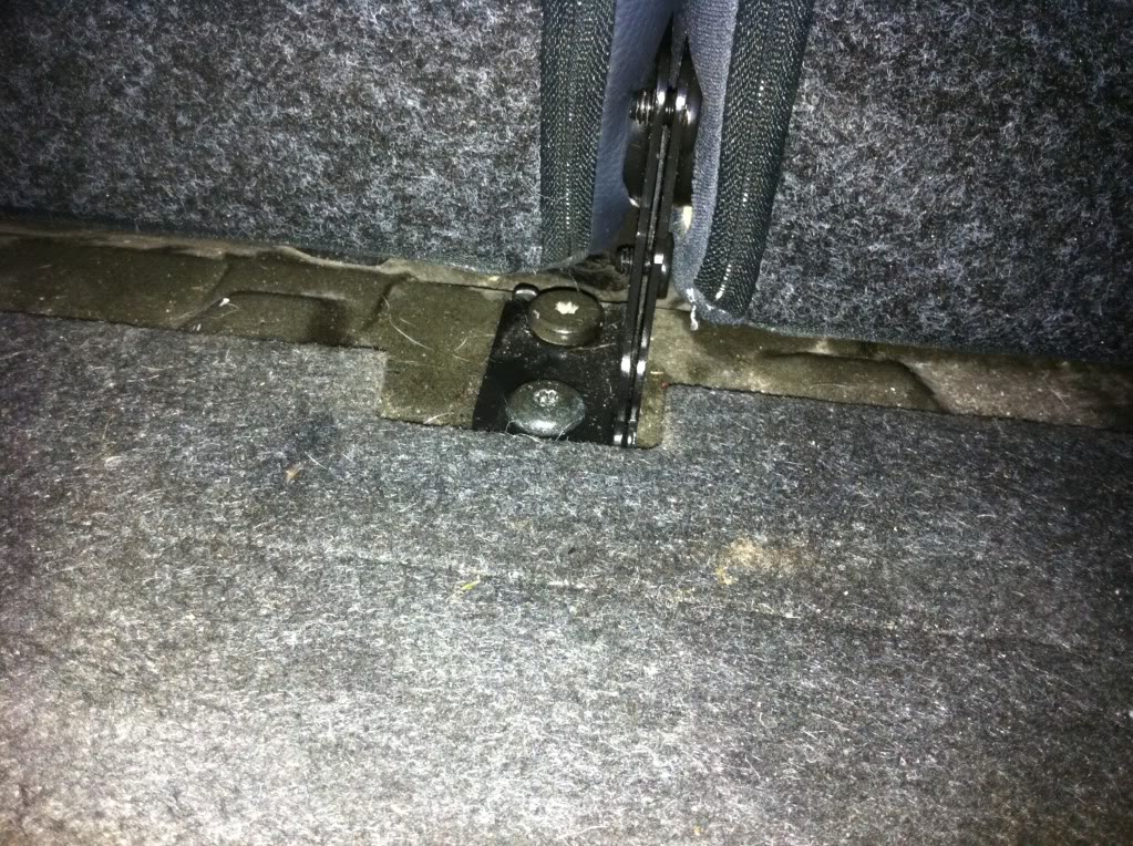

Right, changing my rear seats for sport ones and have just managed to get the black bar out from behind the seats and that was an absolute b**ch to get off. But Im just curious as to whether you are supposed to undo these next?
They literally wont budge, I dont want to break the thread because then that would be a disaster. Can someone please give me some help? ;)

Only need to undo the one furthest back towards the boot, the other just half a turn to slacken it

As said, you only need to fully remove the one furthest toward the rear of the car. The one further forward you can just loosen slightly, then the bracket will slide out.
