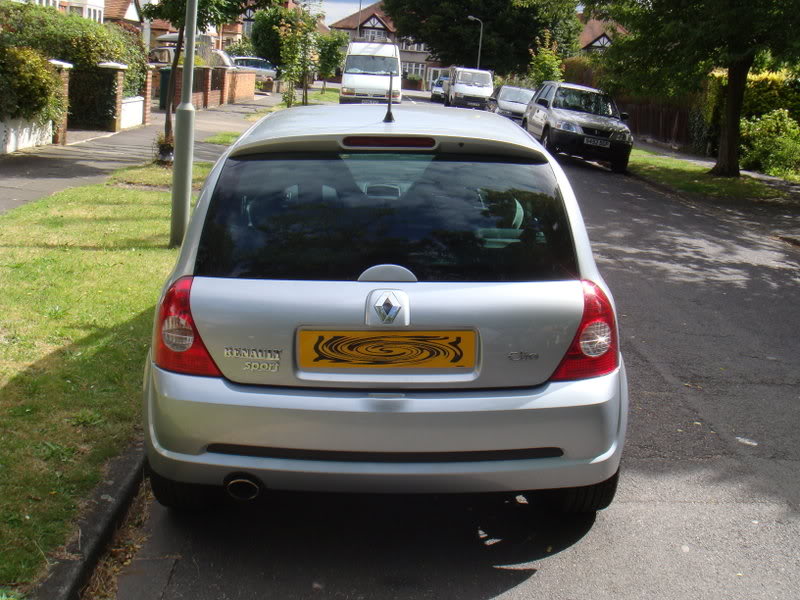

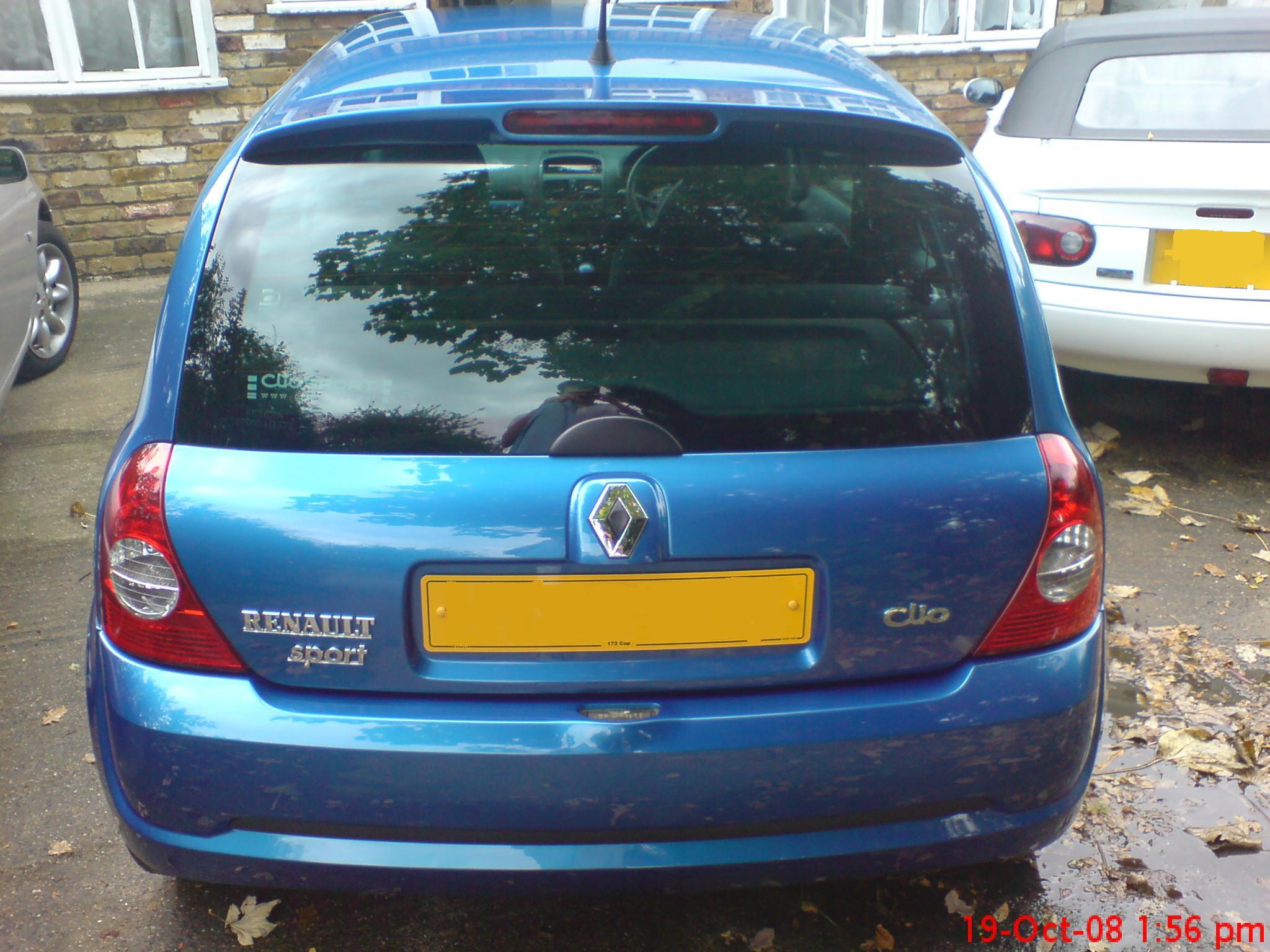

i think that it looks good and was thinking of removing it. (pic below looks mint).

^^^^^^^^^ umpin car change them f**king lights. Anyway youd have a hole where the wiper is, could get a grommit to fill t but the one above has a full cover...
Just smoothed & colour coded mine, Plan to do the same thing for my track car at some point too
Yeah that was what I was worried about, getting a cover like that one, best make sure I get one before I de-wiper, don't really fancy having a grommit! If anyone finds one give me a shout (;
The one in that pic looks like the cup racer wiper blanking blanking plate.. pricey for what it is
the plain covers arent available anymore, they were 19 quid anyway, standard one with the hole is 4 quid
I got my grommet from Halfrauds for 2 quid. Looks much tidier tbh.
Most cars with wipers look wrong imo ;) I'm just weird.
Probably stick with a grommet then if I can't find a cover!
