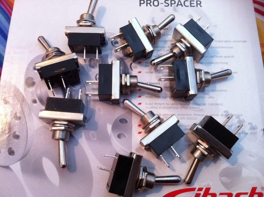

With the wiper motor for example do you have a wire going from the + battery, to a small fusebox with an appropiate fuse then a wire going to the on/off switch, then to the actual wiper motor and then another wire goes to an earth?
Is that the correct way to wire up that type of part?
I have these for the switches
  172 Race Car
Yes, but remember the wiper has two speeds (if you want it to have) ours is wired to have 2 speeds but doesnt self park. Was the simplest way
