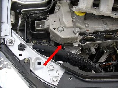

i've had my car to pieces today trying to remove the inlet manifold. not a huge problem but there is one bolt that i cant work out how to remove. there's not enough gap for a socket etc..

found the pic now ;)
support engine and remove the top mount, then if its the one thats resessed in the bracket use a swan neck or box spanner to undo it
loads of people will say no need to remove the mount but it saves your knuckes if you do and its only 'bout 4 bolts and a stud. remember to support the engine first

i think i'll get down to halfords and get a swan neck spanner.
what size do i need?
