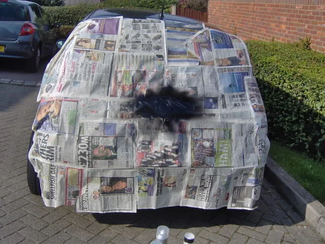

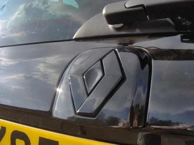

I pulled the front of mine and sprayed it and I just sprayed the rear in position by covering the boot with newspaper.
