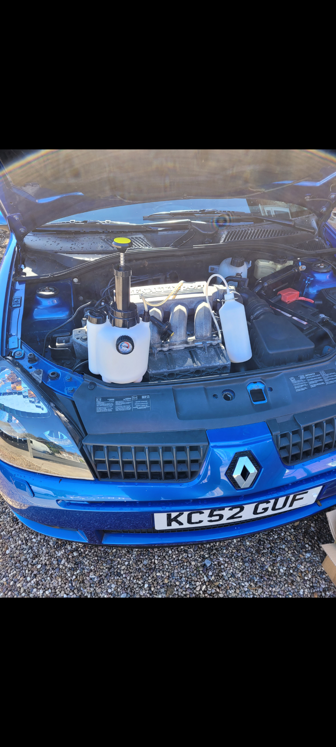

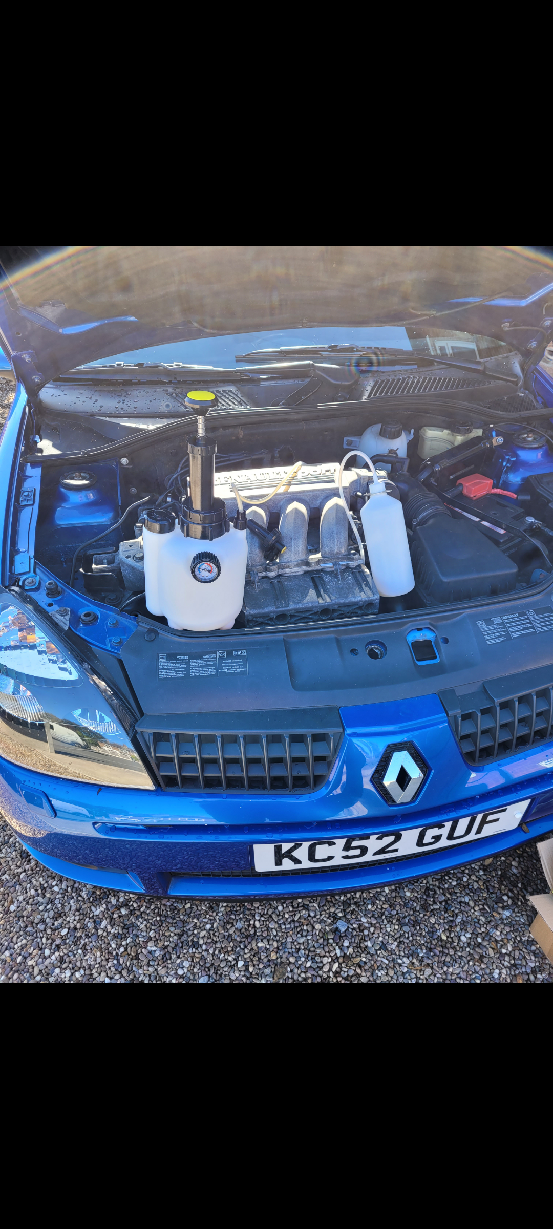

If the problem persists I'd suggest using one of these bleeders before looking for a new compensator, had a similar problem on mine after fitting a new caliper, just would not bleed with pressing the pedal or pulling a vacuum, knew the compensator was good as it was new and the rears worked perfectly (well until the 1 caliper seized solid) used this thing & had it sorted in under 2 minutes
Oh 🫣 well at least the compensator isn't knackered 🤣That’s what i have.
