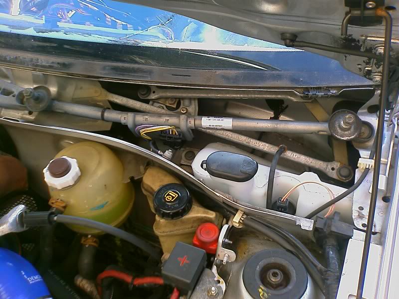

Found a pic of mine to help you. As I thought after taking the wiper arms and panel off its just the one bolt and the bottle will come out.
Took mine out this morning didnt touch the wipers, just undid the bolt which is a bit awkward then unclipped the wire connectors and unattached the little black pump of the front. It came out with a bit of a pull and a wiggle.
