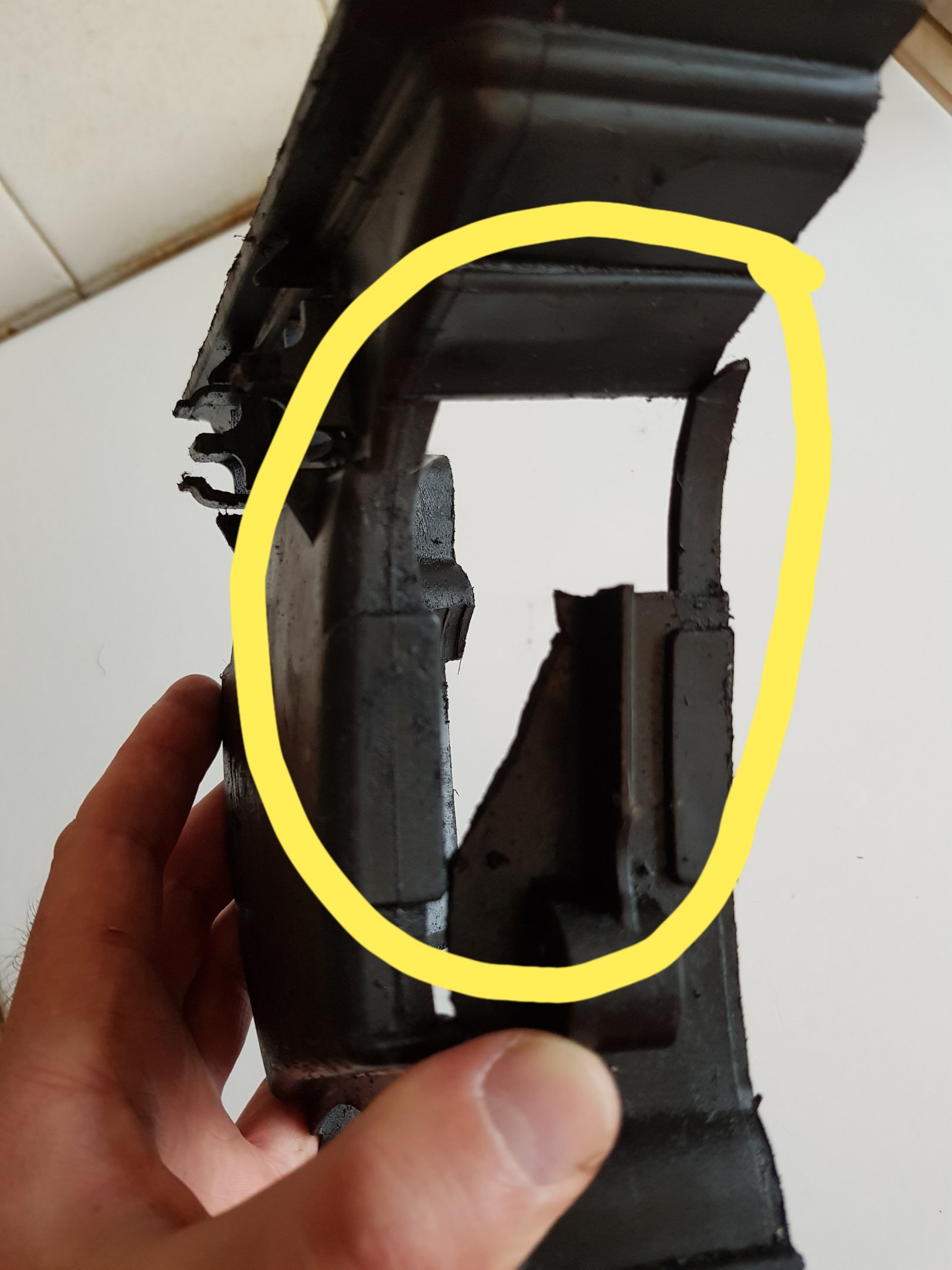

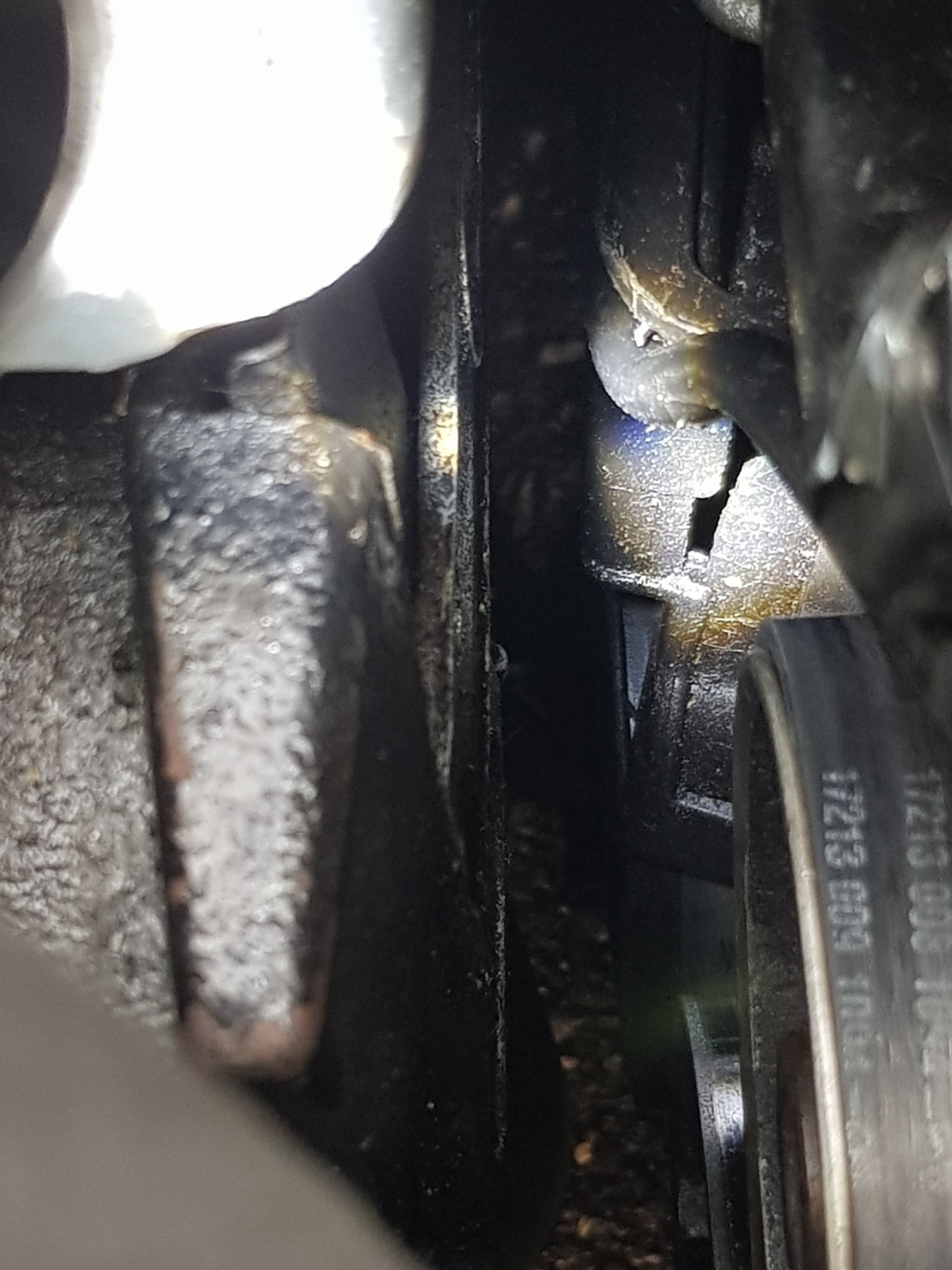

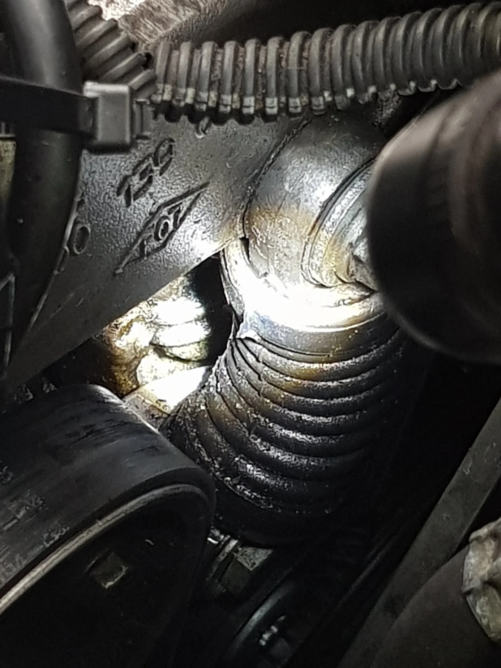

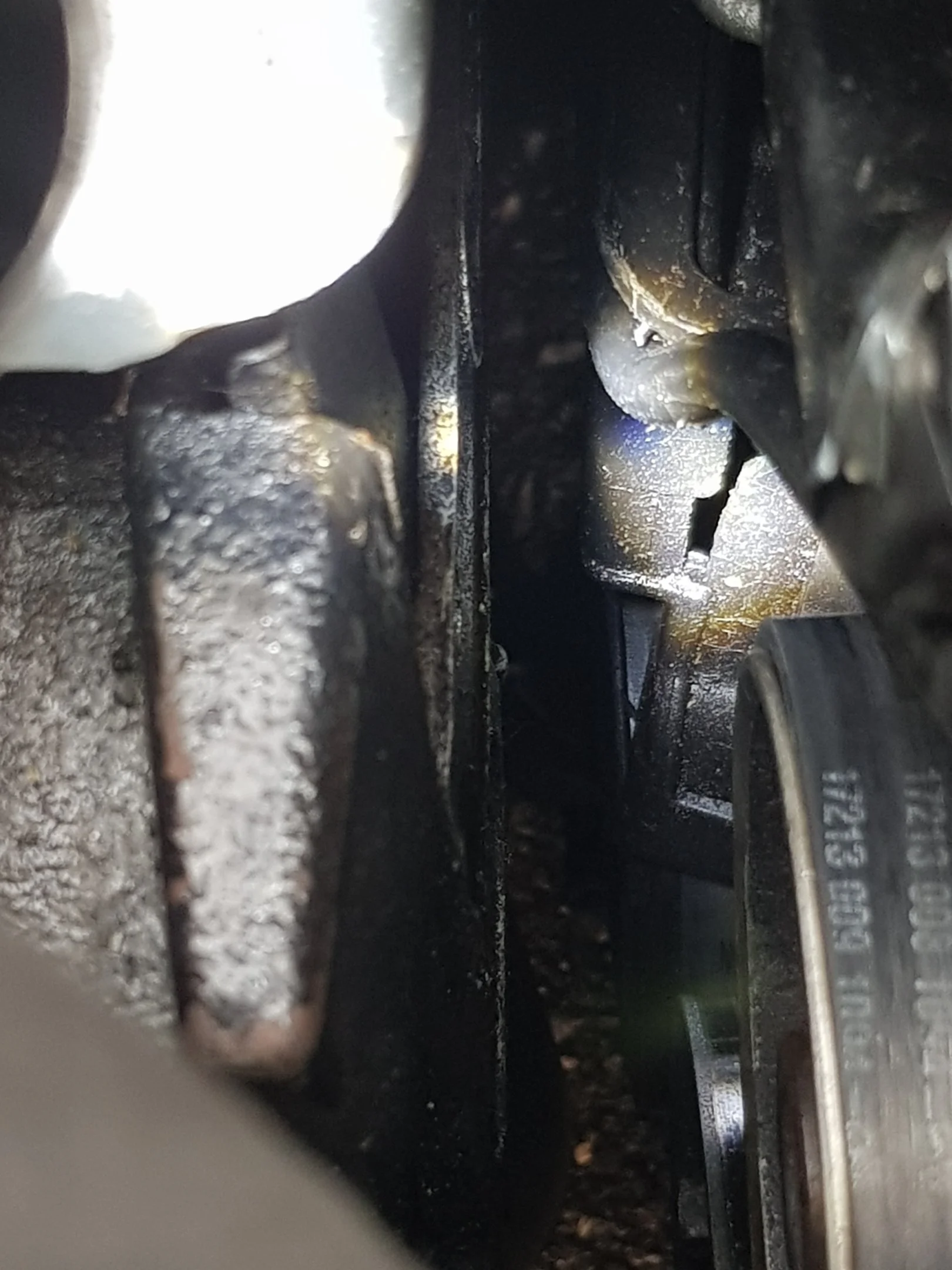

I had my cambelt and auxiliary belt changed by Renatec in Bristol a few weeks ago. I've had to go back several times to have various mistakes rectified, which is a pain as I live near Cardiff. I have now found out that they have refitted my auxiliary belt tensioner spring incorrectly using the wrong bolts and also broken my plastic cambelt cover and left it loose and unsecured. I even asked them at the time whether the aux tensioner needed changing and they said no, it's fine. Luckily I've since found out about a garage a couple of miles away from me who are very good with clios and he is going to sort it out for me, but obviously I will be out of pocket. I've emailed pictures to Renatec and requested a refund, but I'm not holding my breath for a quick resolution. Anyway, for anyone considering using Renatec in Bristol, go elsewhere.

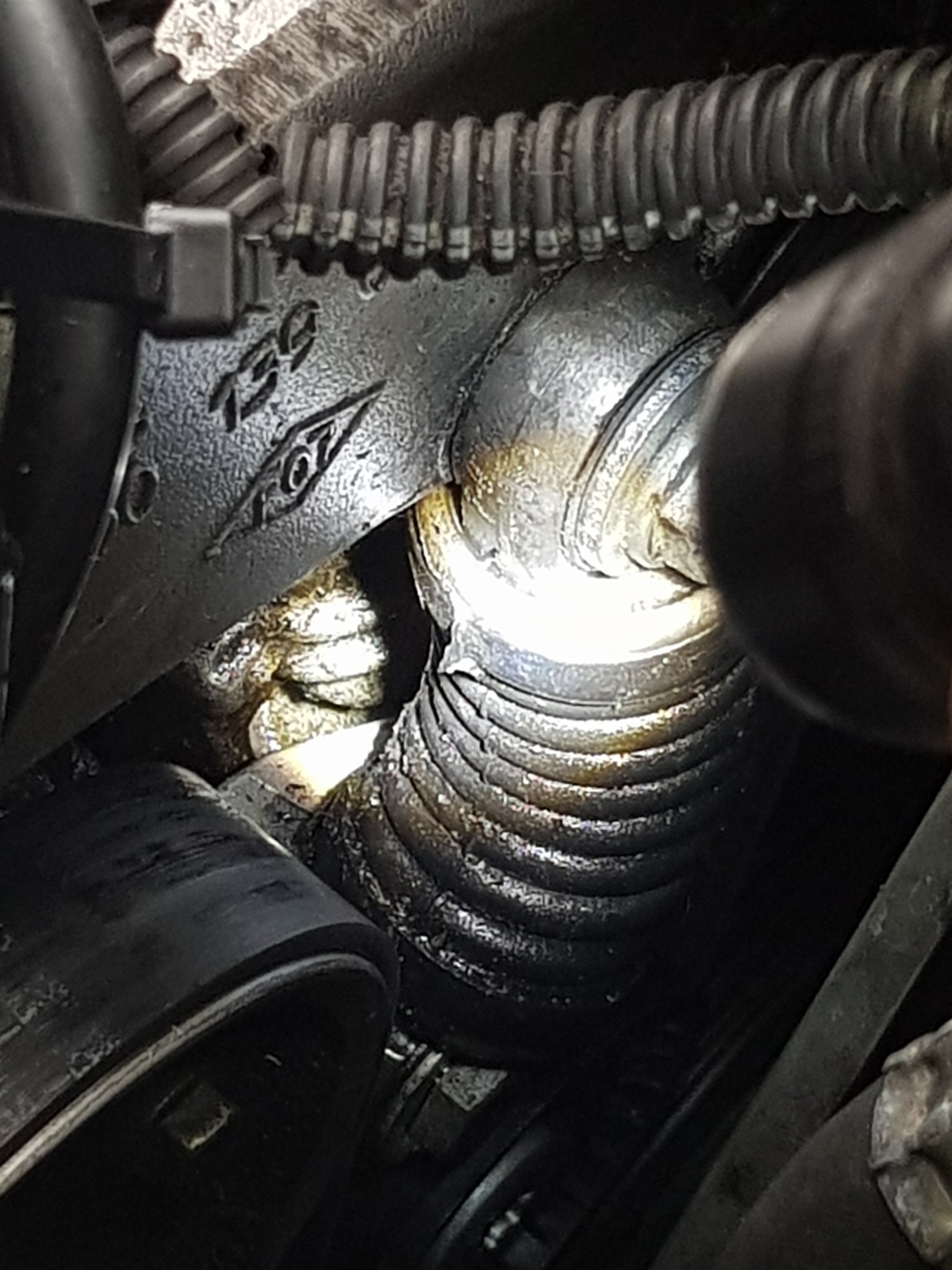

They seem to be trading off being a French car specialist, etc, and are even members of the which good garage scheme. What a laugh. I even had to go back there yesterday as when they did the belts they left the fuel line unclipped and it was sitting about 2mm above the auxiliary belt. Shocking. If I don't get some money back from them I'll be taking to small claims court if needed.

This is how they left the fuel line after doing the belts. If that line had moved a couple of mm then the aux belt would have chewed through it and I'd have had petrol leaking in the engine bay ?
  2003 Clio 172
Jesus Christ, that fuel line. That's criminal.
I agree. Could have ended very badly. I even took it back to have it re routed and clipped back onto cam cover and he didn't even mention that the cover was broken and loose. Completely incompetent.

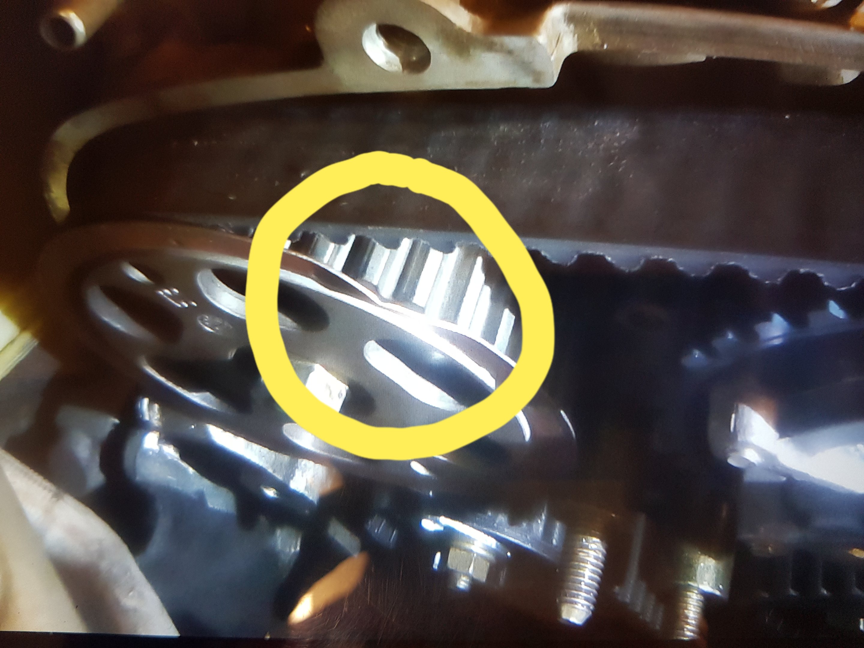

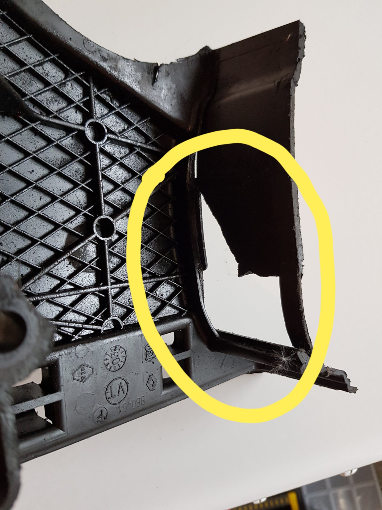

So after more or less being called a lier by Renatec and really having to grit my teeth, I am now pursuing them initially through the Which trusted trader scheme (which laughably they are a member of), and then potentially through the small claims court if I get no joy. Here's some more snaps of their handwork for anybody still foolish enough to consider using them.
Broken lower cambelt cover:
Damaged exhaust cam (looks like it's been damaged by a screwdriver when they were trying to get the cambelt on):
I would say pictures speak a thousand words...
  2003 Clio 172
Cam pulley is from the locking tool possibly?
