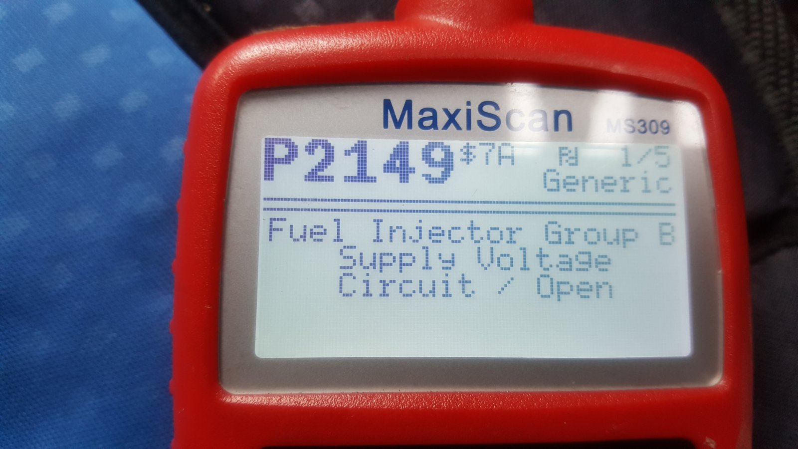

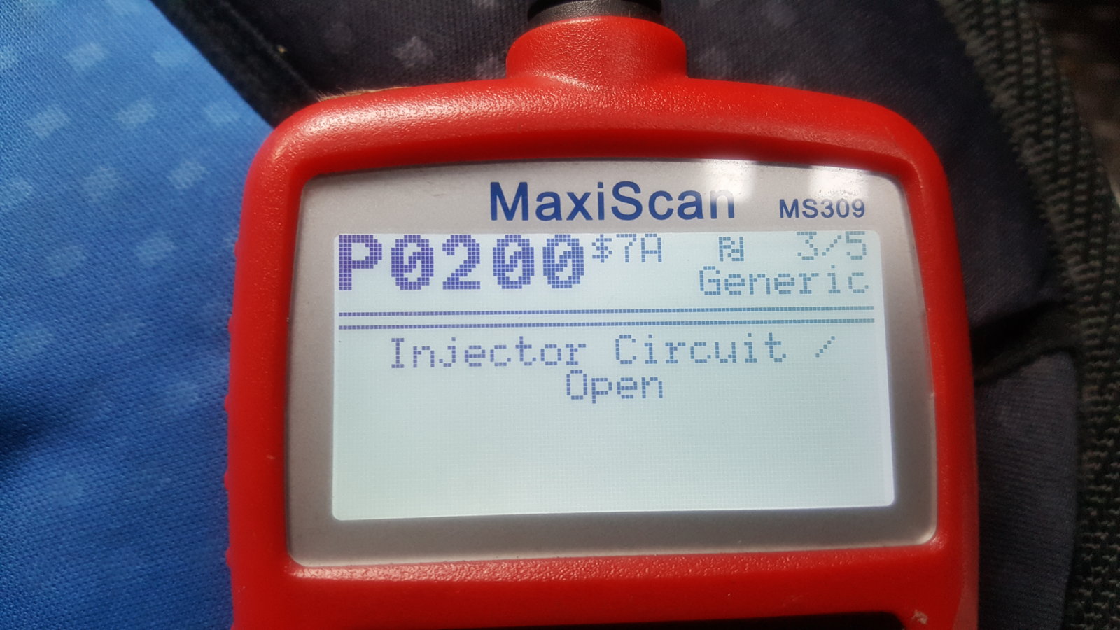

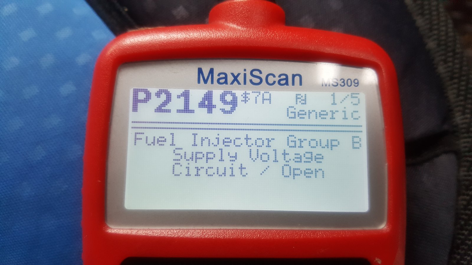

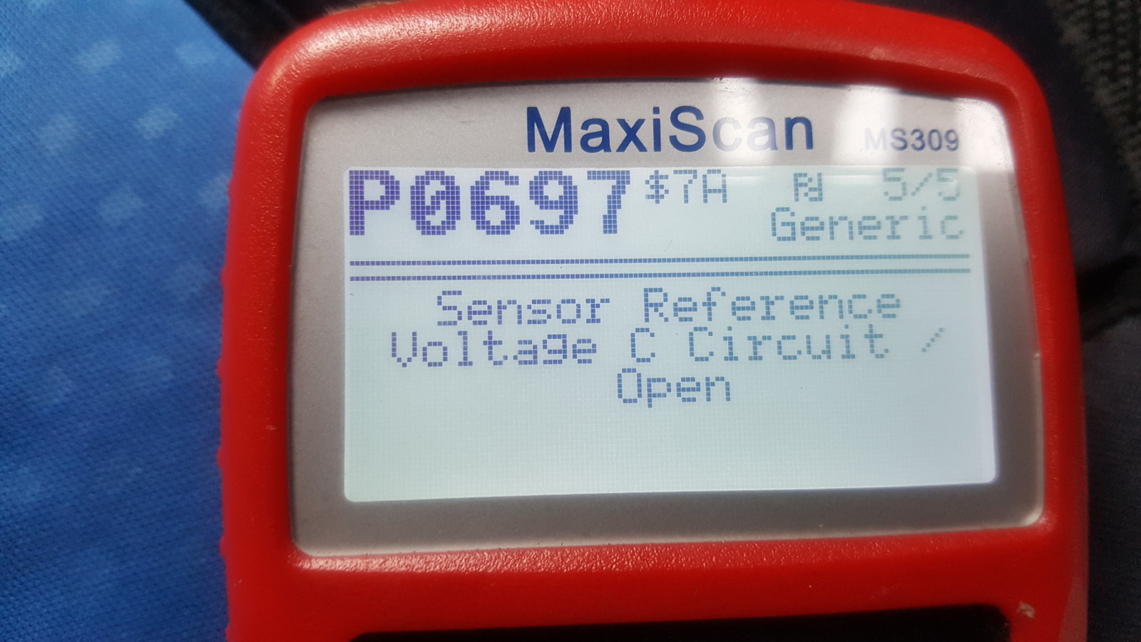

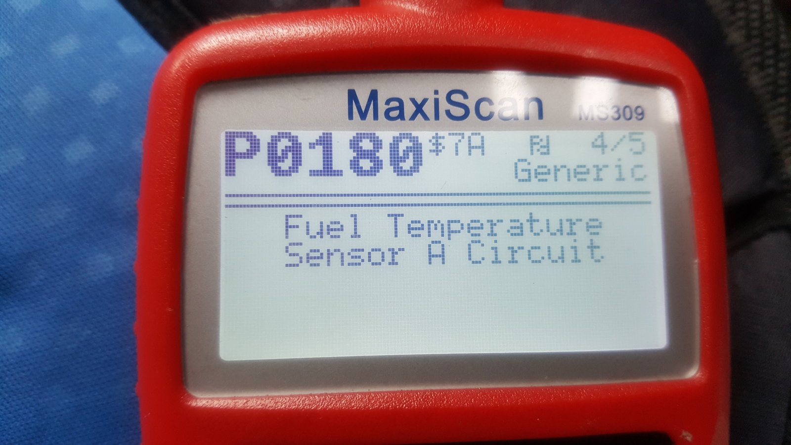

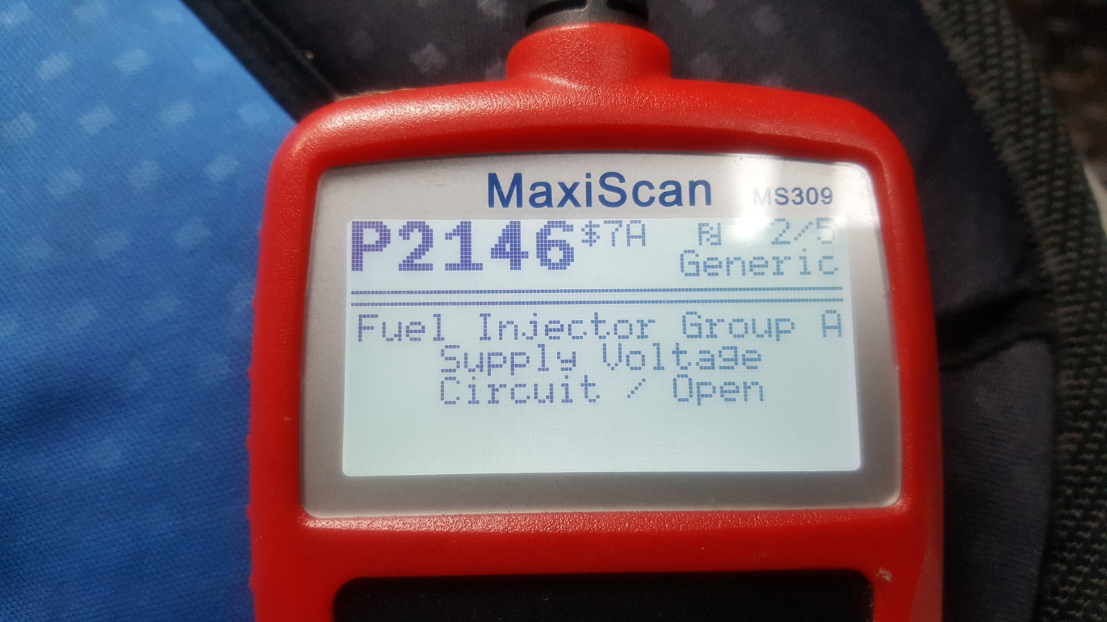

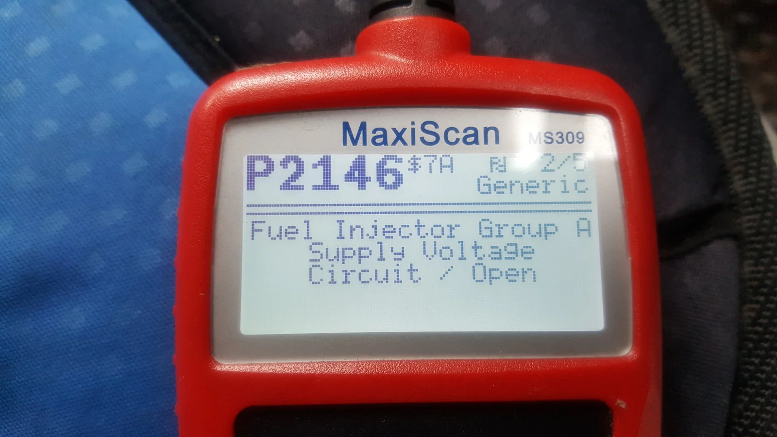

I have Renault Trafic 2.0 diesel 58 RG parked for 1 month and battery flat. I removed the batteries and putting new battery but van want start if anyone knows helps me, please
Hi It's new battery turn over but want start
And engine red flash also have follow code show

Hi everyone I do ALL above but still not starts, I bring mechanics diagnostic and find voltage circuit c prominently off not give the power to start.
he says well come back to u on Sunday with the special machine to find a wire,s where is cut I
well forward if fix on Sunday.

God news I removed plug injector connectors
Number 4 and spray easy starters
Now my trafic work and after 1 and half hours
Start without easy start
But when I put back injector plugin it's straight away cutting aut. but if plugs disconnect
It's start and drive but limp mod
I don't know really exactly what is wrong with van
My English not good sorry
If any one know the problem let me thanks
