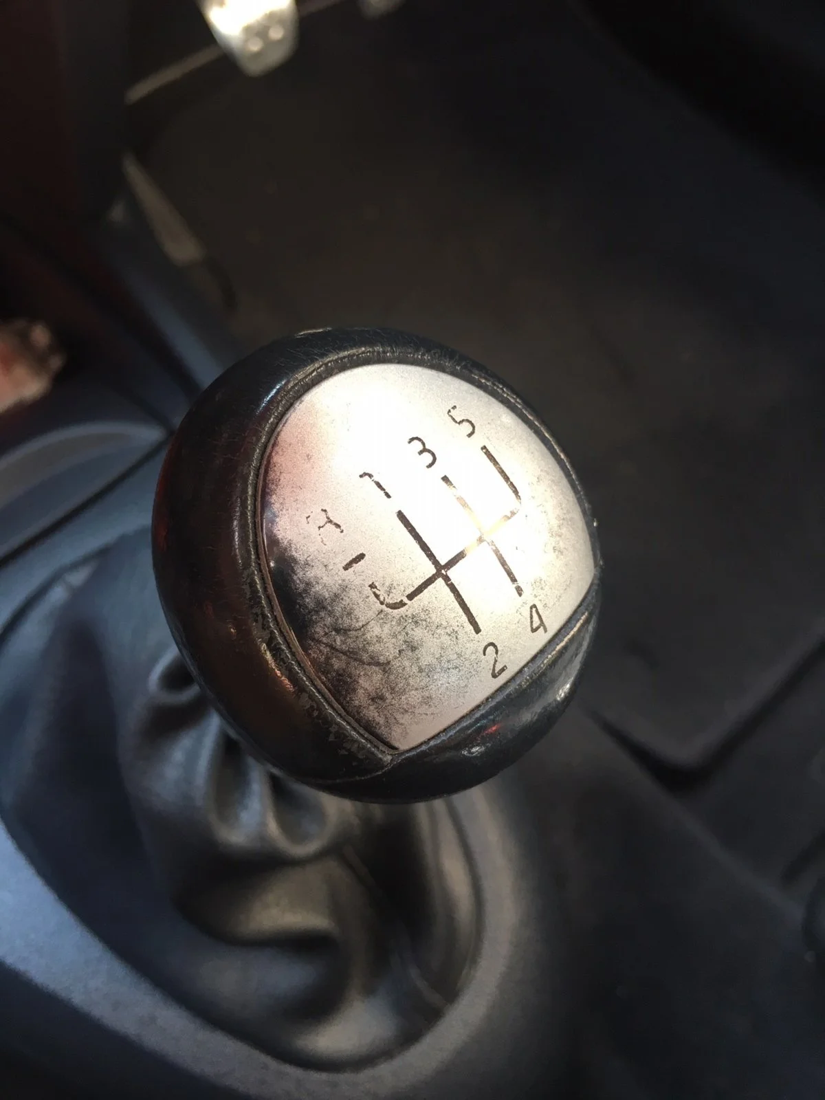

After buying back my old 182, the gearknob had lived a good life but looking less than its best after 114k miles of fun.

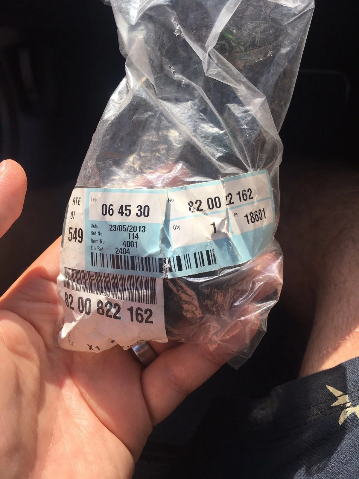

- Small terminal screwdriver - pick

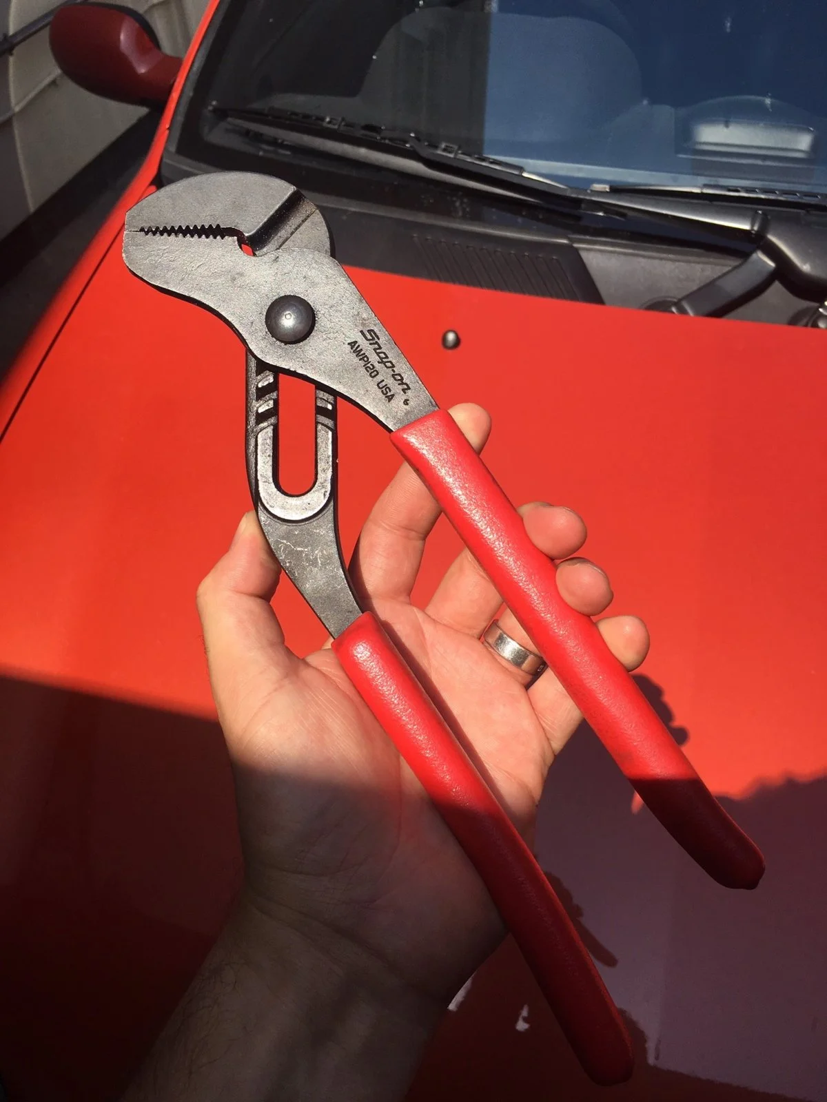

- Large Stillsons/Water pump pliers

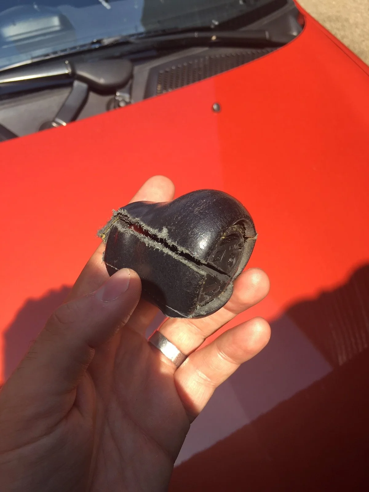

One worn gearknob due to many happy miles in my 182

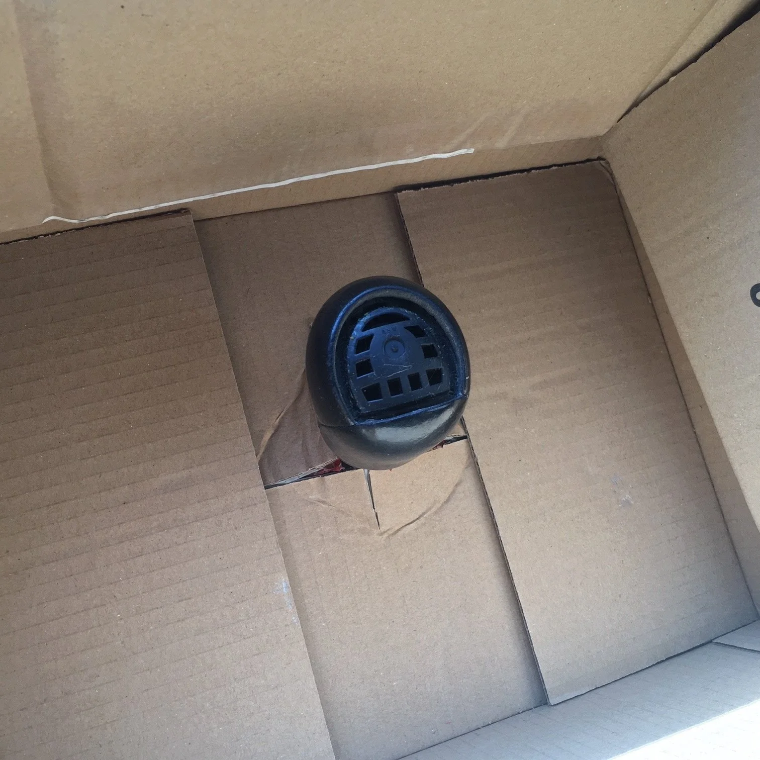

Use a small screwdriver/pick at the corner of the insert to prise out the silver plastic insert. This will pop right out without much effort.

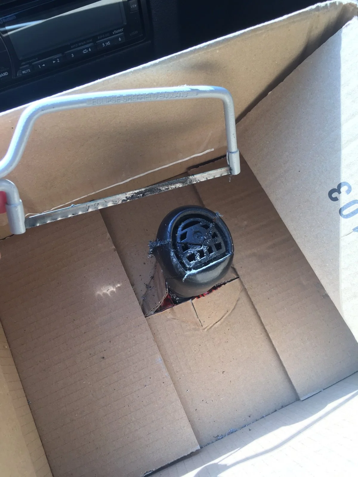

Cut a small cross in the centre of your cardboard box and place it over the gear knob, this will catch most of the debris you will create cutting off the old item
Take a Junior hacksaw and cut a cross in the top of the knob. Hinge the hacksaw cutting action so that the cut goes right down to the base where the "lift up reverse" collar is.
Be careful not to cut the collar and make sure you stop when you feel the blade hit the actual selector steel shaft.

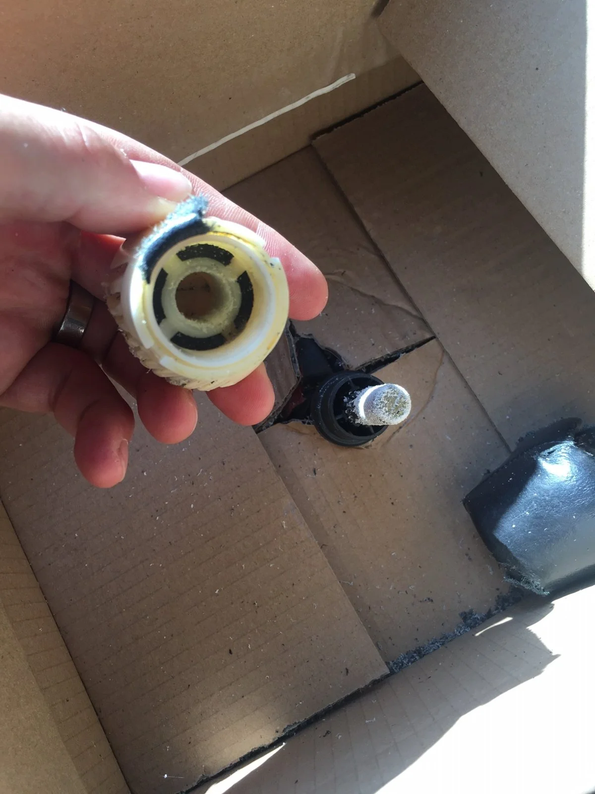

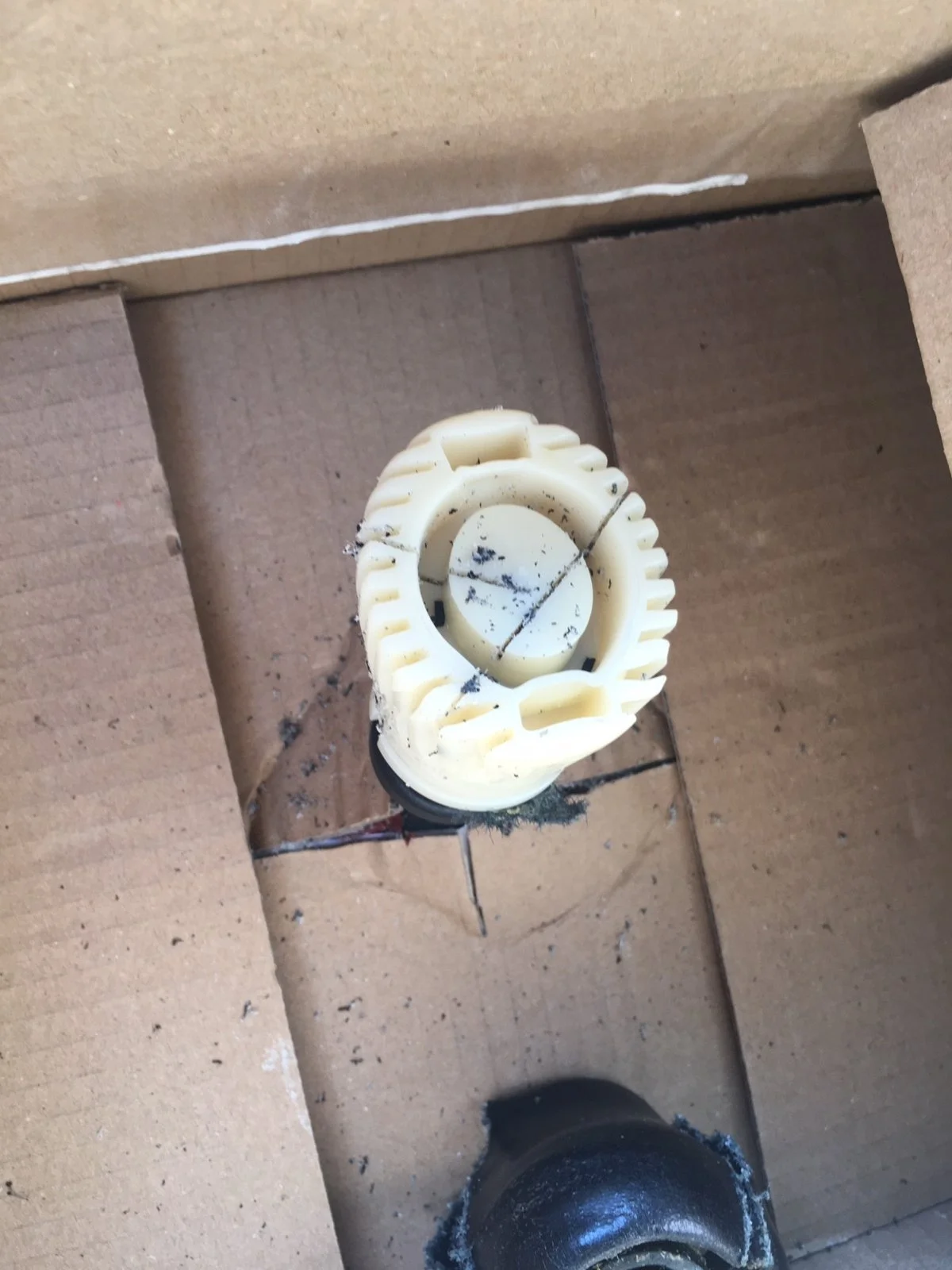

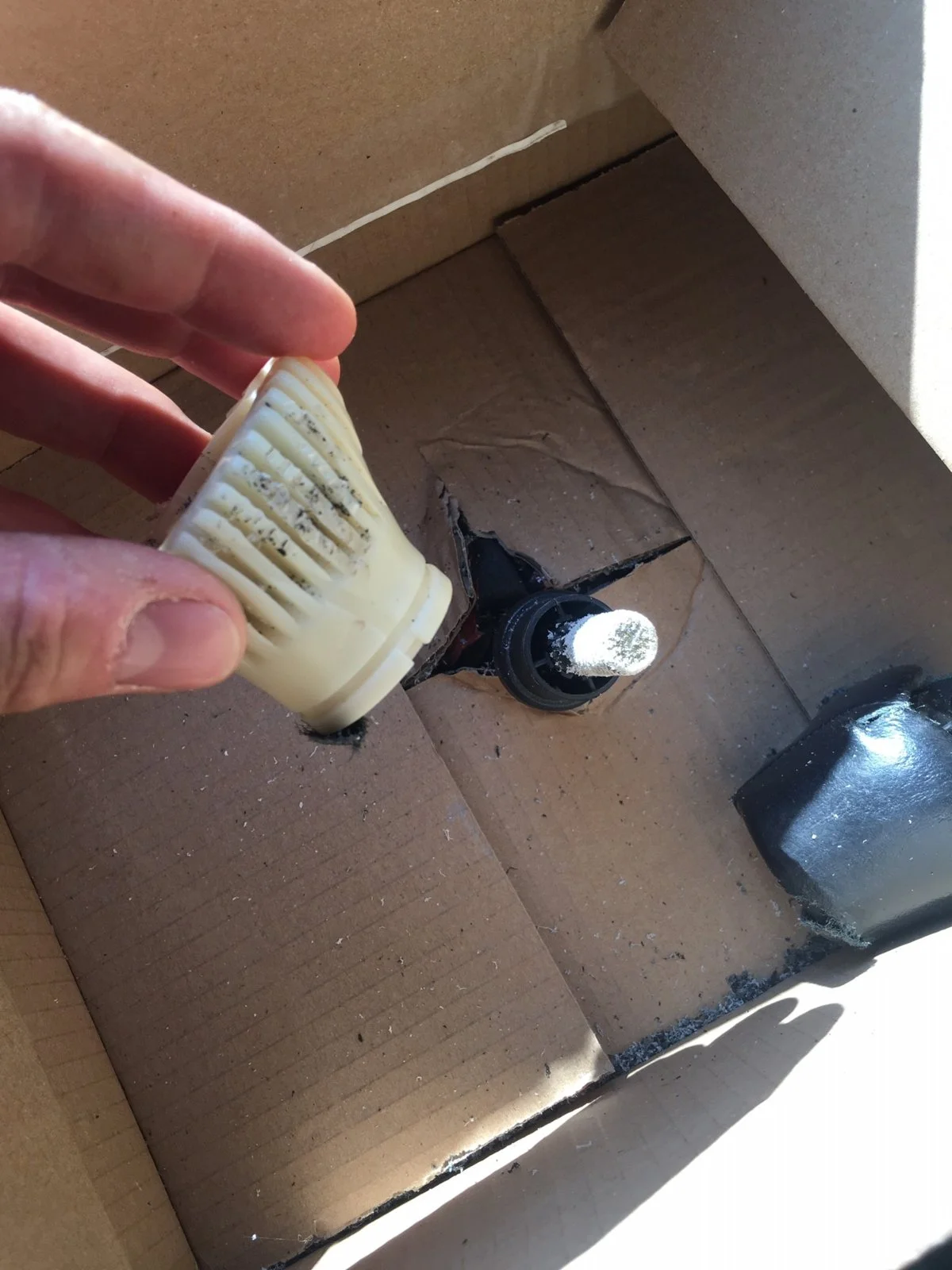

Now you can peel off the old leather/rubber covering revealing the white nylon core attached to the shaft.
Next you will need a large pair of Stillsons or water pump /adjustable pliers
With the core cut through as much as you can, use the pliers to twist the core and crack the glue that's holding it on. Once the glue cracks you can keep twisting back and forth and after not too much effort the old core will come right off.
Take your new knob - Renault part number 8200822162

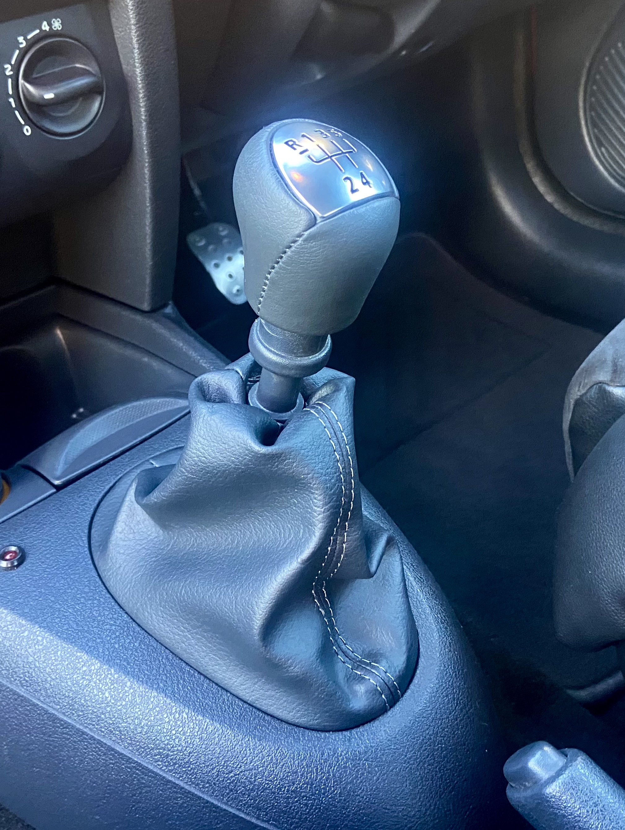

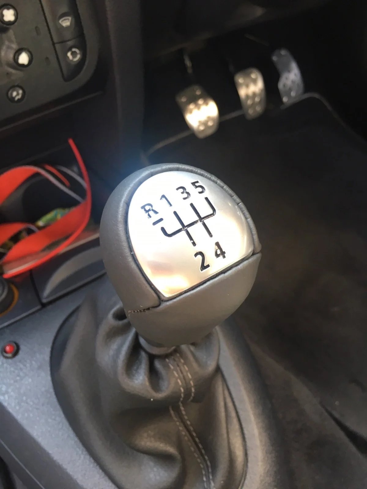

Make sure the new knob is aligned before allowing the resin to cure.
Ta da!!
