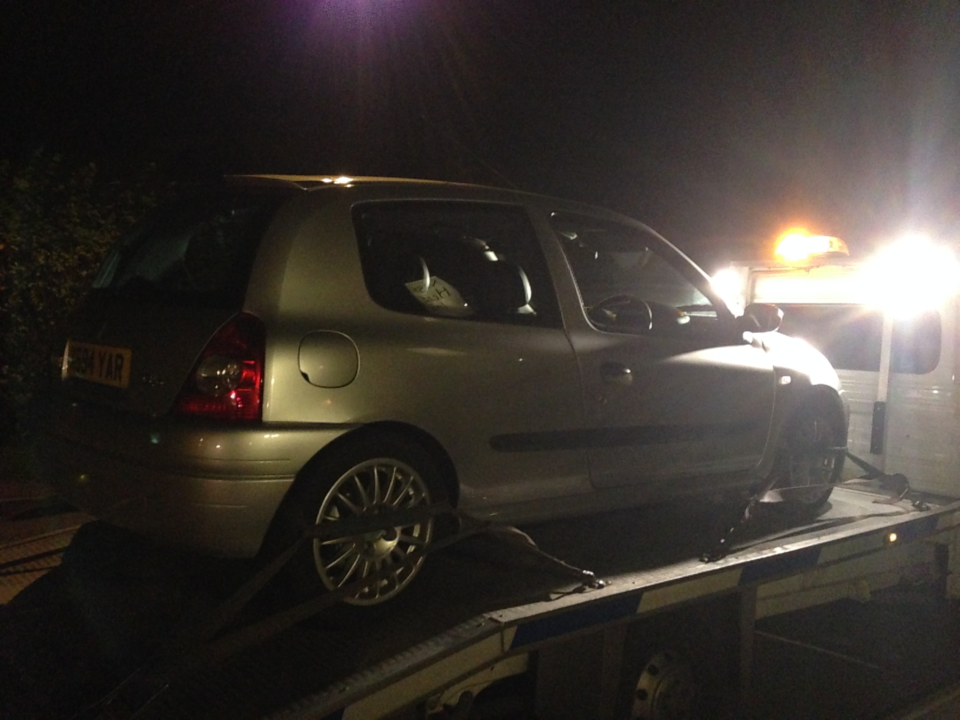

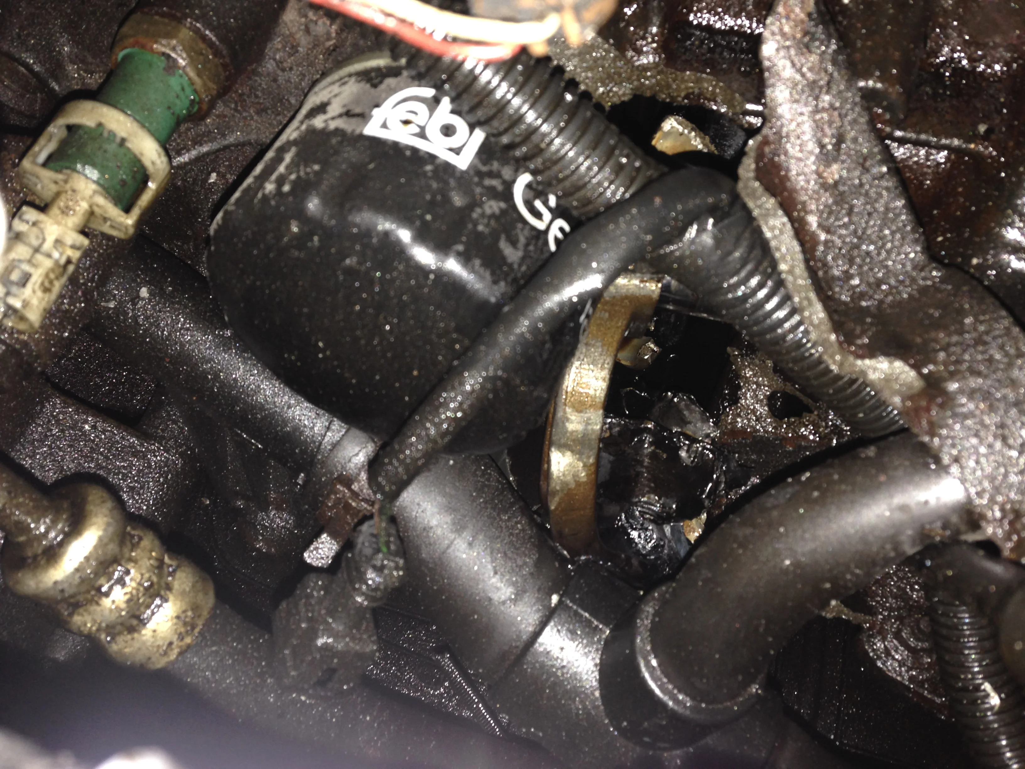

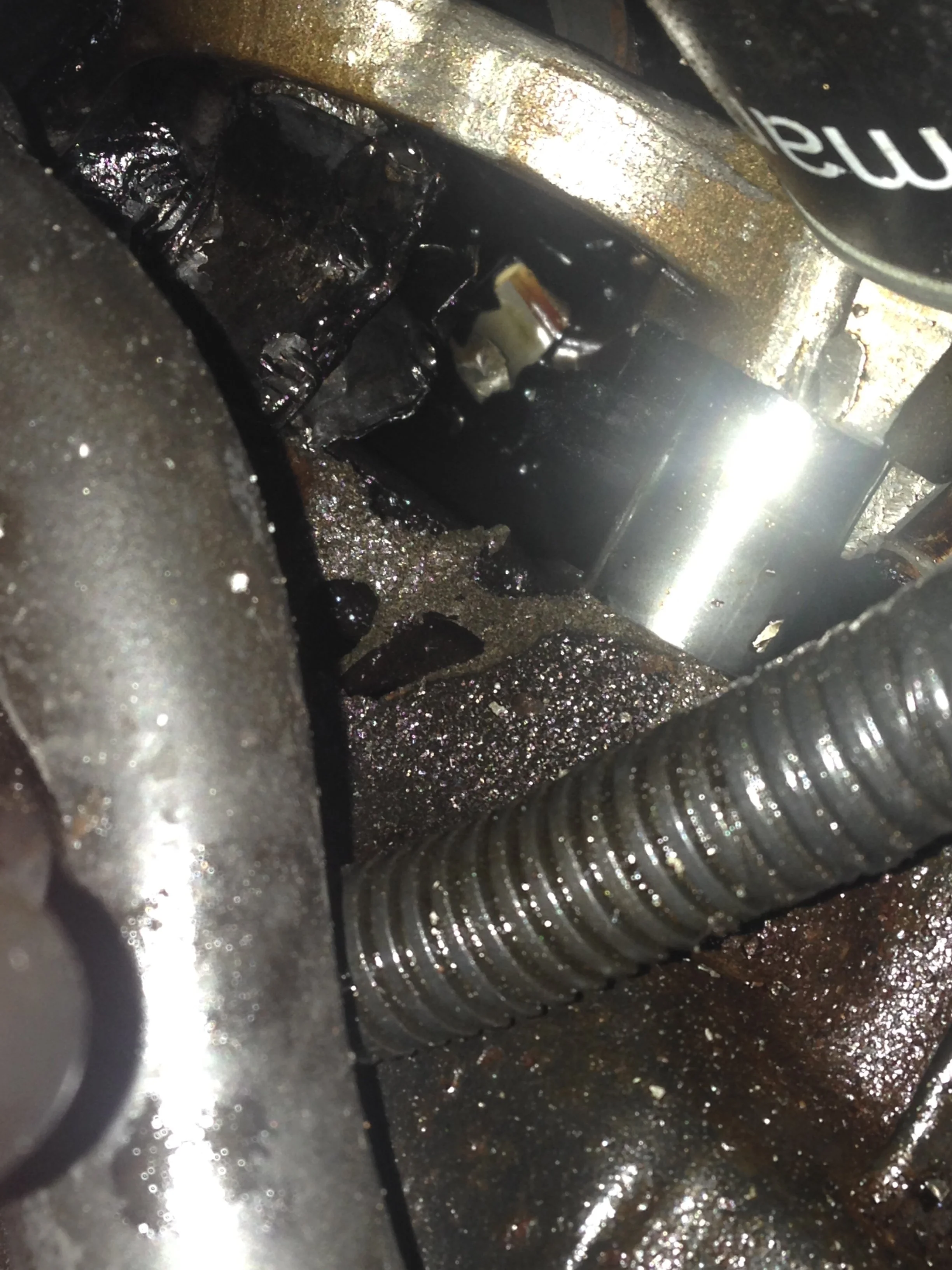

Well after just 4 laps of Donnington on friday this is how my ph1 ended up

It went without any warning at all which is anoying scince ive spent a small furtune on freshening things up and the milage is only on 96k
Question is do I source another engine for it or break it and buy another 172/cup etc....

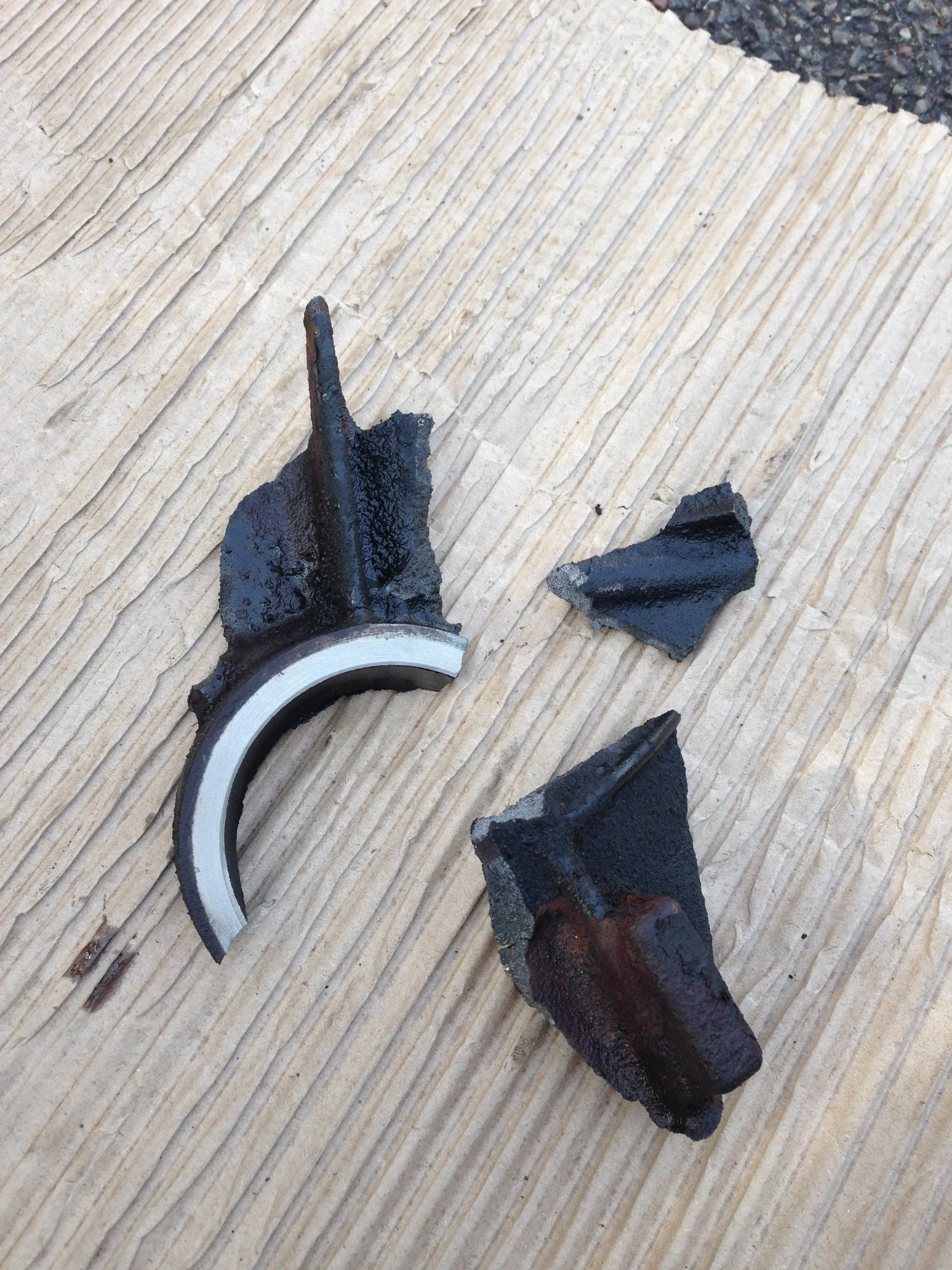

I think it just blew a rod. If you look a few pages after we take apart the sump and it had shattered a lot of the engine out! Definitely get some ARP rod bolts to prevent it happening again.
