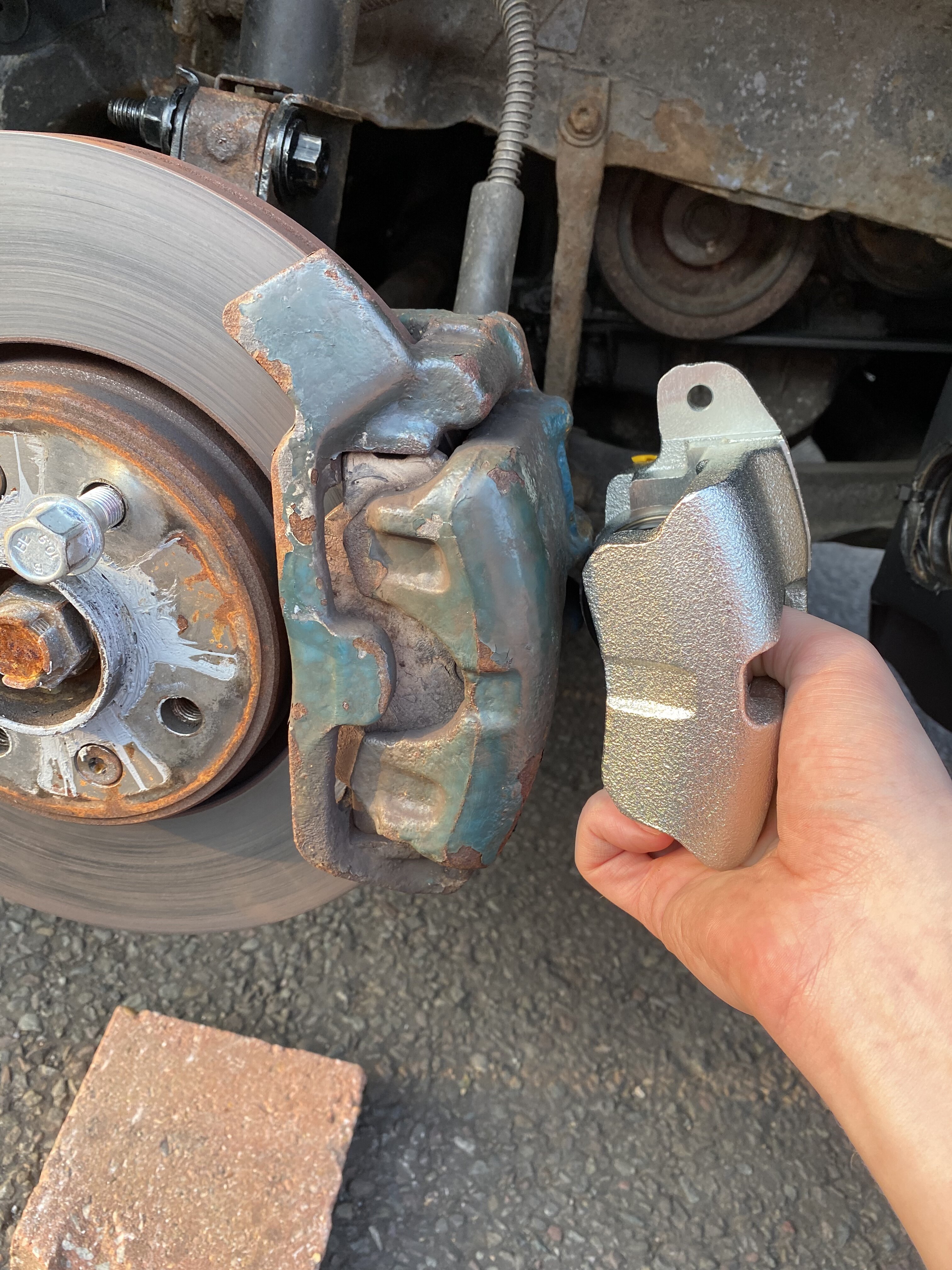

Where is the best place to buy them for the 172 cup? I got this delivered today but it’s completely the wrong size.
Are they any different from a regular 172/182? I've previously bought reconditioned Pagid units from eurocarparts.
