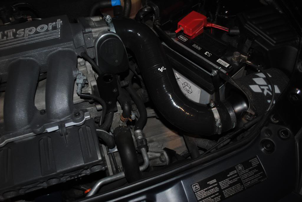

Nope its ktec new gen induction kit, I think it could be the cat to manifold join but It sounds more mechanical than just a whistle, maybe I'll get a video if its loud enough.
I've driven the car a bit more and im fairly sure its the gearbox giving a very faint whine, it didnt do this before I changed the oil I'm sure. Is 75w90 thinner or thicker than 80?
Im also unsure if having taken the OEM airbox out to fit the ktec induction has left a big wind hole and that could be the noise.

The removal of the airbox for the induction does leave quite a big gap and anything could be hitting wind and making funny noises. Might have to install the airbox for a day and see if its just wind noise.

I think where the airbox was it covered a lot of open metal parts etc, and now its gone air is possibly making a noise hitting something. But at the same time a few of the noises do sound a bit like gearbox noise although I think its a mixture of air noise and also the fact the airbox covered over the gearbox so now I have both the odd gear noise and wind noise, and as you can see there's quite a bit of space now for air to hit.
I'll have to put the air box in and go for a drive to see if its any different, has anyone else fitted the ktec induction kit and heard any wind noise?

I get whine / wind noise from my k-tec induction kit. And I know its not the gearbox, as I had a new one with LSD fitted at the same time k-tec gave me the induction kit to trial on mine.
You can use a bit of common sense really. A gearbox whine will be predictable, will change in relation to revs, higher revs higher pitched. Induction whislte just pulse the throttle a few times to change the noise massivley. It shouldnt take any sort of rocket science to distinguish the two.

And I agree with all of you, I've been for a drive, without the airbox on top of the gearbox I can definitely hear more gear change noise, but I think its nothing to worry about now I've done a few tests changing gear and going down hill like i said above it and its a wind noise. The lower arch liner passenger side is missing, so first of all I'm going to replace that. So that should make a decent difference in the massive amount of air that rushes up there. There will still be plenty of air for the induction just not so much is whining.
