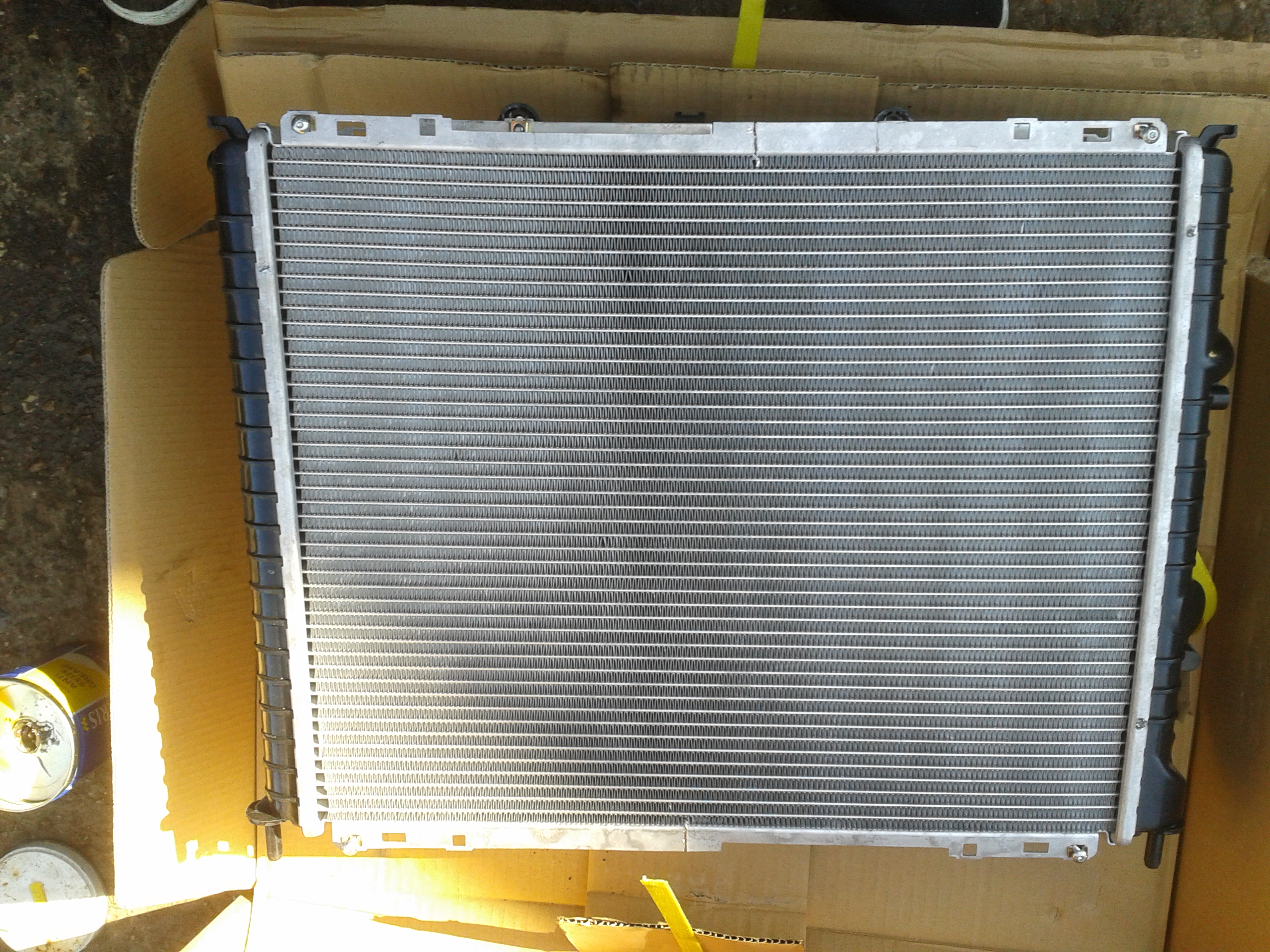

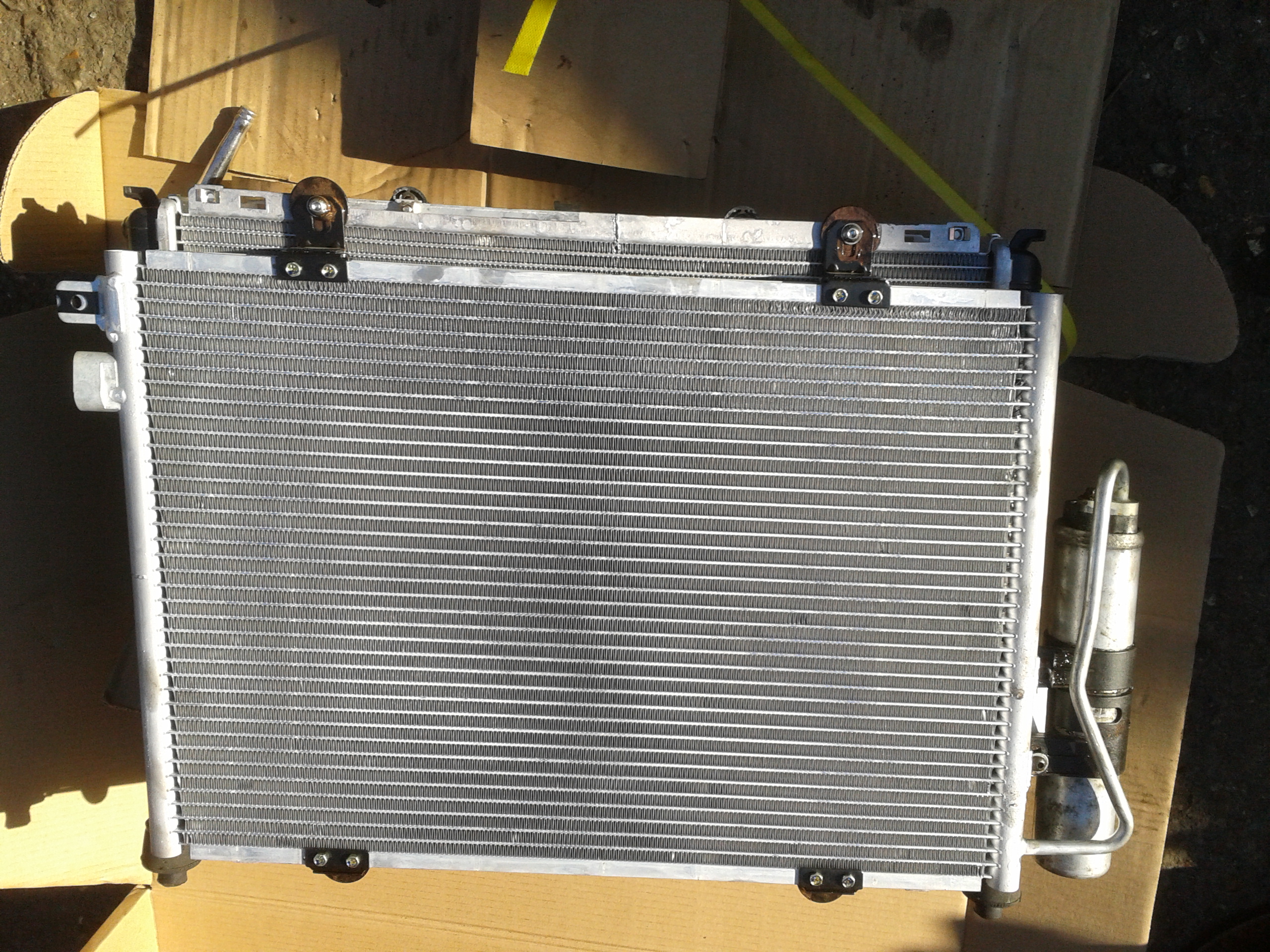

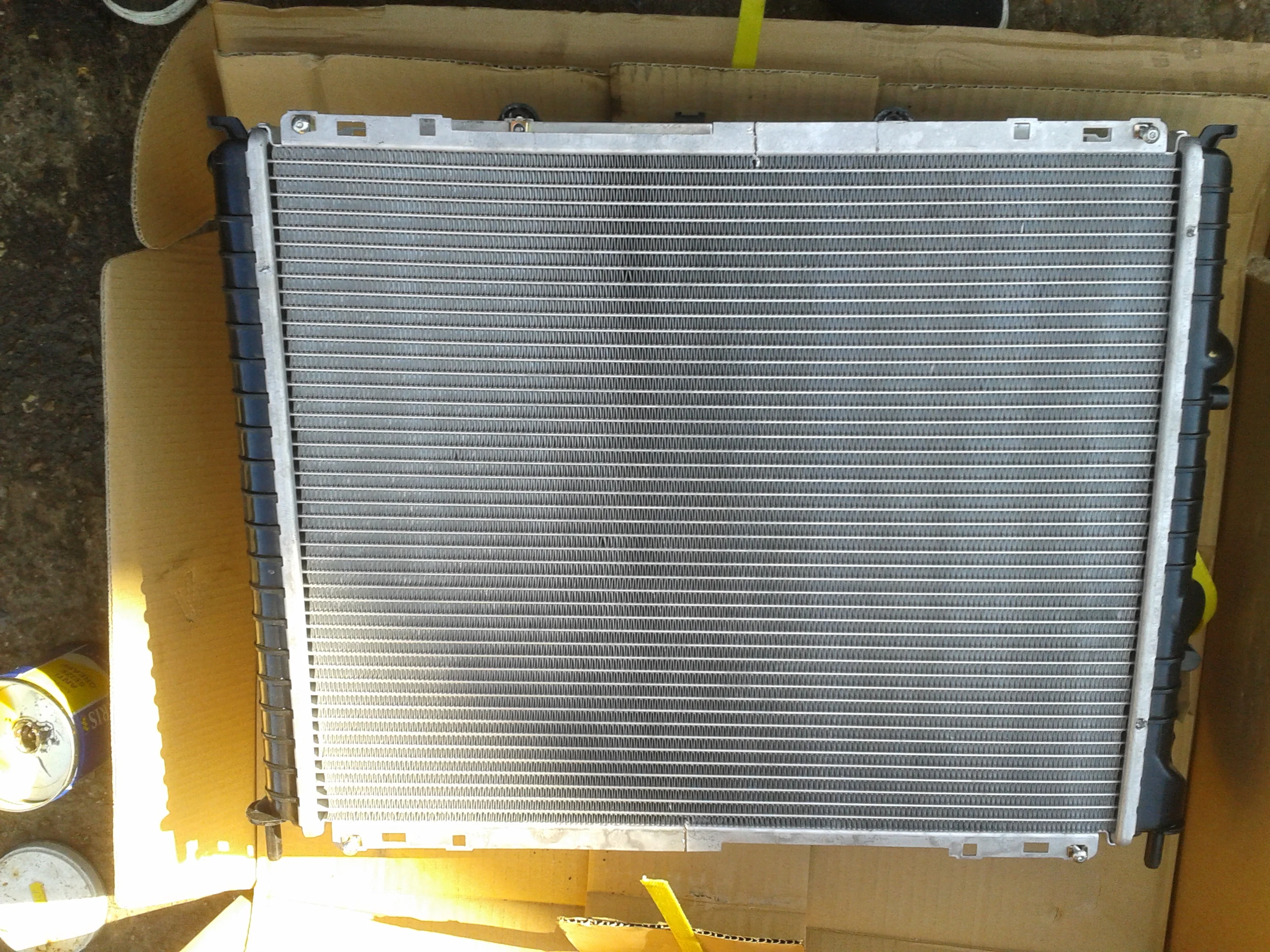

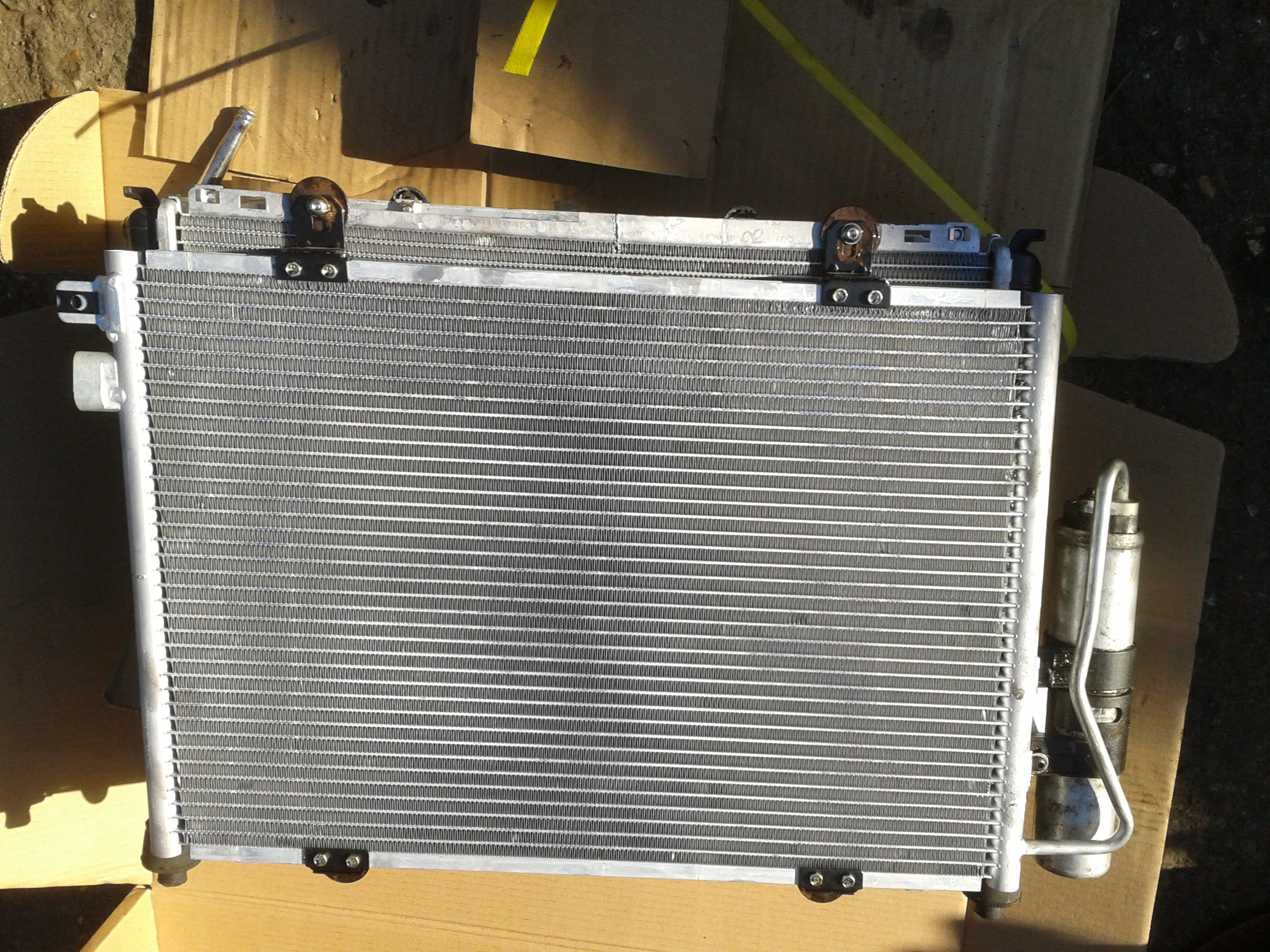

I fitted a Nissen rad ( & condenser ) purchased from my local Andrew Page outlet 1st October and had no problems other than the captive nuts on the rad where positioned incorrectly in respect of the condenser,not a great problem,as the correct mounting points were present.
AP Part no`s are 94279 for rad,& 63768 for condenser.
I`ve had no problems with either unit,despite being caught in some motorway jams,where the pressure does build up.
Not cheap as chips at £72 a piece i/c vat,but good quality IMO

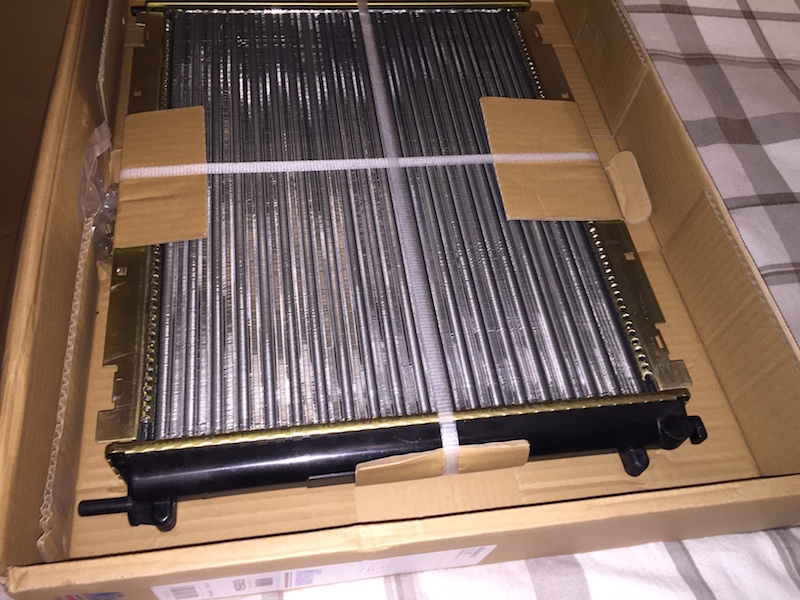

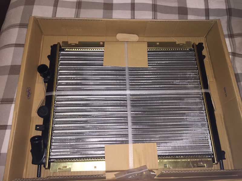

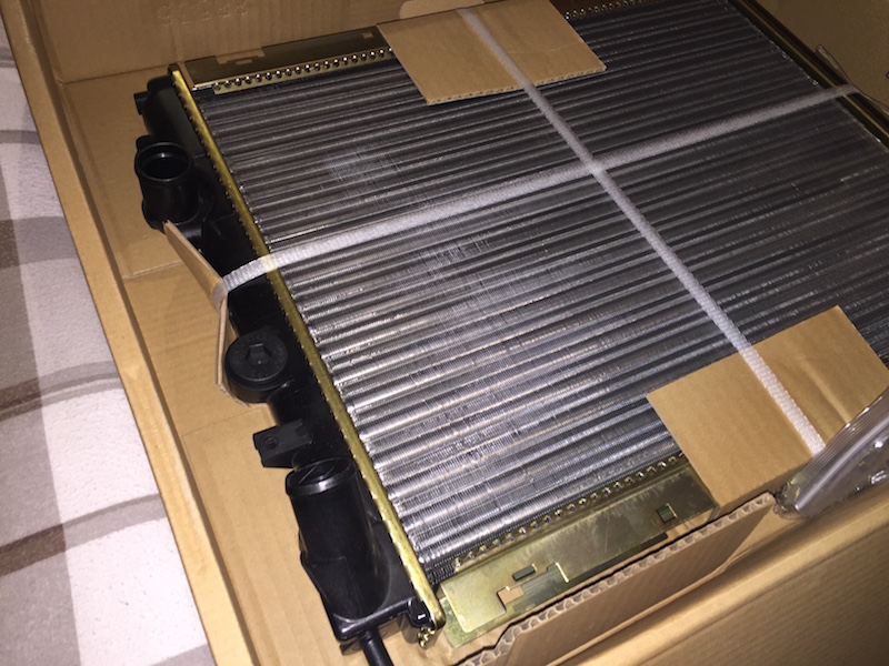

If it were me I'd either go genuine or for a Nissens radiator :).

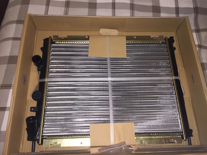

There are a couple of track day orientated all aluminium 55mm deep rads about for around £170.
Available on Amazon or from Direnza.
Fitted 2 of these and also sold a couple of them also and they are perfect.
