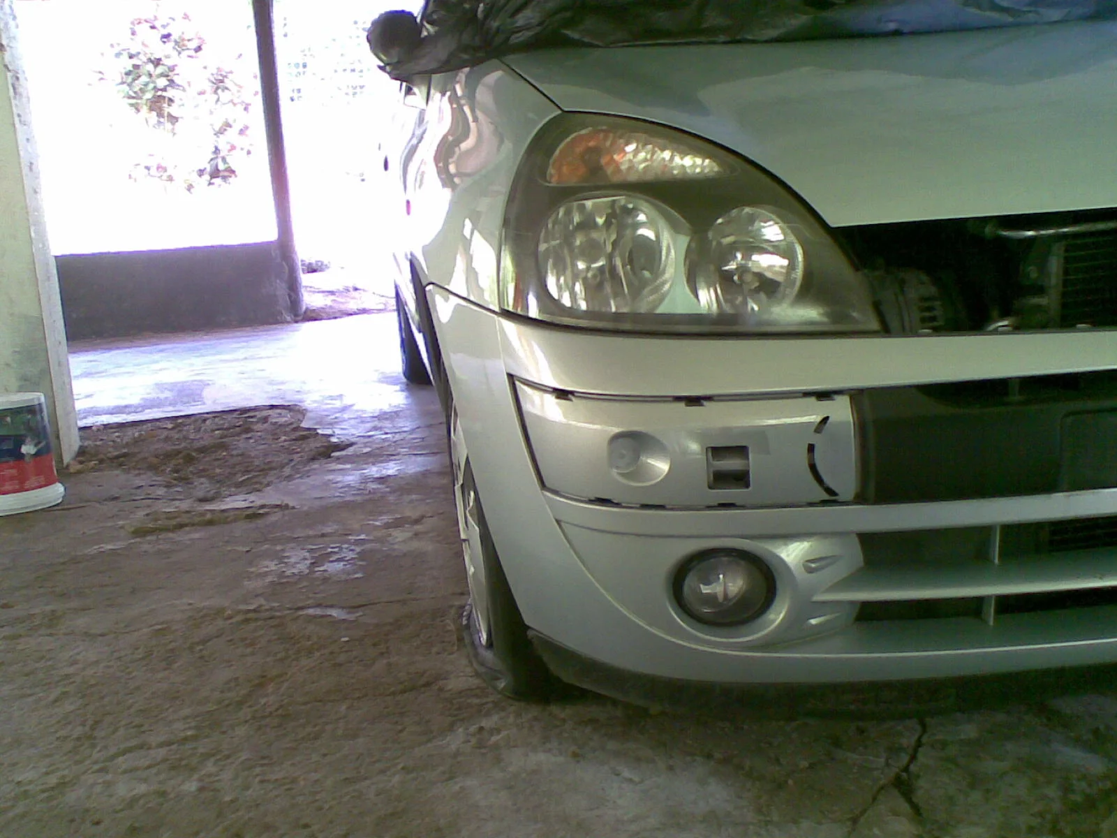

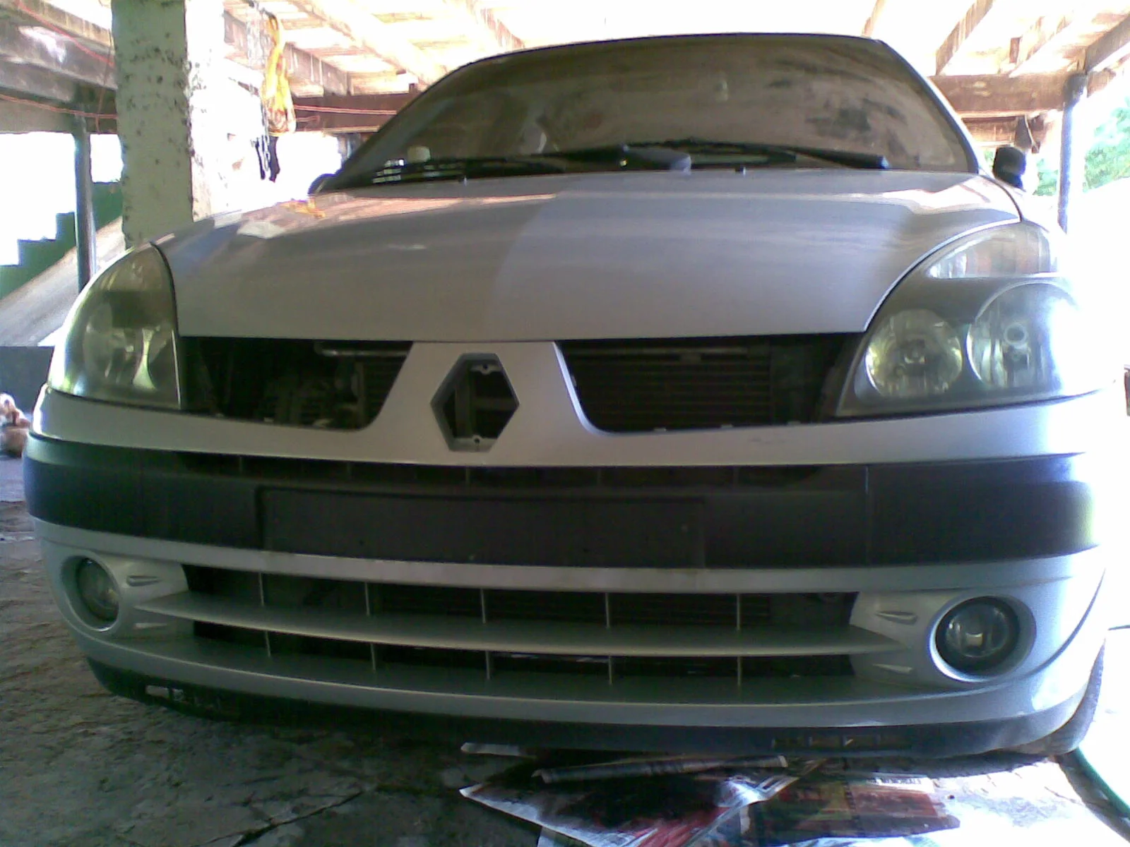

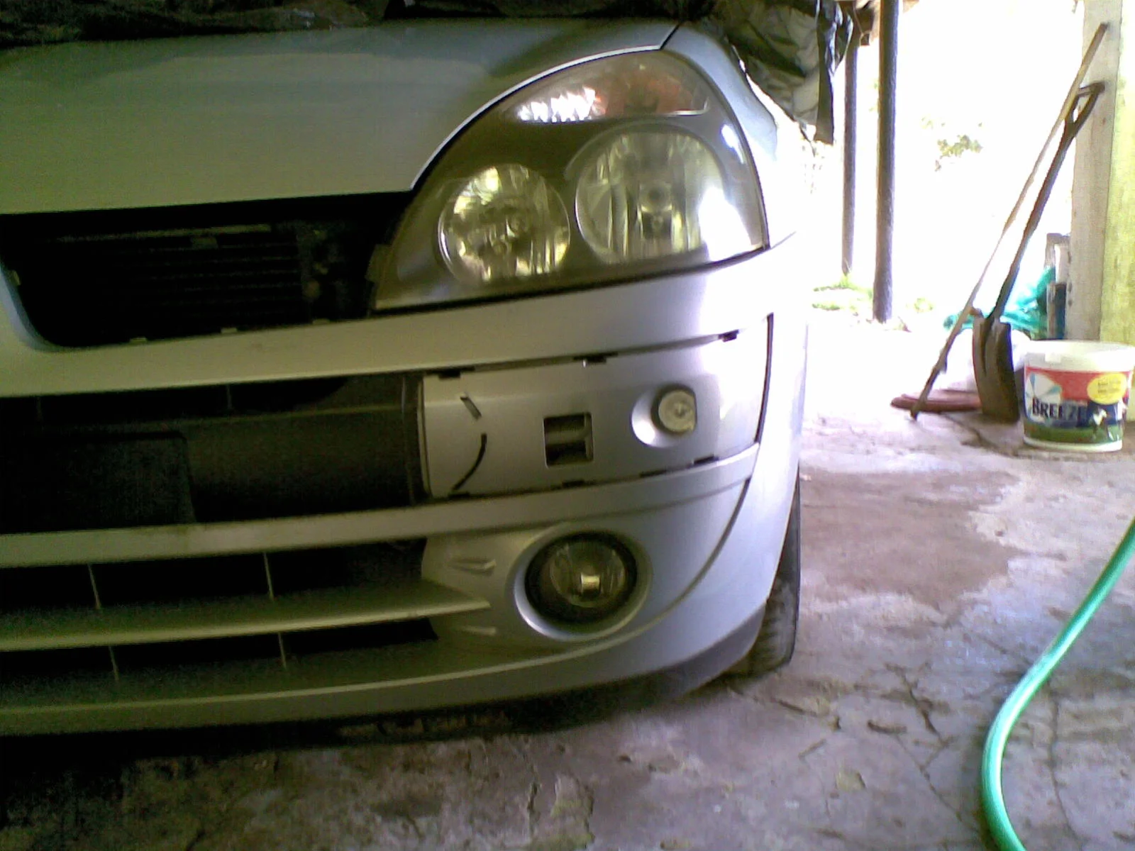

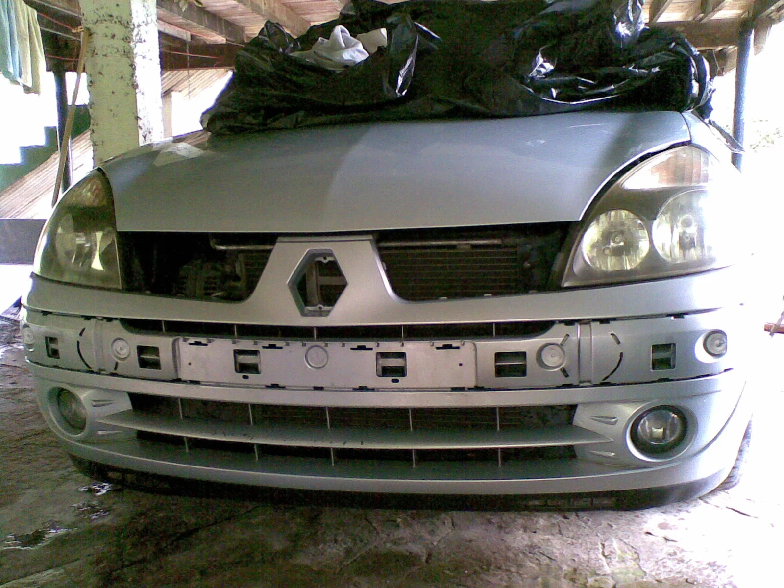

I have taken off the front just last weekend. If you have a bumper like this, it consists of three pieces. What I did was removed the grill and threw some soap water in the areas where I suspect would have the clips. Then slowly start on either side.
They are hard to get off you just have to be careful. And to get them back on you have to give them a good old wack to fit them back on.
I took off the grill because I got a new 172 grill to put on.
Once you take off on either side, right or left, the other side you just have to follow as to where it goes into. I used soap water to somewhat give it some lubrication. Any dirt buildup in the spaces would give you some headaches to take out.
