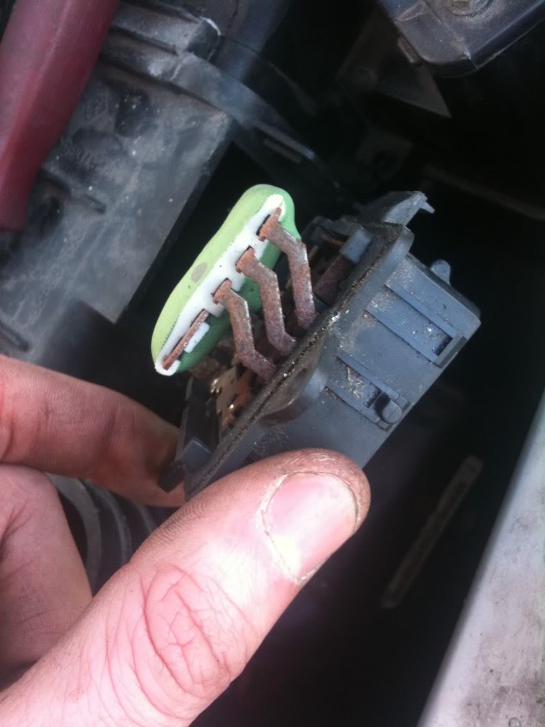

Is it the same for a clio 1.2 16v fan? because thats what i have in mine, and it seems like a totally different thing, heres a pic:
If its got normal heating then you'll have a resistor pack because you've only got 4 fan speeds, as the climate control has 8 its uses pwm and a different thing entirely.
