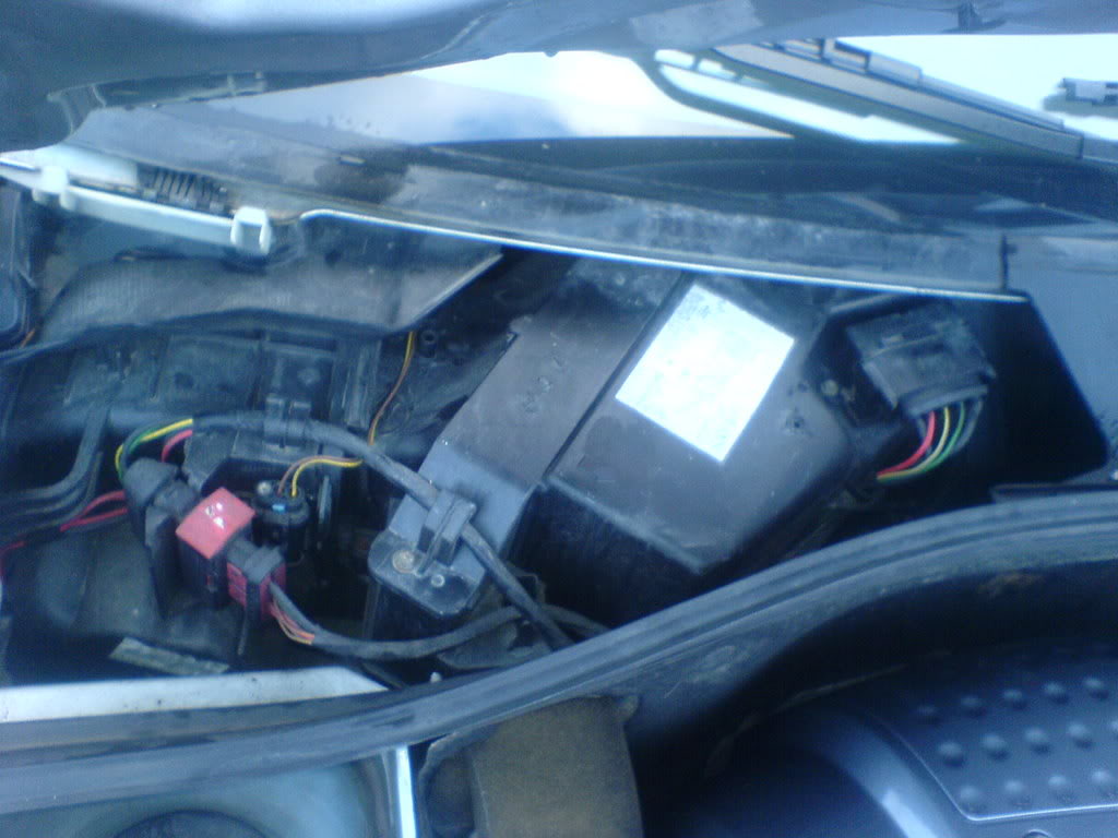

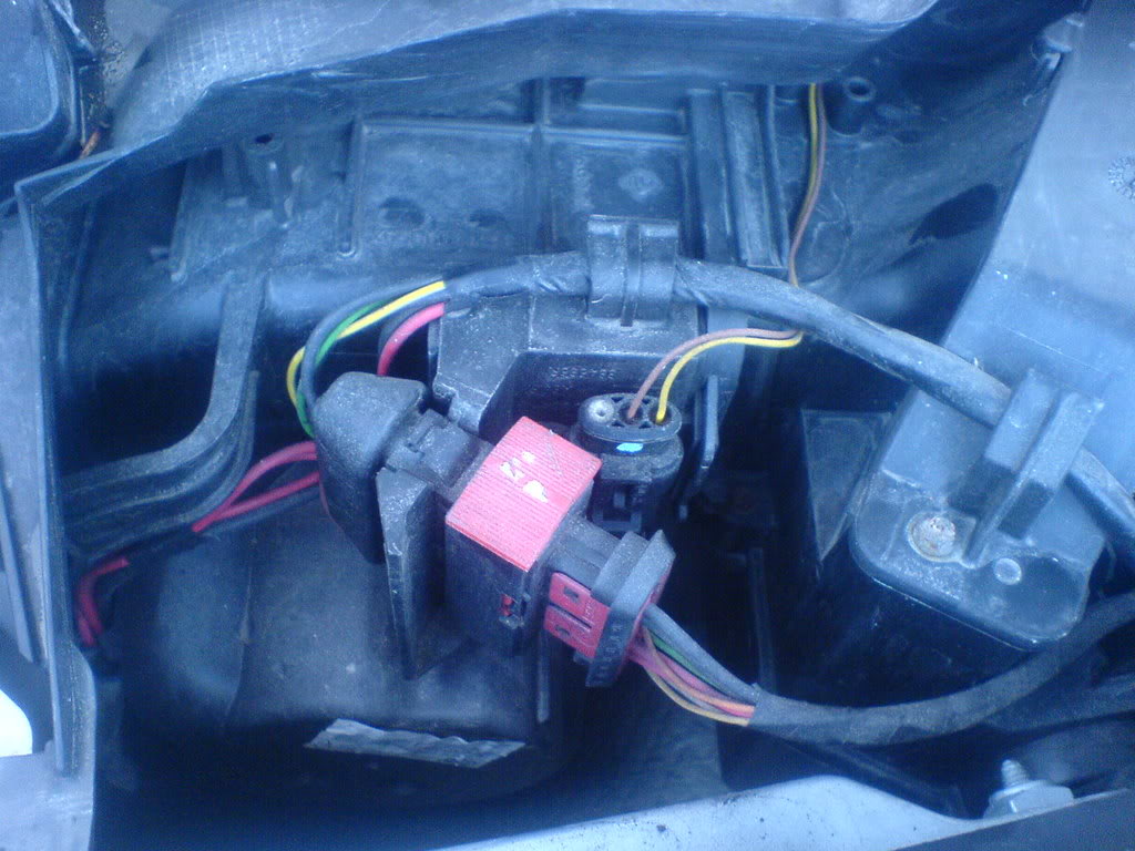

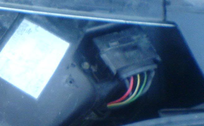

I cant seem to find the resistor pack
Where is it located on my pics?

Its the bit at the back of the first picture with the red yellow green wires.
I am sure it is the cause. EDDOO seems to have solved his by repairing/replacing his.
