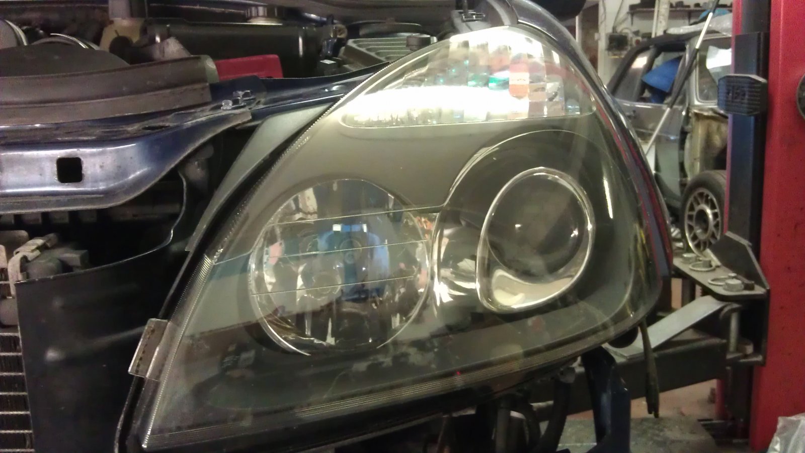

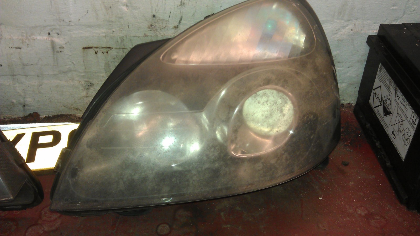

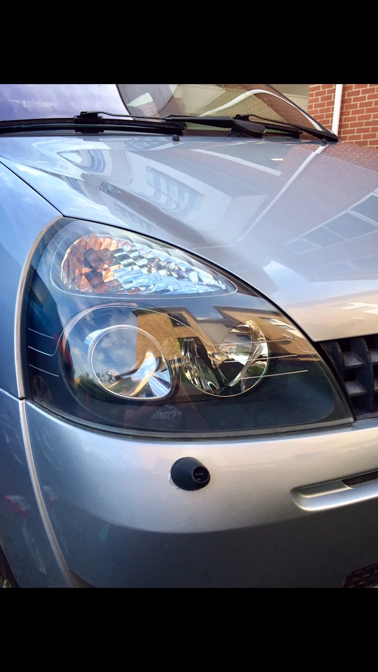

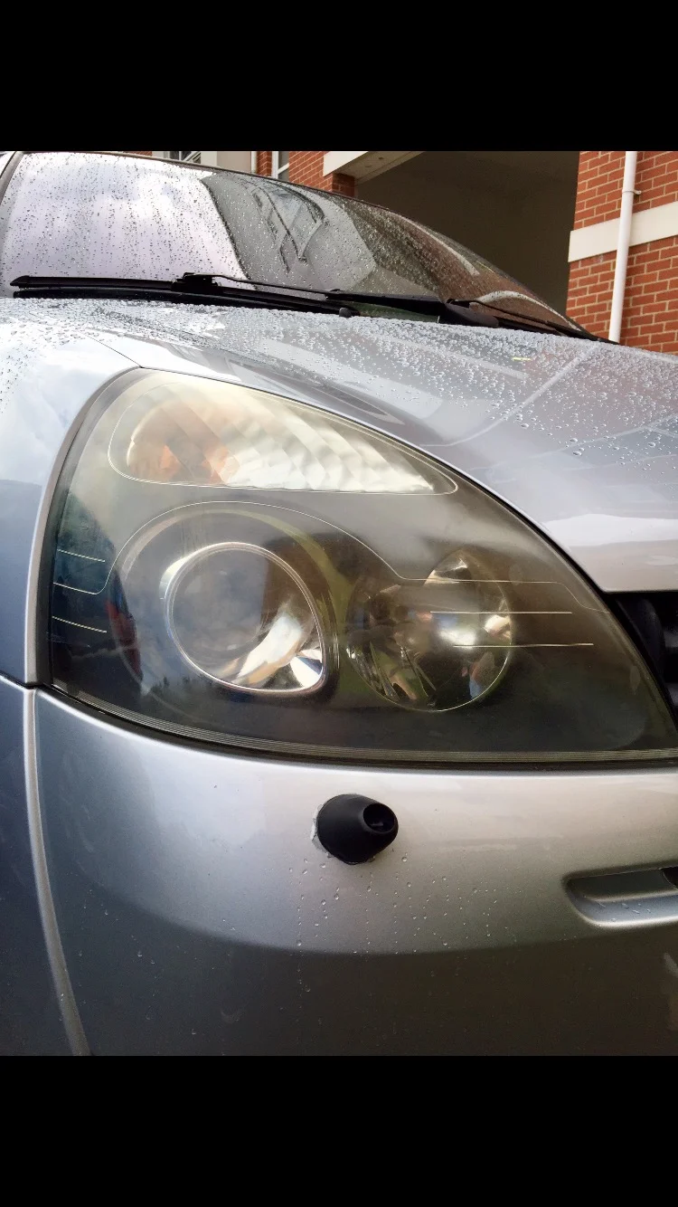

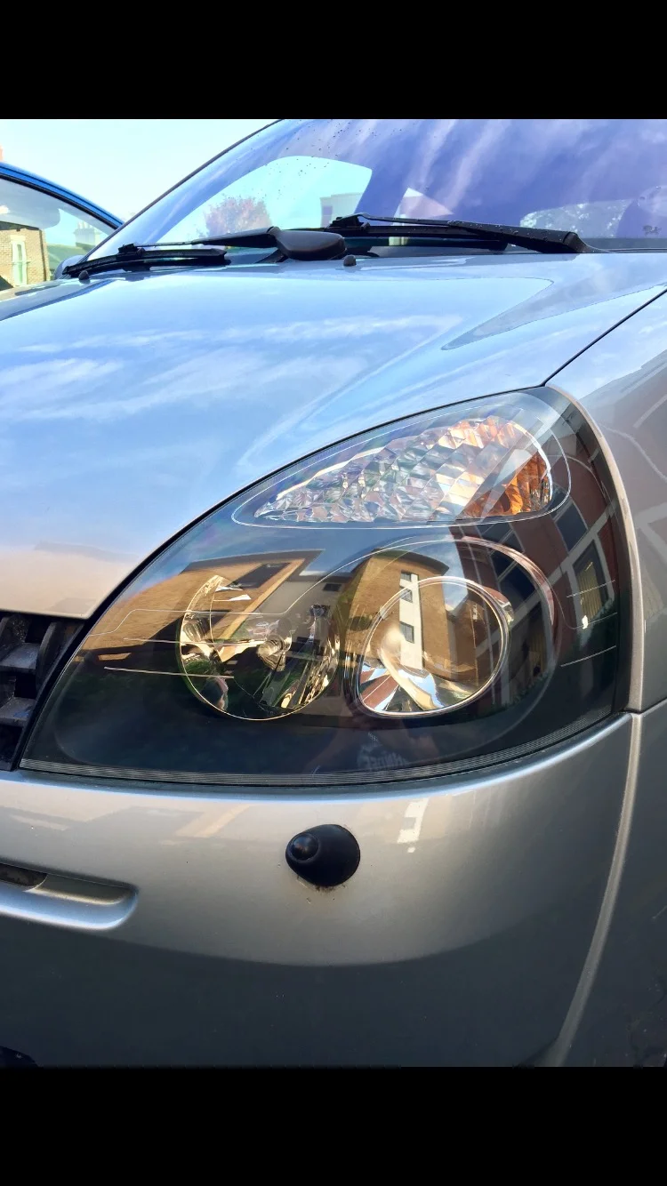

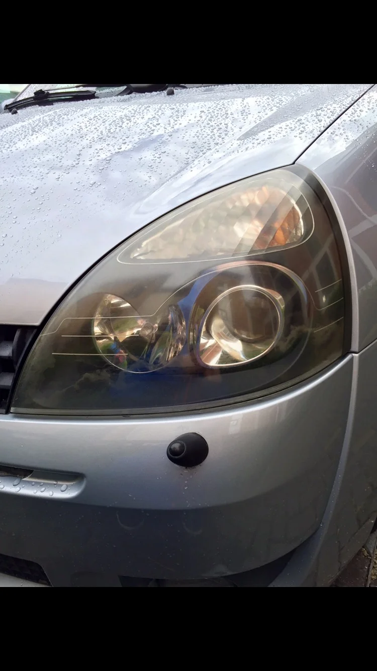

My headlights were looking pretty dire to be honest, with pitting, yellowing and a very hazy look to them, you can't really tell from the photos how bad they were. Anyway,.... couldn't put up with it anymore and the rest of the car is pretty tidy, (apart from the grille, which I'm hoping someone will help me out with soon!?) so time for action. Ordered the 3M kit for just under £20 which you use with a cordless drill. 500 grit first, then 800, then a 3000 grit Trizact foam disc, which you wet the disc and headlight whilst using. Then finally a polishing pad with the supplied rubbing compound. Took me an hour per headlight but I was very thorough and used two of each of the 500 and 800grit discs per side.
Well worth the effort though, they're gleaming now. I wouldn't want to try and achieve the same results by hand though, that's for sure!! Here's the before and after pictures.

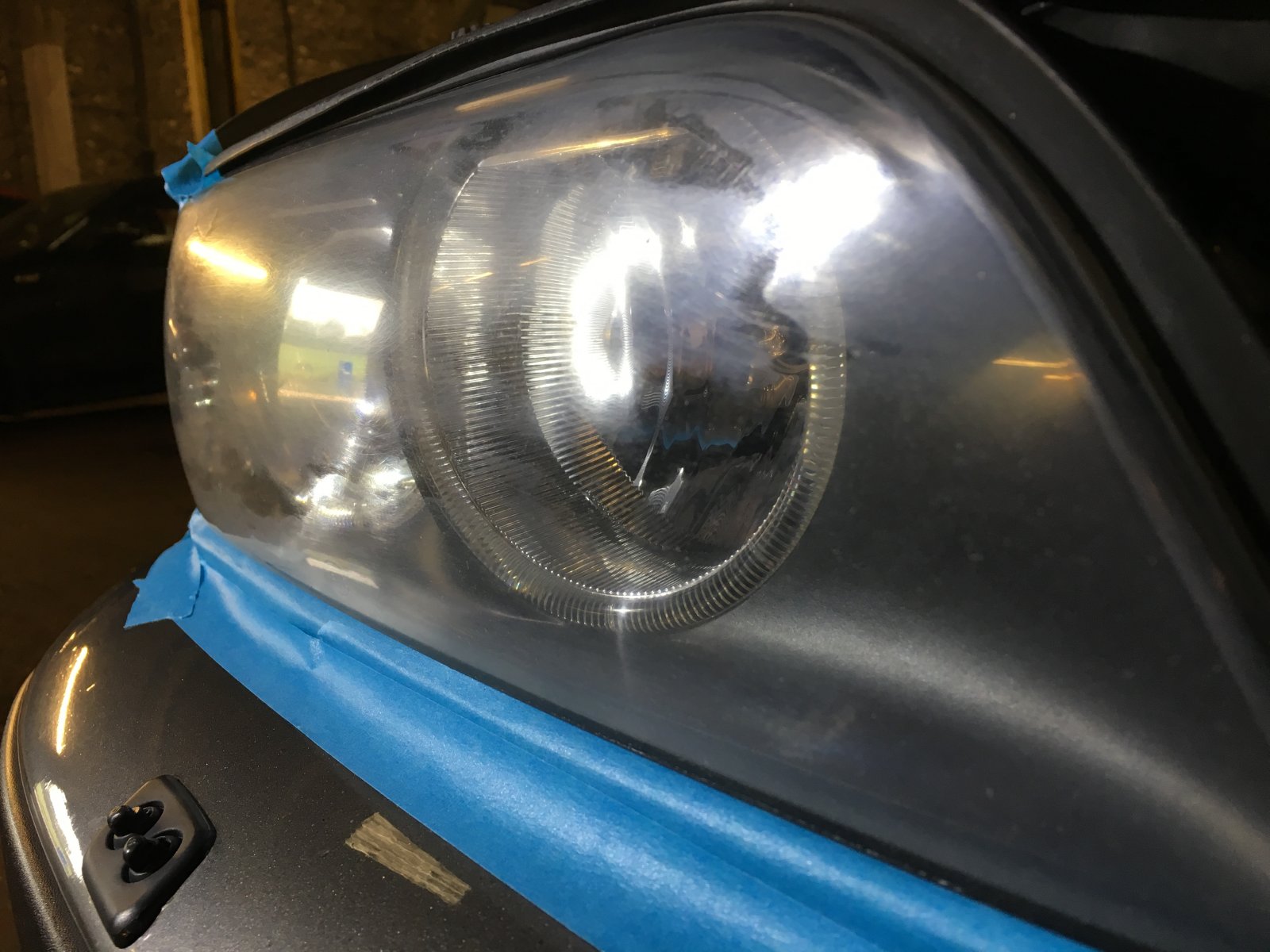

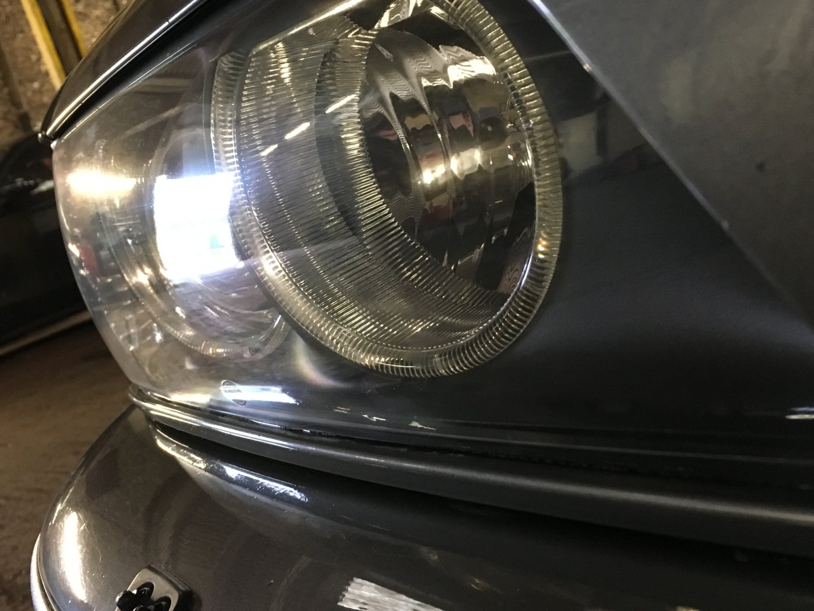

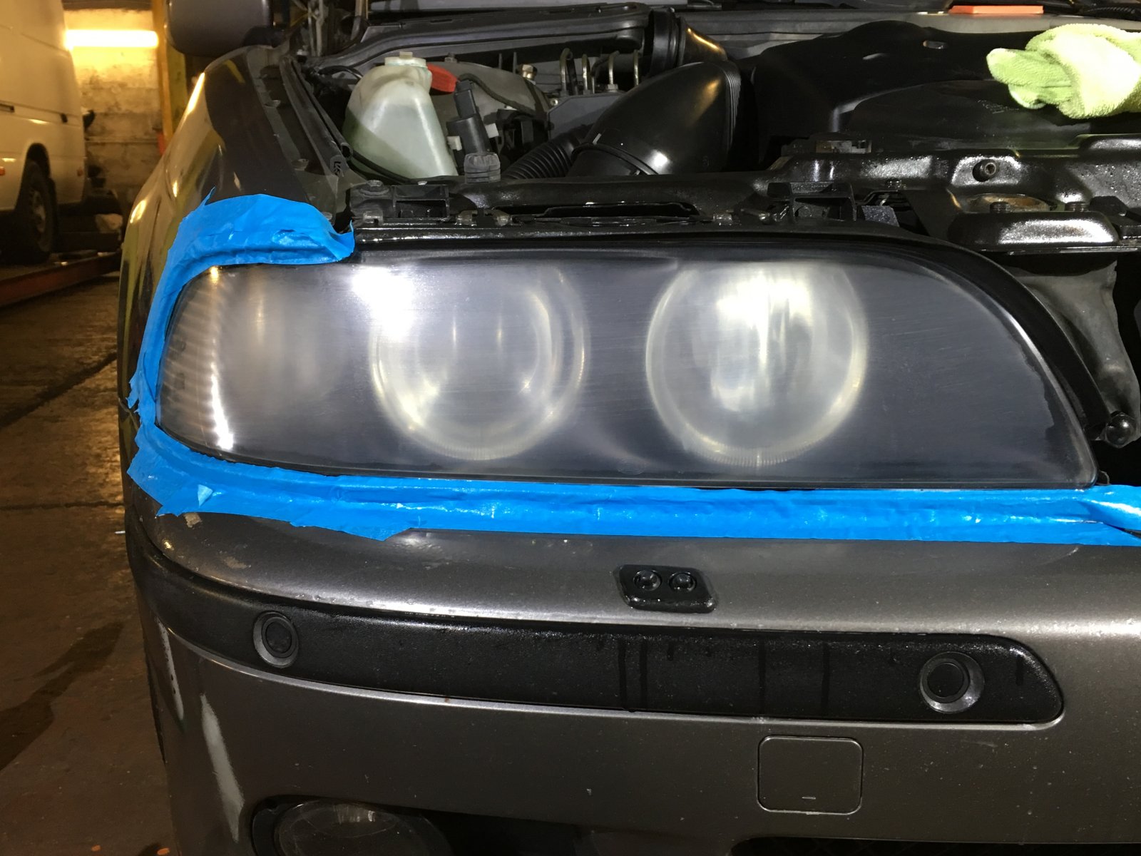

Looking good mate, I do headlights aswell with 800/1200/1500/2k/3k followed by a multi stage polish and then finally protected using some self healing Paint Protection Film to stop it happening again ;-)

No cloudiness at all on mine, in fact they look like they're brand new, a coat of UV protectant wax and jobs a goodun, and I started with 500 grit!!?

The cloudiness is from the moisture from applying the Paint Protection Film as its applied wet.

Yeah exactly! Mine look brand new, not a mark on them and I absolutely blitzed them with 500 first! Just scroll back up to the top of the thread and take another look. Just gotta work your way back up to 3000 and be thorough with each grade. The state they were in I'd have been there all day if I'd have started with anything finer!

Respect to anyone who can get decent results with the headlamps on the car, with the 3M kit. Tried it twice now and at best, the results have been 'meh'. Such a difficult light to polish consistently with a rotating drill bit on highly curved headlight.
