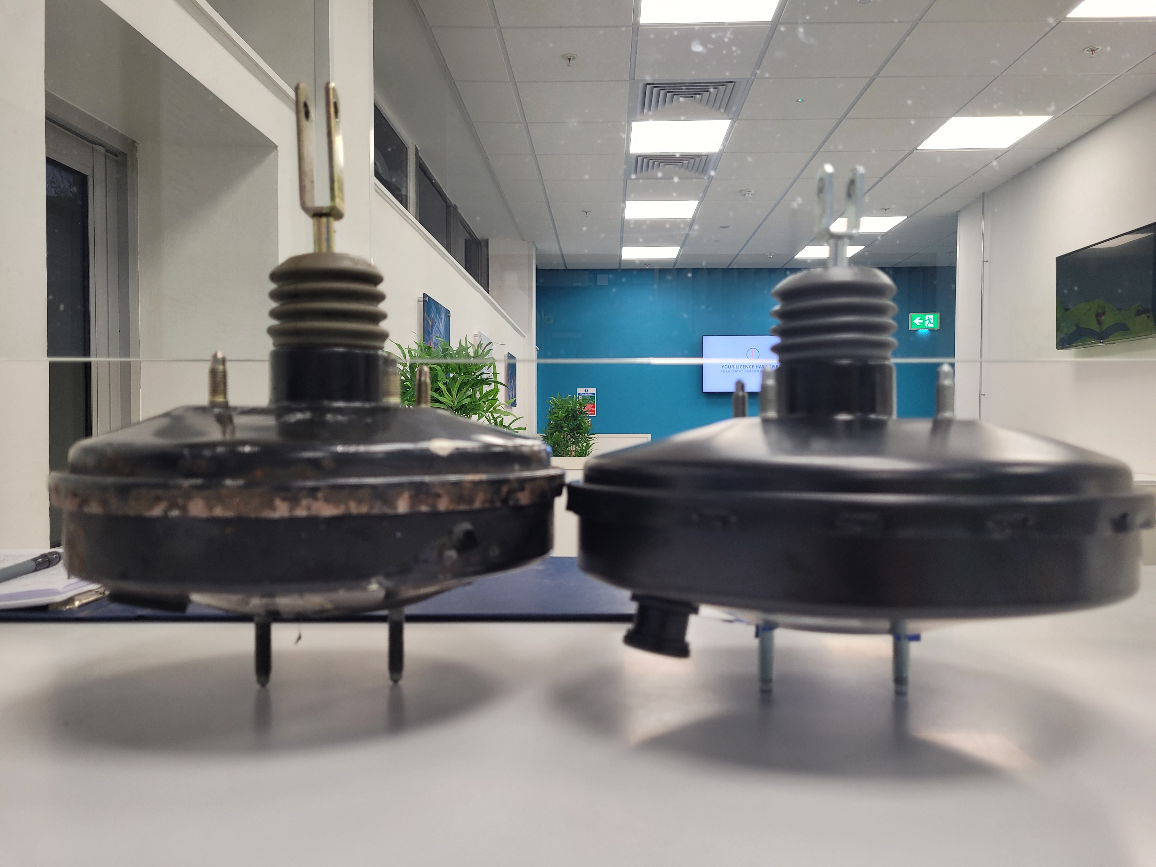

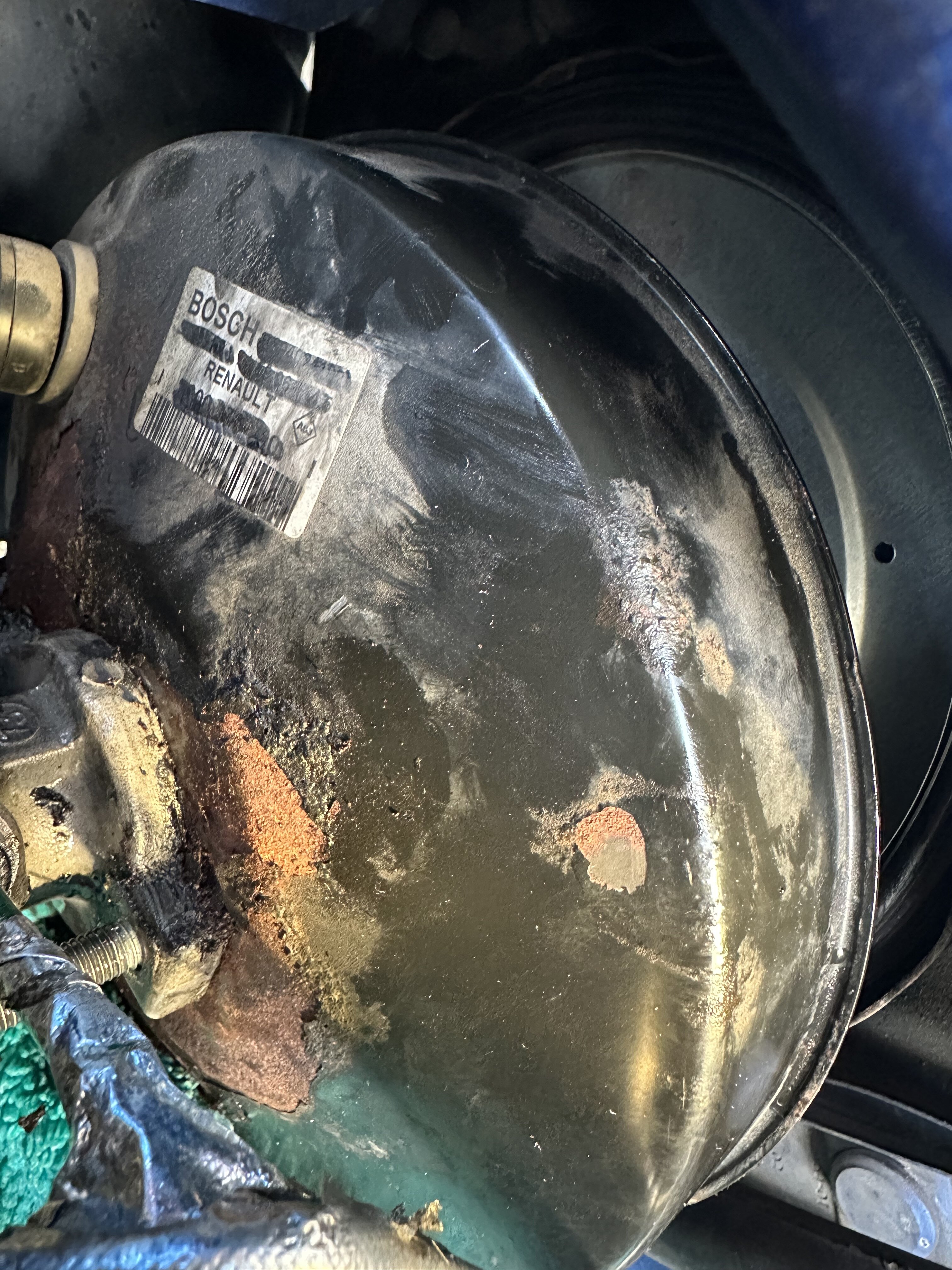

I’ve spent the last two years restoring a Clio Cup, which has been owned by a couple of members on here already. It was a solid car to start with and had been stood for a few months prior to me becoming the custodian.
Anyway, it went for its MOT and everything was going great, until we got to the brake testing… long story short, the brake servo decided to give up and split in half. Thankfully it happened there, not on the road, but now I’m stuck trying to source a replacement.
I’ve spoken to my local dealer, Mick at Diamond Motors and Pure Motorsport. We’ve concluded the servo should be the same as the 172/182, based on historic part numbers. The problem I’m finding is;

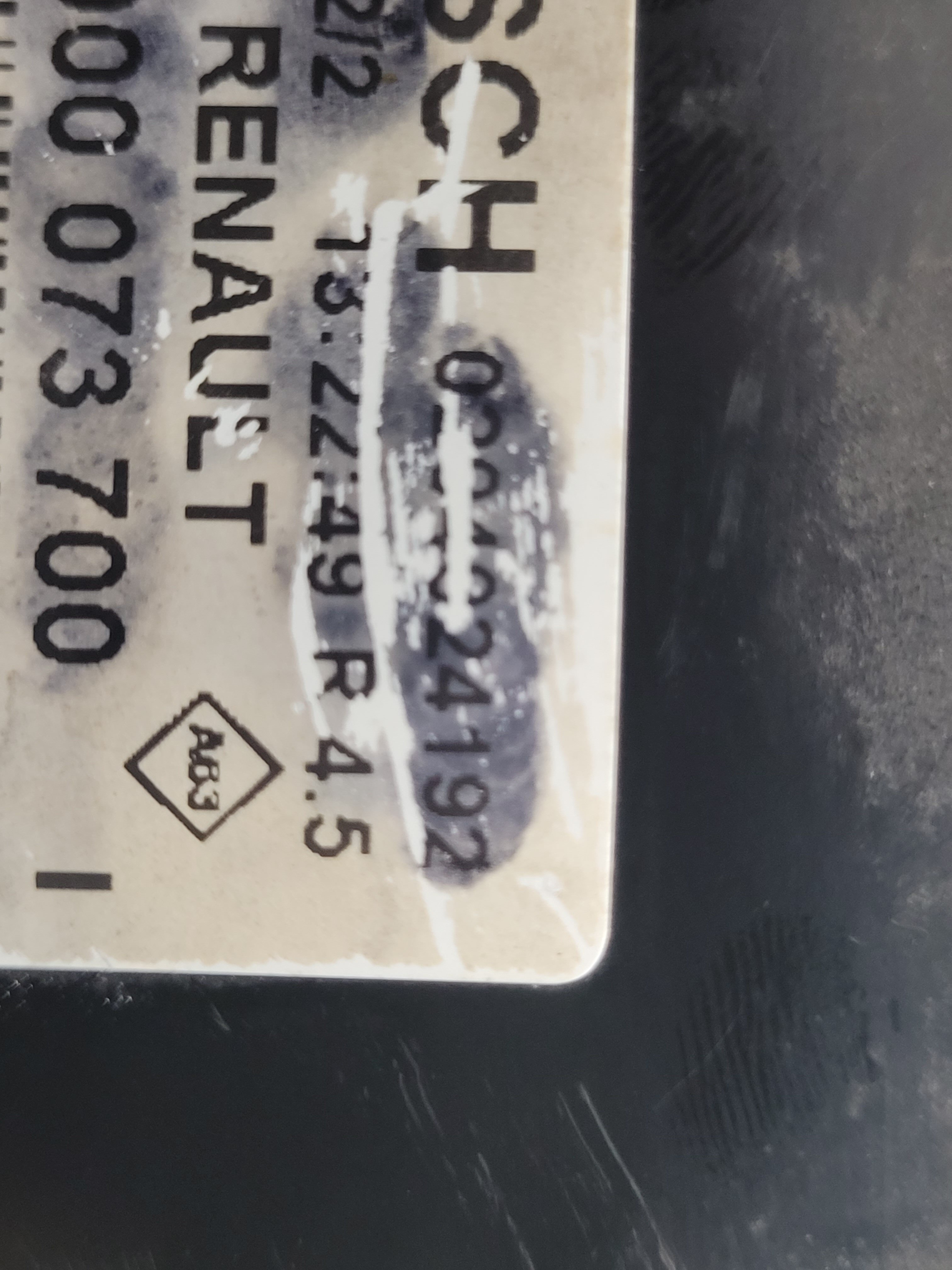

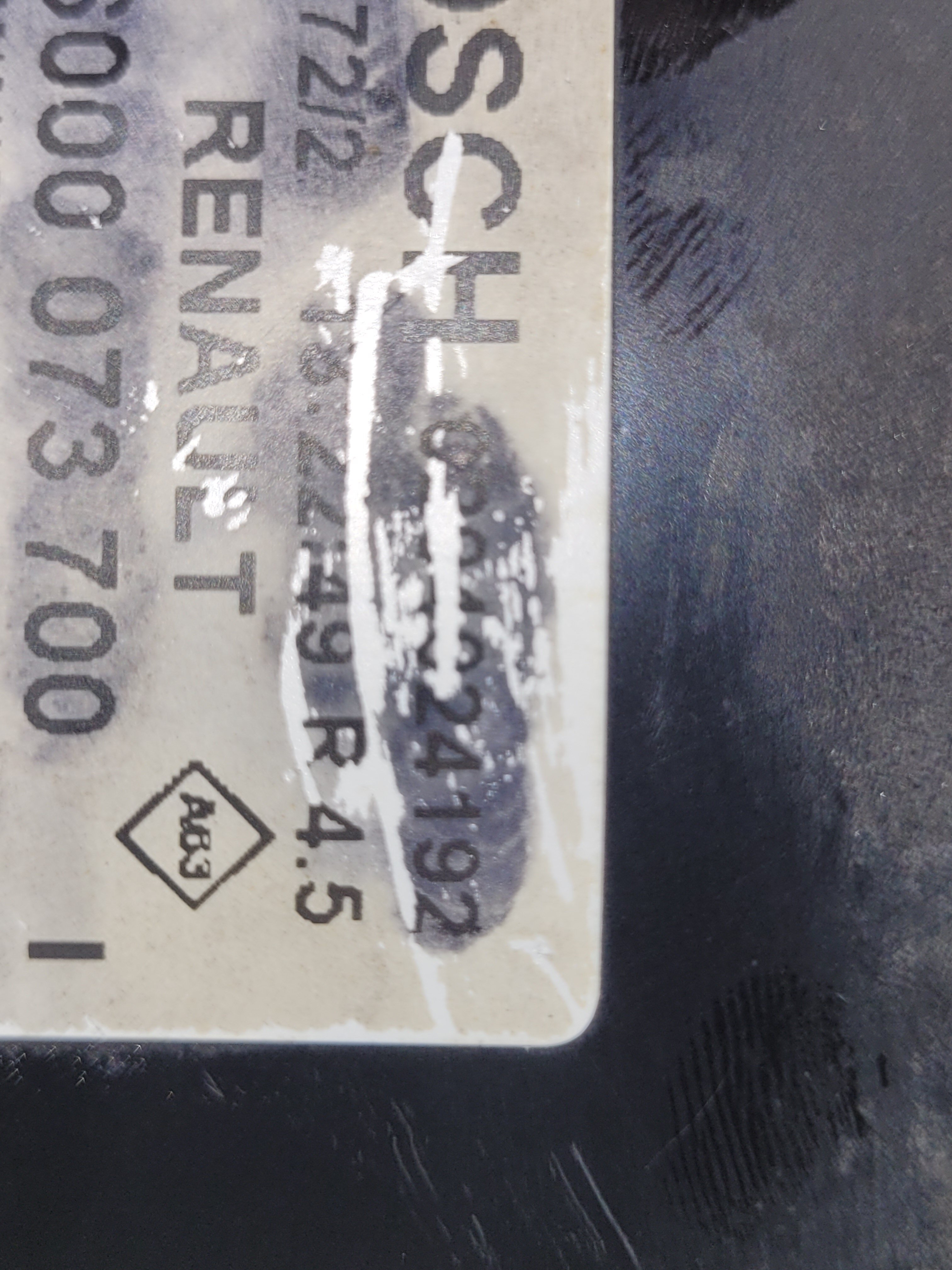

Several different part number crop up
The part number on the servo that gave up is different to the ones coming up on the likes of Autodoc, online car parts and an eBay seller in Lithuania.
I’m hoping someone can help me keep this 172 Cup in mint condition and on the road by confirming if the servo is generic across the RS Clio 172/182 range or if it is indeed unique to the 172 Cup?
Thanks for reading and hope someone can help.

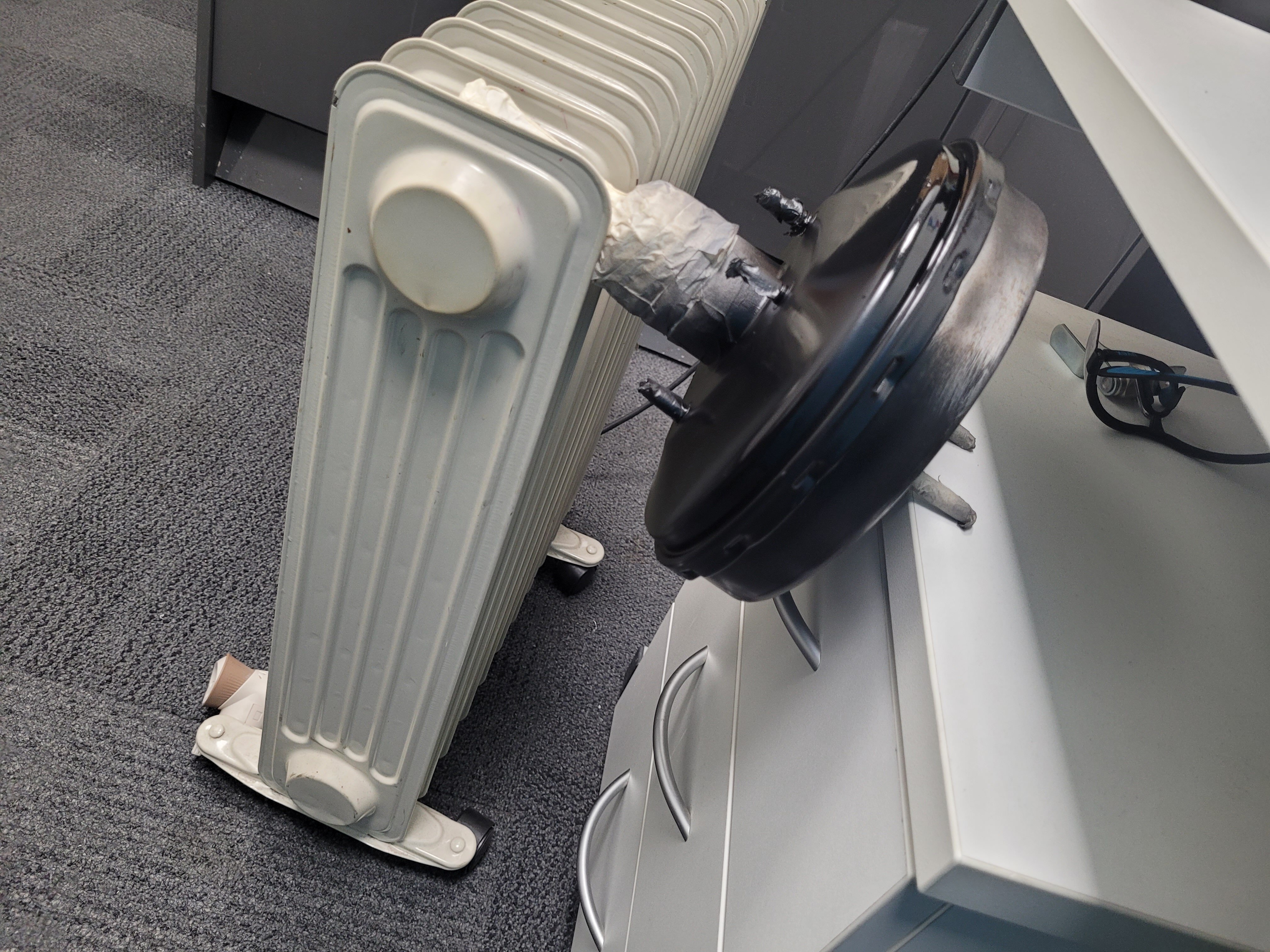

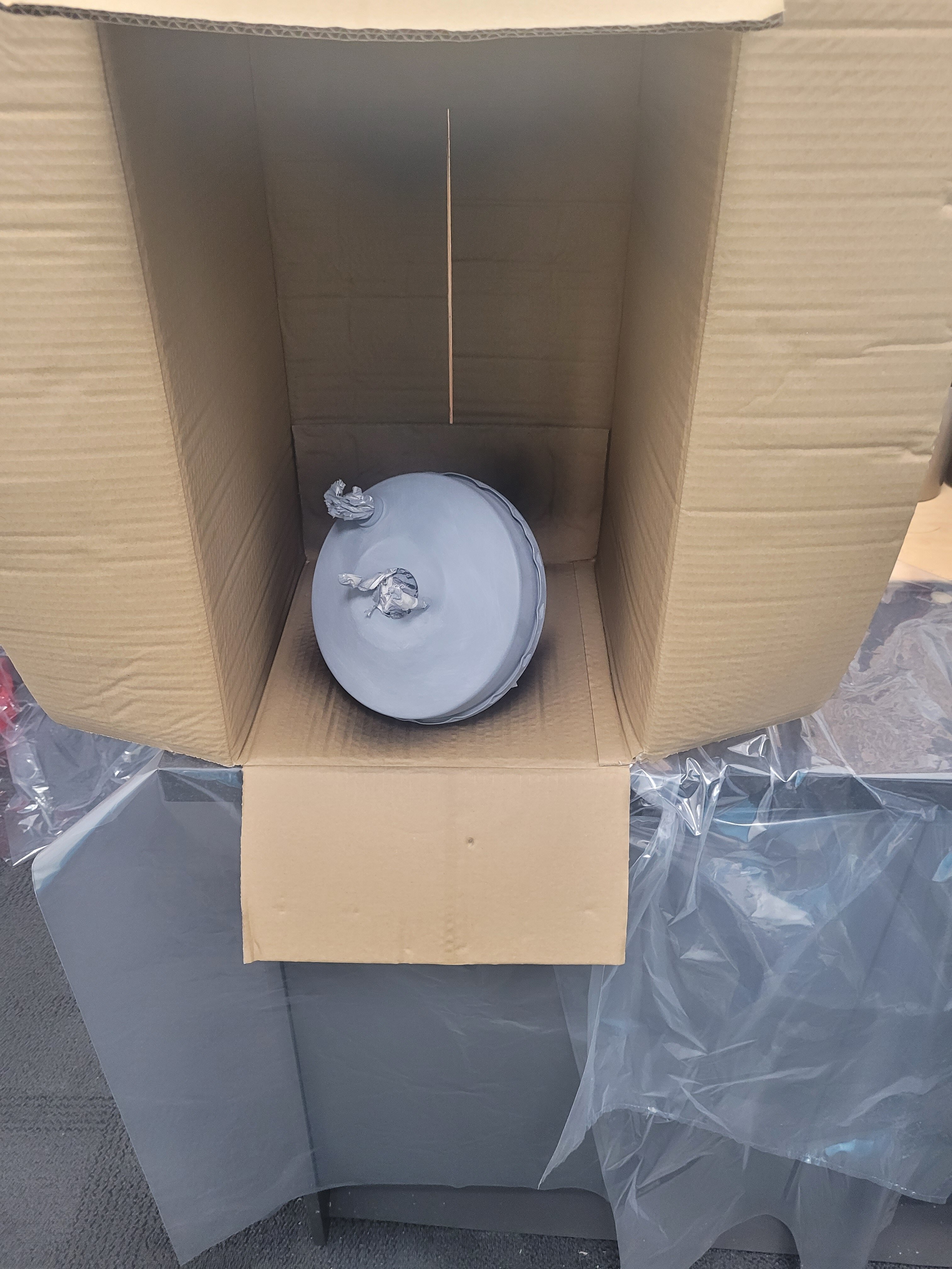

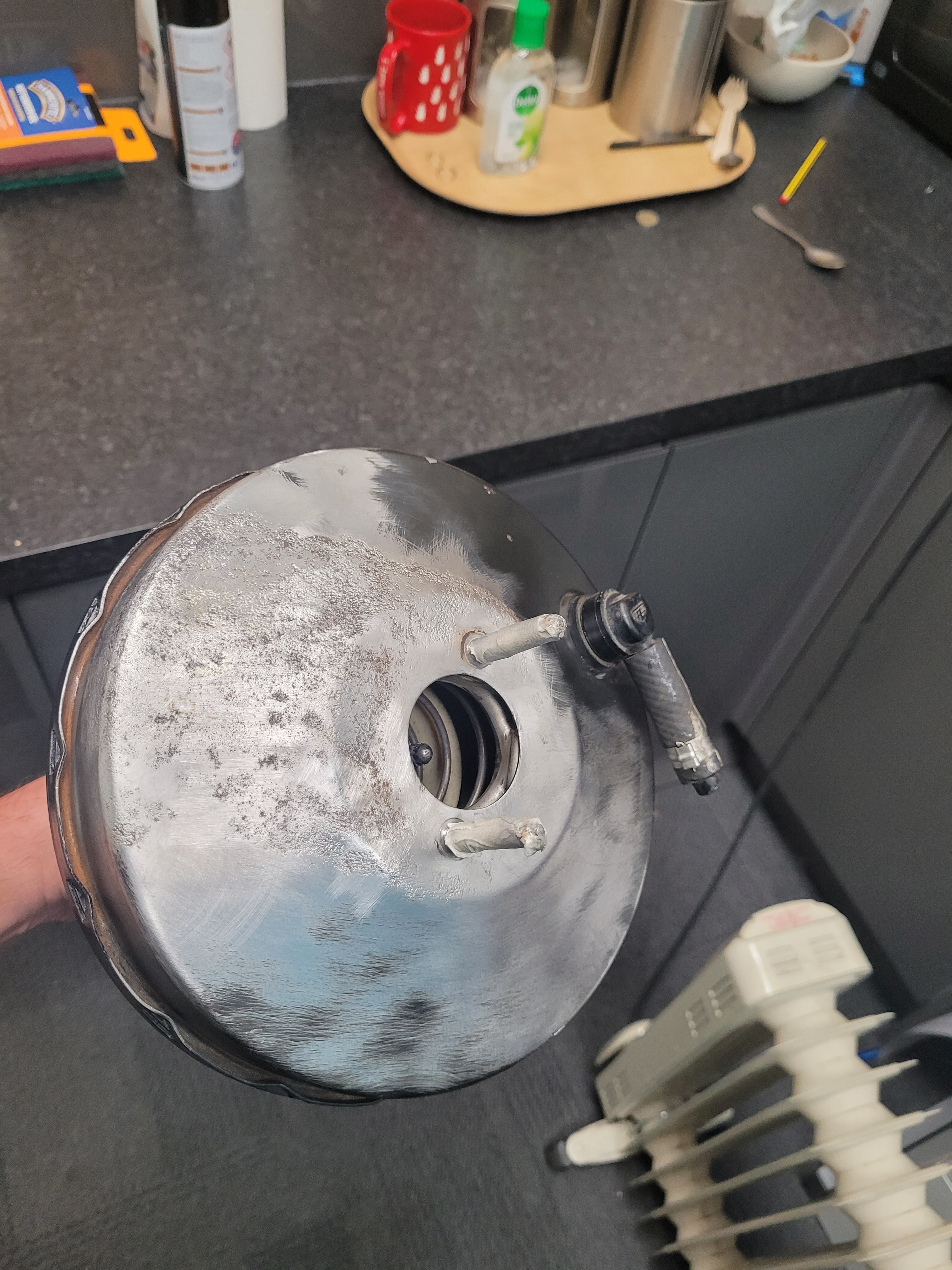

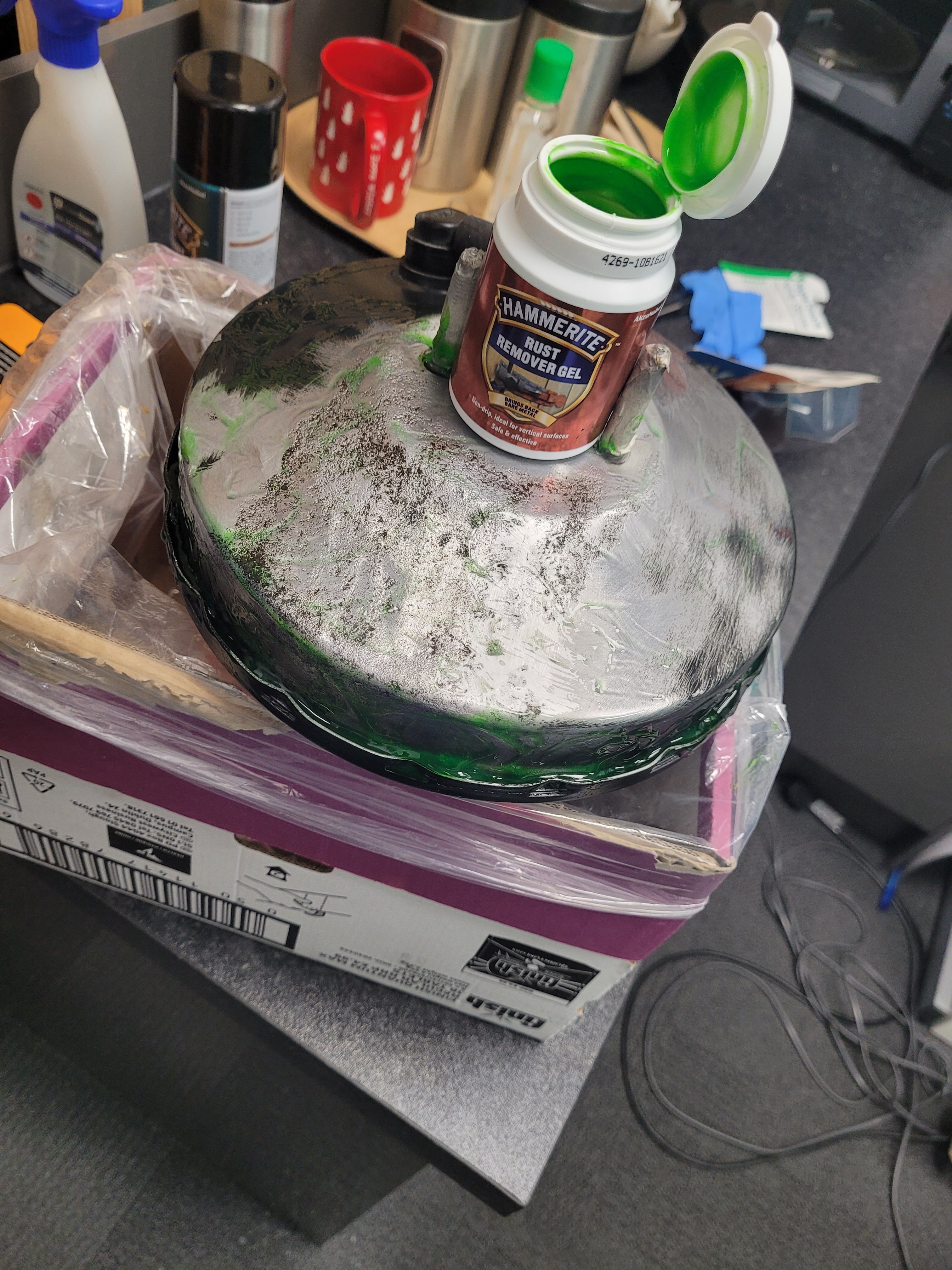

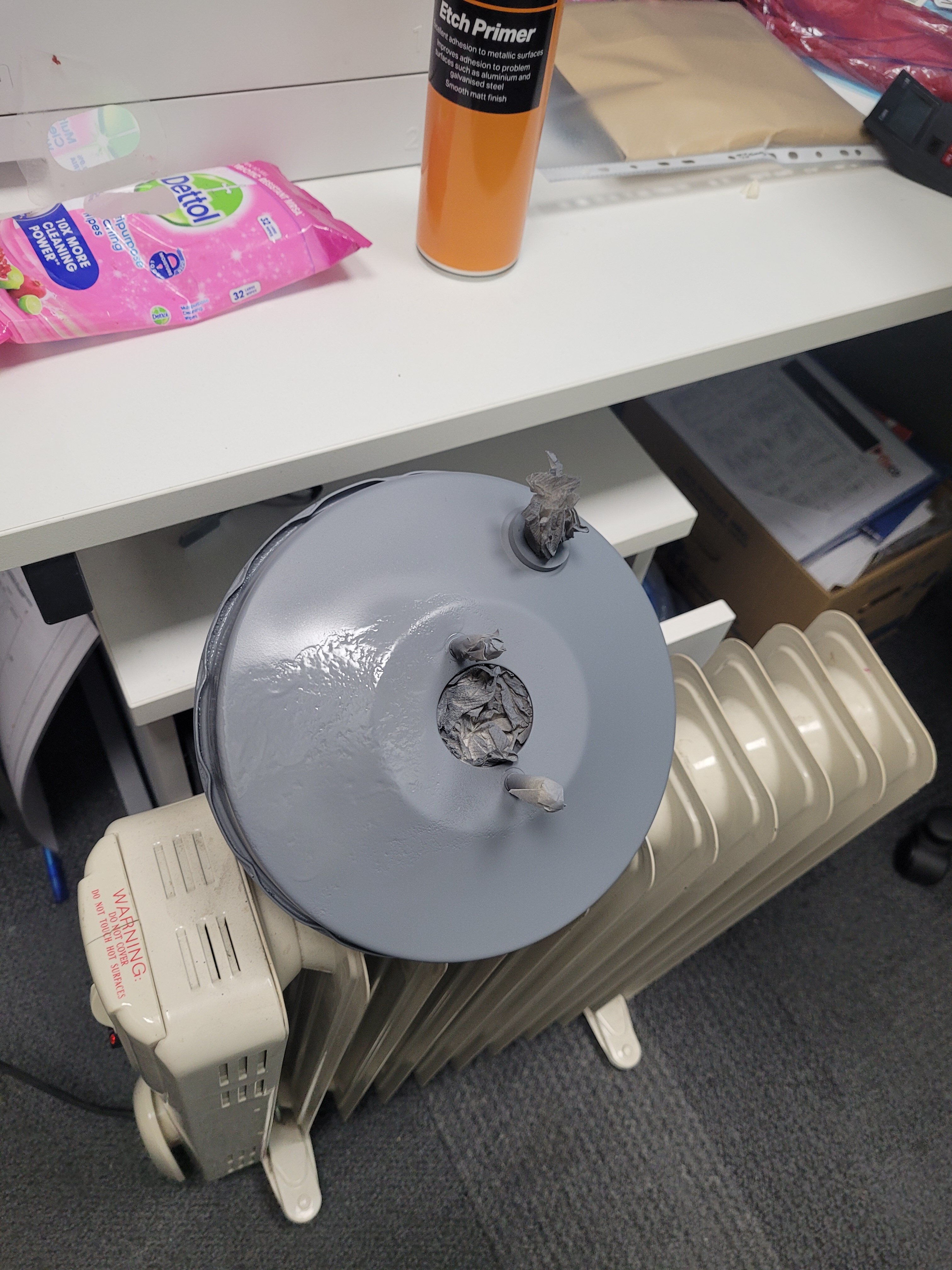

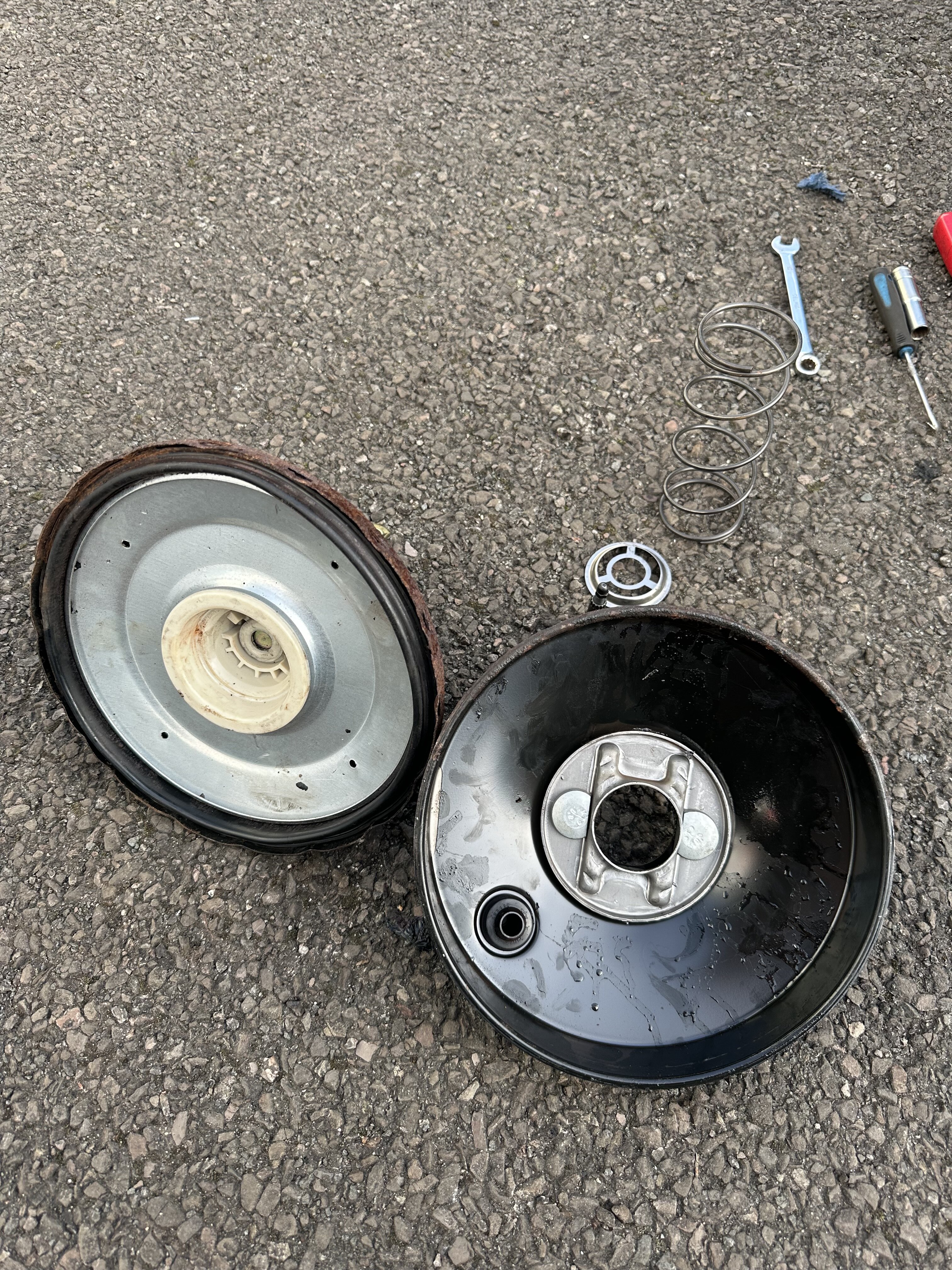

Sounds like Mick has got a dose of amnesia & forgot all about the exact same nightmare I had with with mine just over 2 years ago :ROFLMAO:
I'll have to go through my old photos to help properly explain but the short version is that I found it impossible to find a servo with the same part number as what was on the car and what I managed to find on Autodoc from cross referencing the Bosch part numbers was different & wrong.
I ended up getting a used servo from someone breaking a 172 Cup then scrubbed it back to bare metal, repainting it then running a thick bead of silicone sealant around the bottom where the 2 halves of the servo join together. It was probably started from spilled brake fluid sitting in the crease of the join, eating the paint away then combined with that area getting exposed to water & other crap which sits in the creases and it got rusty & eventually failed.

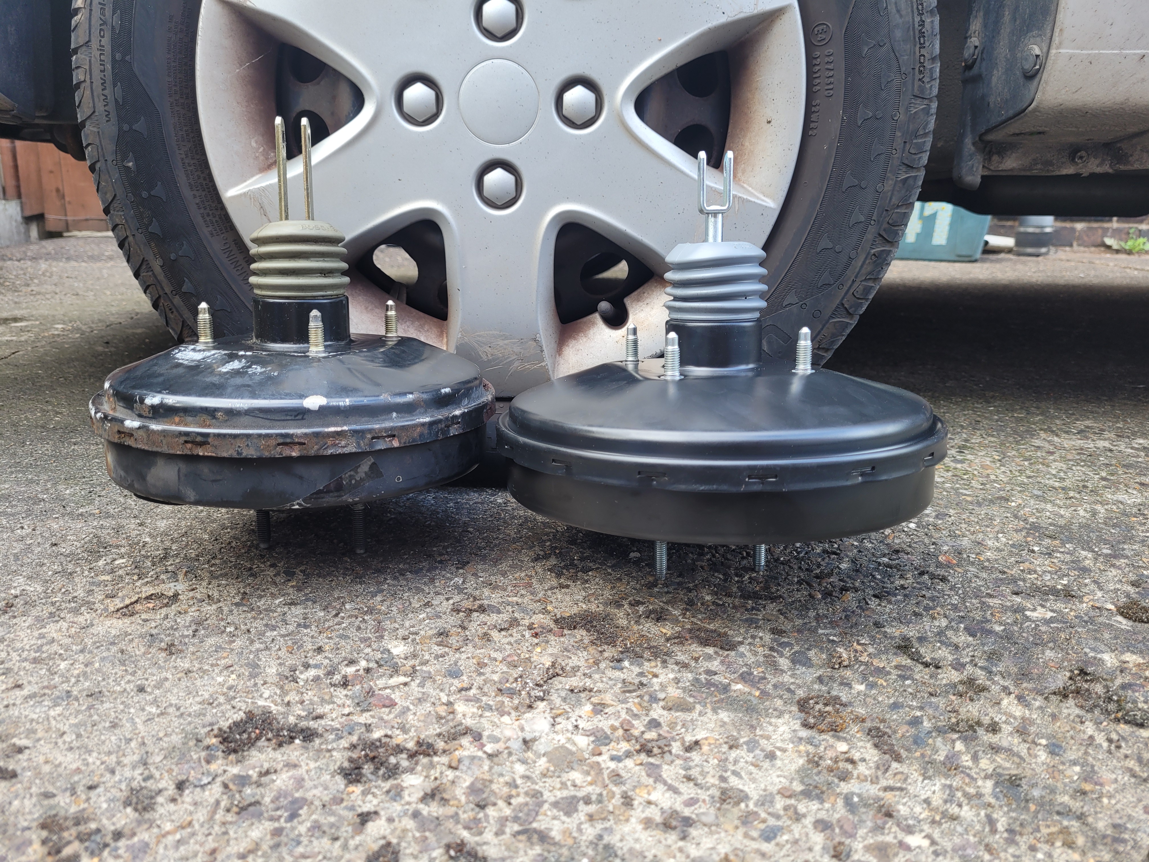

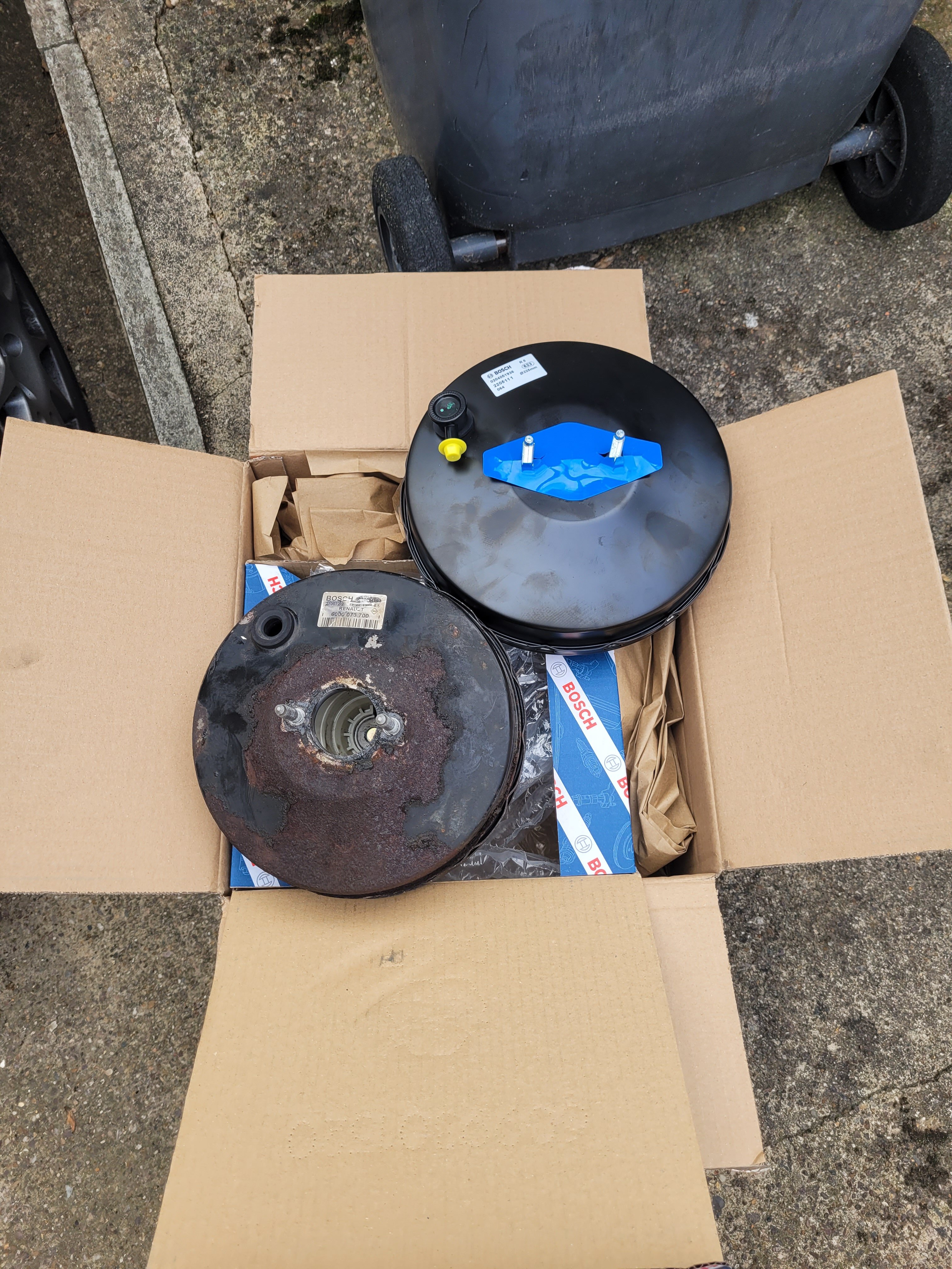

These are the part numbers from mine & what I got from Autodoc.
You can see the side by side pic that the servos are different. I reckon it's possible to swap the rod over to make it right but I chickened out because the new servo was really expensive, took ages to arrive, if it didn't work it'd be obvious that I'd messed around with it and there's a good chance they'd tell me to piss off if I sent it back asking for a refund 🤣

Hi mate. Thank you for your detailed reply, really appreciate. Ah man, so it looks like the Cup is unique and I can’t just use any servo. The one or two I’ve found are rotten and look in worse condition than mine, so I just don’t understand how it split in half.
I suppose as it’s in two pieces, I can sand it down, rust restore, attach and then run a bead of seal round like you have.
Looking at how they’re joined, you’d just need to use a punch to secure them back together. After what happened, you can imagine I’m a little reluctant in case it happens again… just in the road next time.
Also, as you say, I’m very reluctant to buy and split a brand new one.
So… back to the hunt or restore.

You've got no chance of restoring yours, the rust has completely compromised the metal at the point it needs to be it's strongest (that's why it split in 2) it's just like rust anywhere else on the car, the only way to repair it is to chop it out & replace the metal itself.
On top of that you can't even weld it back together as you'll trash the rubber diaphragm inside.
I only gave up looking to use a different servo & modifying it as I dropped lucky finding a Cup servo that happened to be in good nick

If I was in this situation again I'd be getting my hands on some other servos & dismantling them to measure & compare stuff inside (I was about to scrounge some from a local scrappy that had a load of pov spec Mk2's in) with a view to making a good 1 that fits & works.
As far as I can think, it's the length of the rod the pedal attaches to that is different and it appears relatively easy to swap those out so that's the route I'd be going down - as well as desperately looking for a used one from a Cup
I think that is what I’m going to do. I’m going to get a servo from Stu at Renomotive, as he has an few and see what I can ‘create’.
When I’ve been thinking logically, the fork that holds the pedal is shorter, so this would affect the pedals resting location.
Also I found that the amount of servo assistance on the Cup was reduced, due to the lack of ABS (now is that due to no ABS, or the actual servo?)
If it’s a case of the pedal sitting in a different location, it should be sat in the same location as a 182, as the pedal assembly is the same - on the grand scheme of things, that isn’t a problem.
As for servo assistance, is it really going to be so different, that it makes the car un-drivable? Probably not.
So best case, I can cobble something together to make a 172 Cup spec set up. Worst case, I’d have to get used to a slightly different pedal feel… as for my OCD… I’ll have to just accept ‘it is what it is’.
I’m realising the Cup is a lot more unique than what you read in a brochure… which leads me to think that Renaultsport in the 90’s/00’s were pi$$lng money to develop unique parts for a special car… although homologation for rallying, I guess it was a blank cheque!
I'm thinking this could also be related to the master cylinder being different on the Cup - I could also be talking a load of b****cks but it's something that seems plausible from my experience
I’ve also heard that. The master cylinder is supposedly different, but I will see how it fits up to the 182 servo. As long as a vacuum can be generated and there’s no leaks, the servo will work. It’s all down to just how much assistance the 182 servo will give.
I might buy a 182 master cylinder too, to be safe, but years ago I did remove the ABS from a 182 and it still braked absolutely fine… and in all honesty, it was an absolute bodge job.
From driving both, the 182 never felt over assisted, but the Cup for day to day normal driving, could do with a little more. Great for modulating brake pressure on track, but it was never restored to be driven balls to the wall… also, I’m awfully close to 40, so those days are long gone 🤣

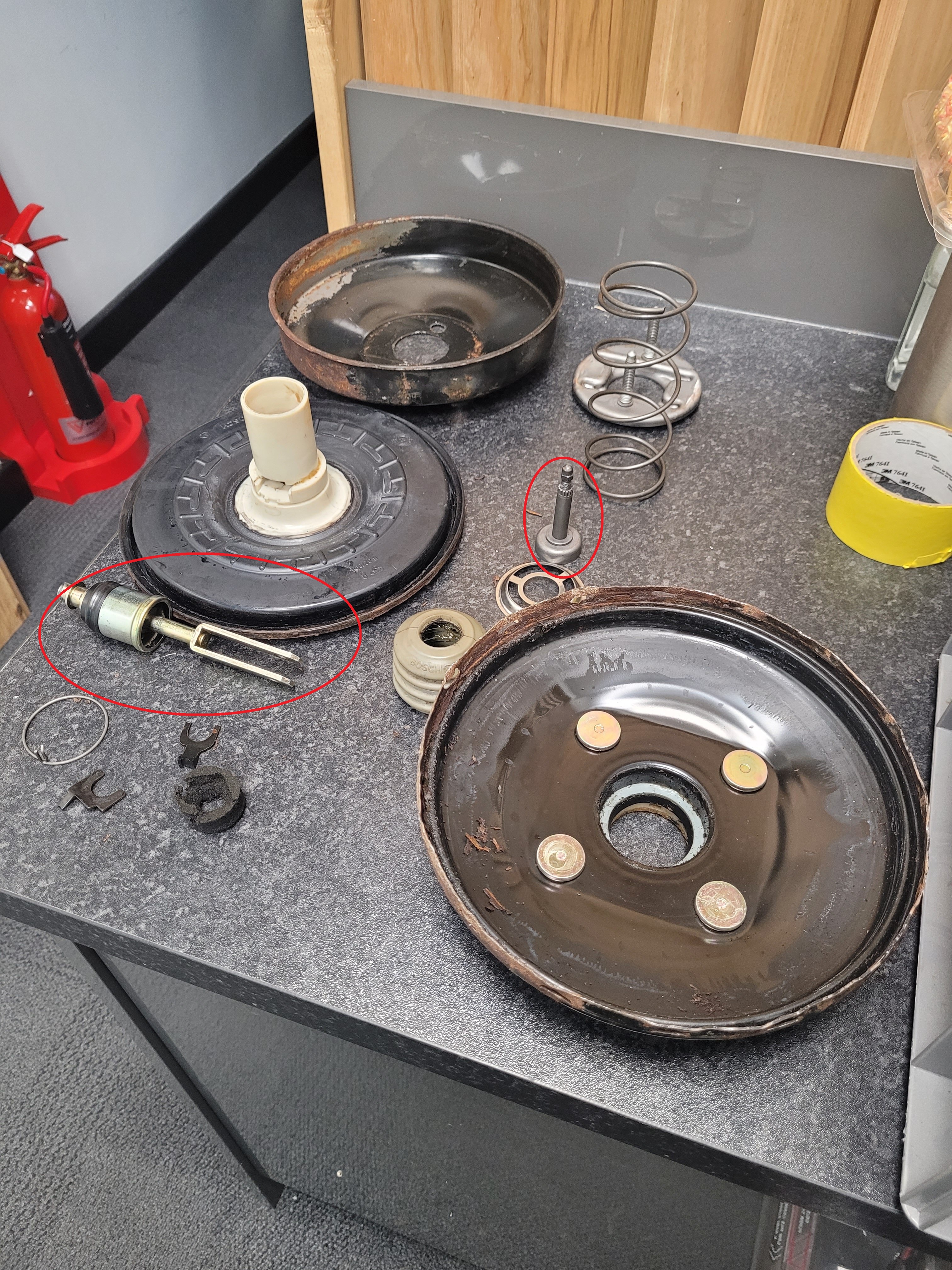

I'm starting to think that it all just comes down to these 2 bits circled in the pic, I'd be swapping those bits over into a different servo to see if it does the trick
  Clio 200T and 182 FF
I thought the 182 master cylinder couldn't be used because it only has 2 ports where the non abs one from the Cup has 4 ports?
I was thinking more along the lines of the piston inside the MC being in a different position requiring a different length rod to press it while maintaining the same pedal position.
Ah ok… thank you for letting me know about the 182 MC… that was a total oversight on my part. You’re right, it has two, Cup has four. So that idea is out.
I’d also agree with you on those parts needing to be swapped out too. How easy is it to remove the part the pedal attaches to? As the servo split in two all by itself, the smaller rod thing was easy to extract.
Also, when splitting the servo, what did you do regarding those indentations that attaches the two halves together? And reattaching them, did you use something like a punch to pinch the halves back together?
16v_paddy
  Valvers & 172 Cup

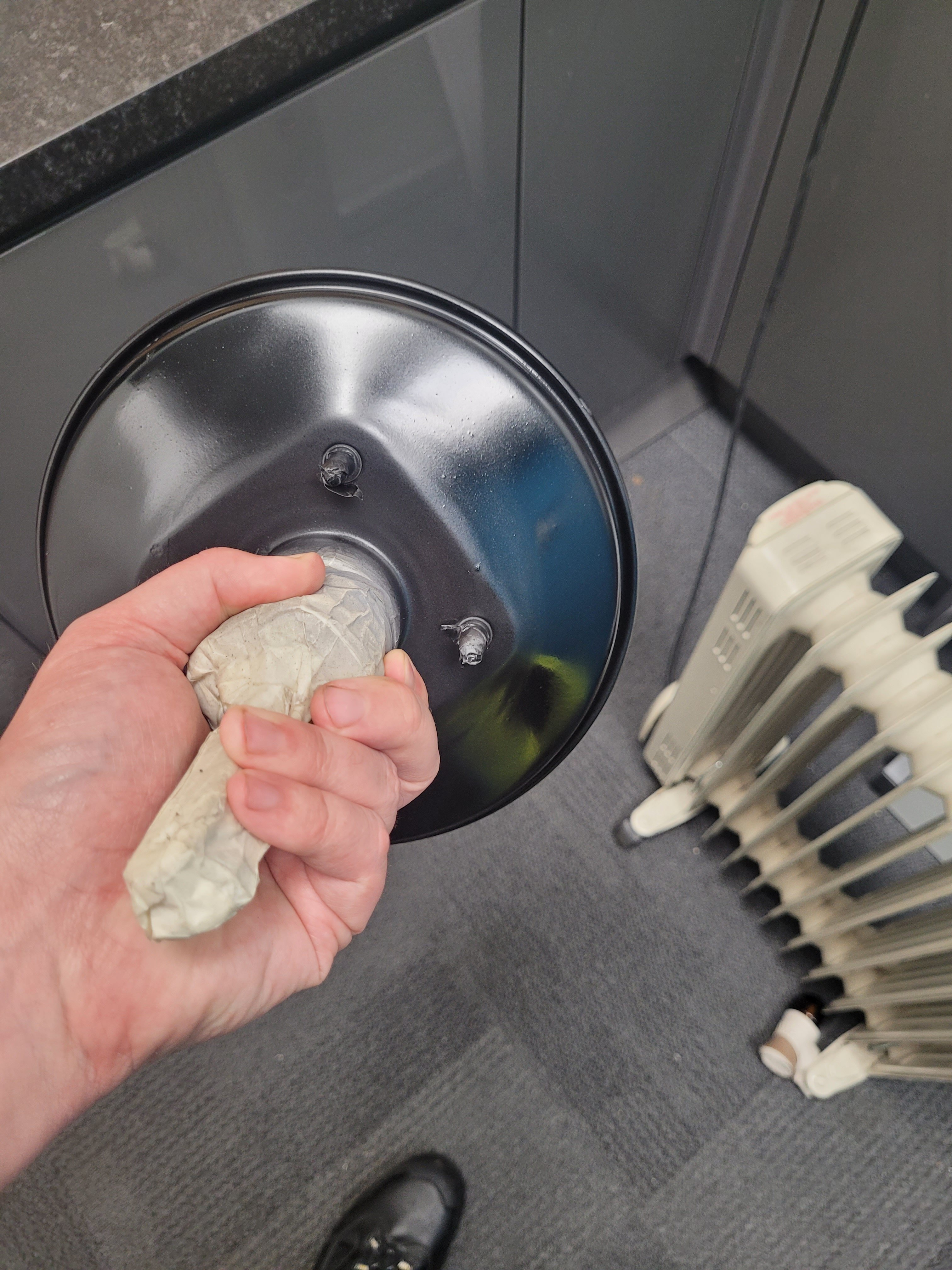

The servo in my pic is the 1 that split itself open so that bit was already easy to disassemble 🤣
The rod the pedal attaches to is really easy to remove, it sits inside the plastic sleeve & is held in place with the 2 black clips which are then secured into place by the circlip spring thing
On the replacement servo I didn't actually split it apart, I did pry apart the indentations a bit so I could get the silicone in there better then used a punch to pinch them back together - just make sure you use something to clamp & hold the 2 halves together 1st because as soon as you start to hammer the indentations in, the shock and spring pressure can make the whole thing explode apart
