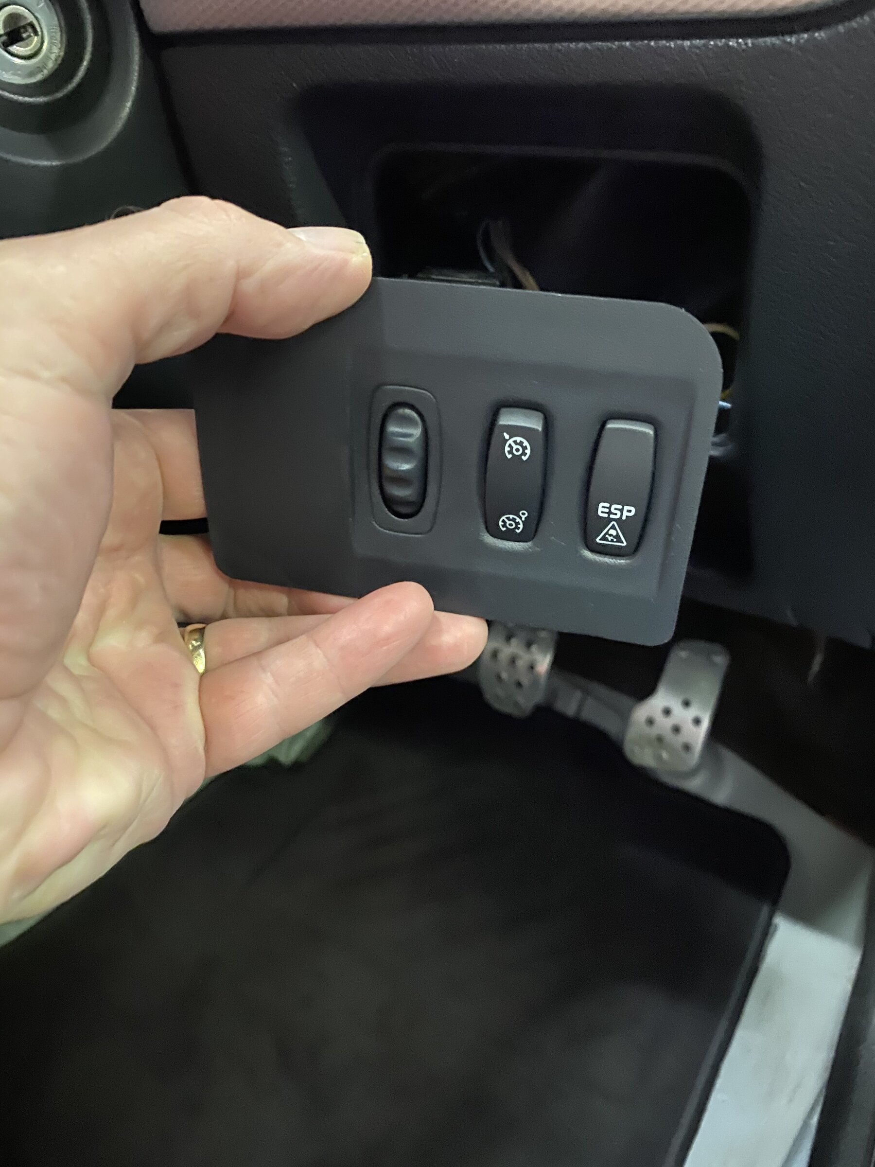

Does the presence of these bad boys mean I can retro fit cruise control etc?

@DomP182 I retrofitted cruise to my 53 plate 172 earlier in the year.

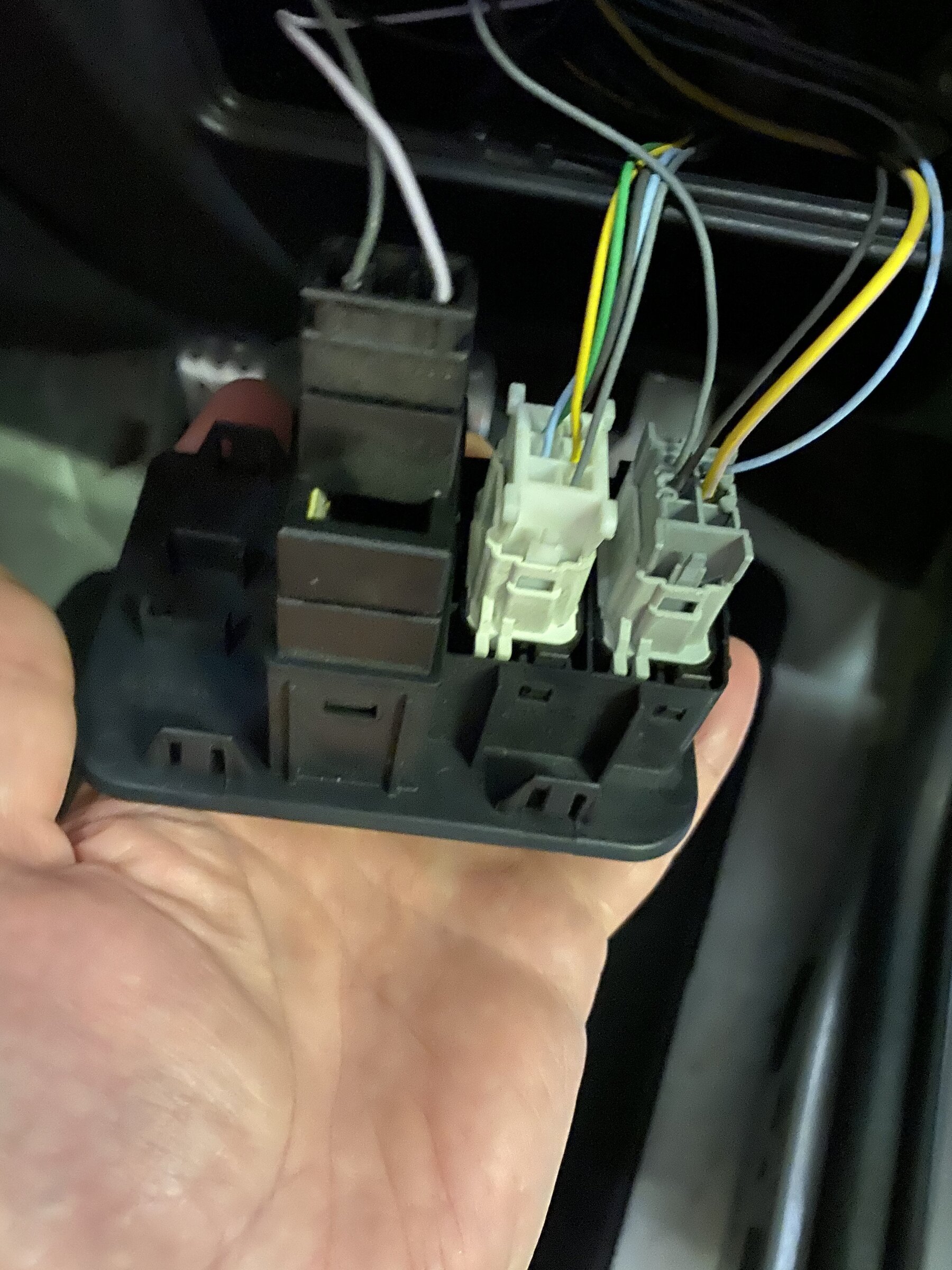

The first thing I done was buy a second hand cruise switch like your photo to check that I had all the required wiring in place. (Photos Attached).
To check it works with ignition on press the switch and SET should come up where mileage is displayed with either a orange light or green light. The middle switch in the photos is the Cruise/Limiter switch so hopefully will give you an ideal of what plug is what. Once I established this I then bought the following.

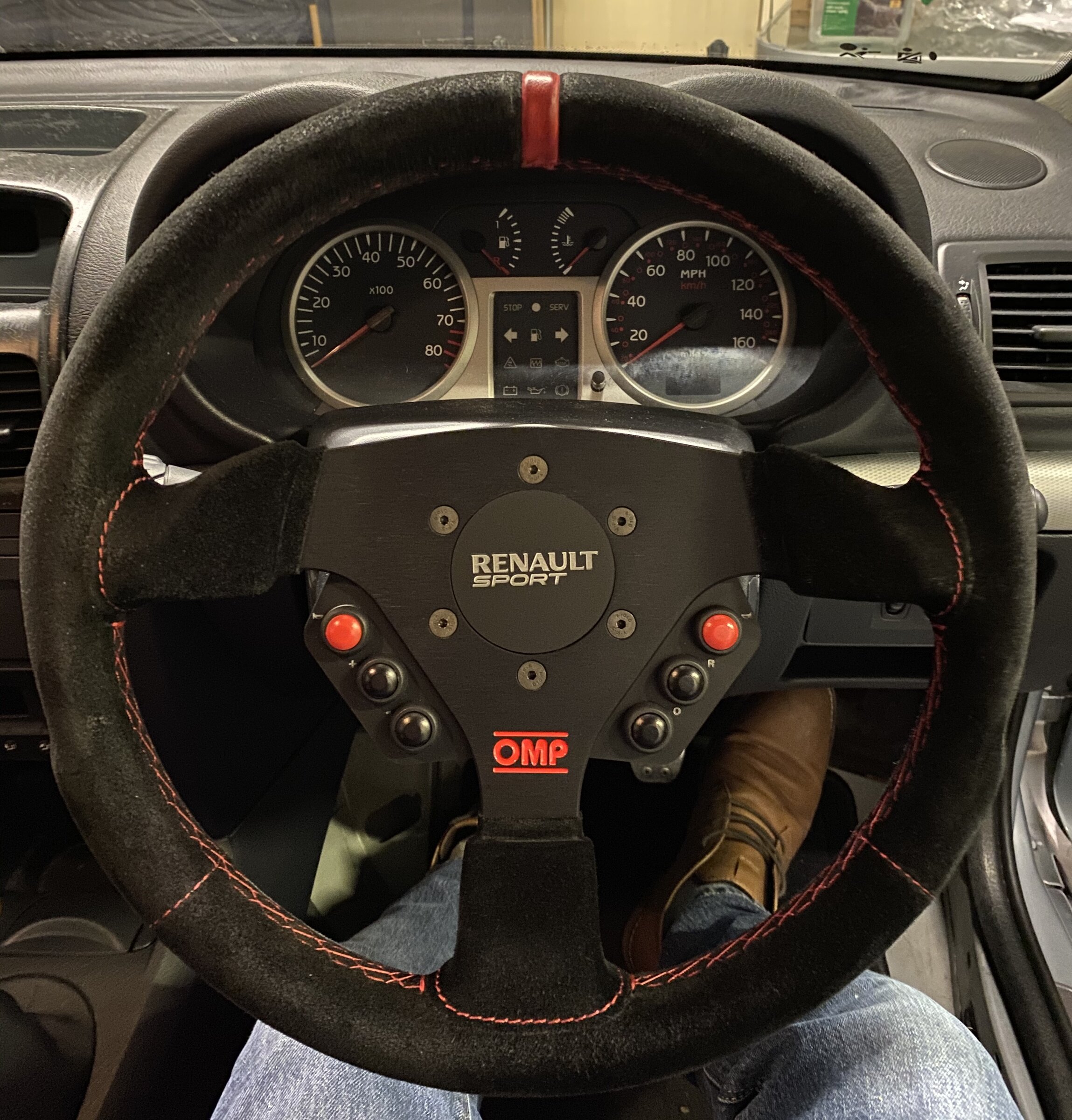

Last Purchase I made as I have an OMP Wheel was a Volantech panel with cruise and Horn buttons.

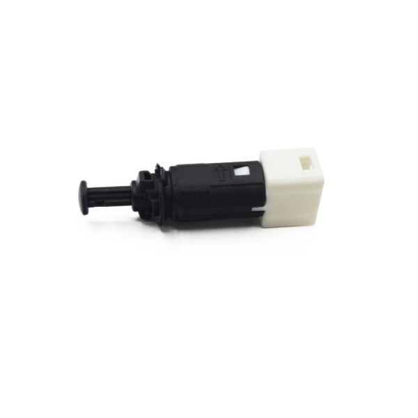

Thanks again for your help, would I also need a brake switch? I've read a few guides with contradictory info
@DomP182 just taken mine out for a quick drive to check. Cruise does turn off when I brake and I have to resume it on the R button.
I did replace my brake light switch in 2019 due to a faulty switch. Will look for the part number later, but I am sure it’s just a standard brake light switch from RPD.

I had mine re-trimmed six years ago and it still looks like new. Although I now also have the OMP wheel.

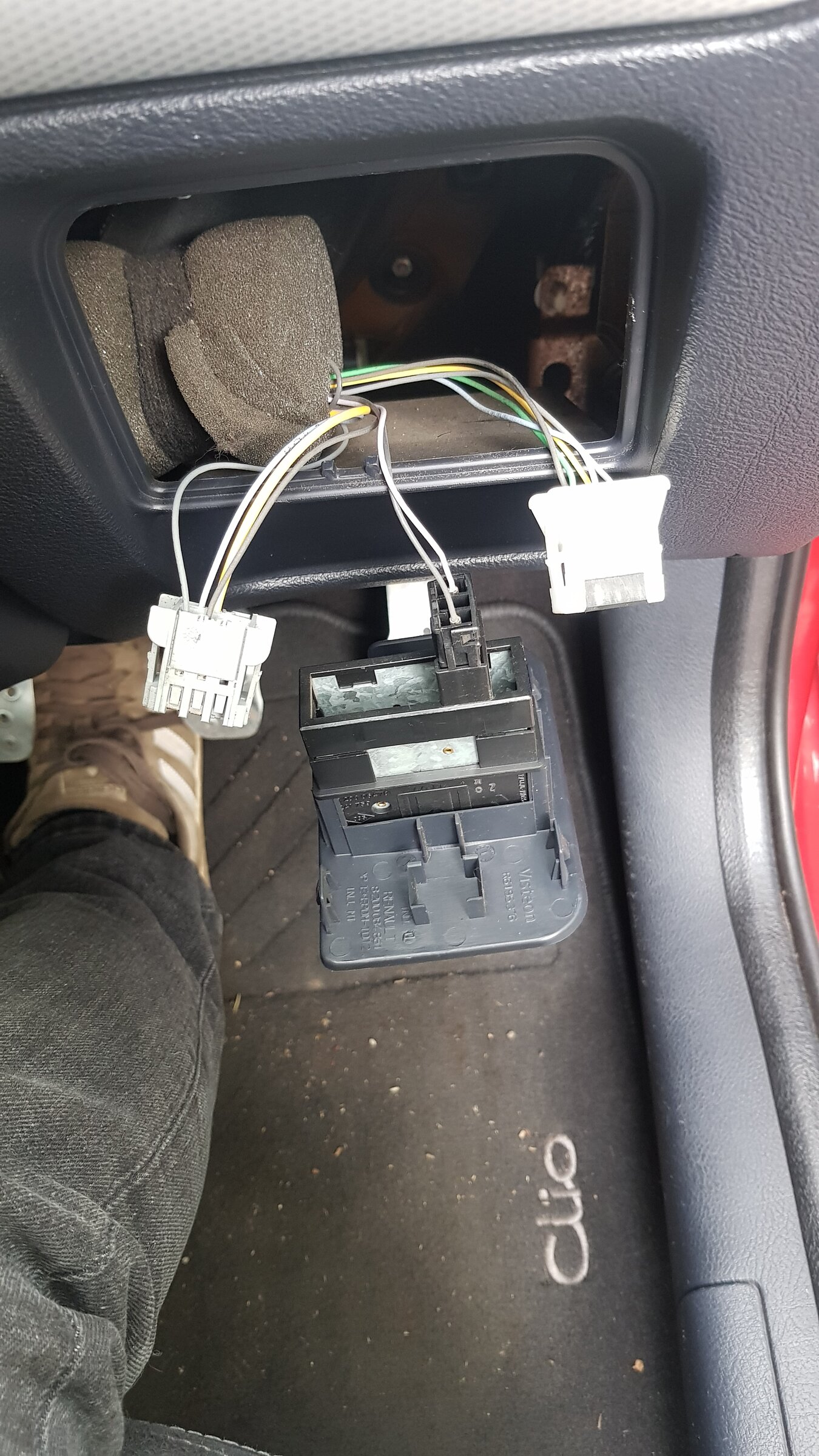

Have you tried the ESP/cruise switch and not got the SET and lights?

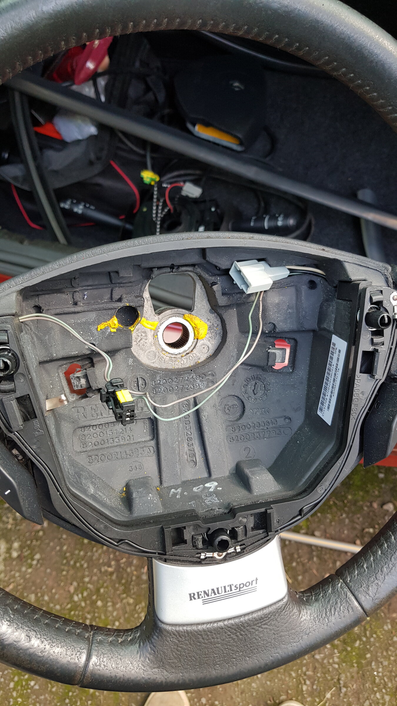

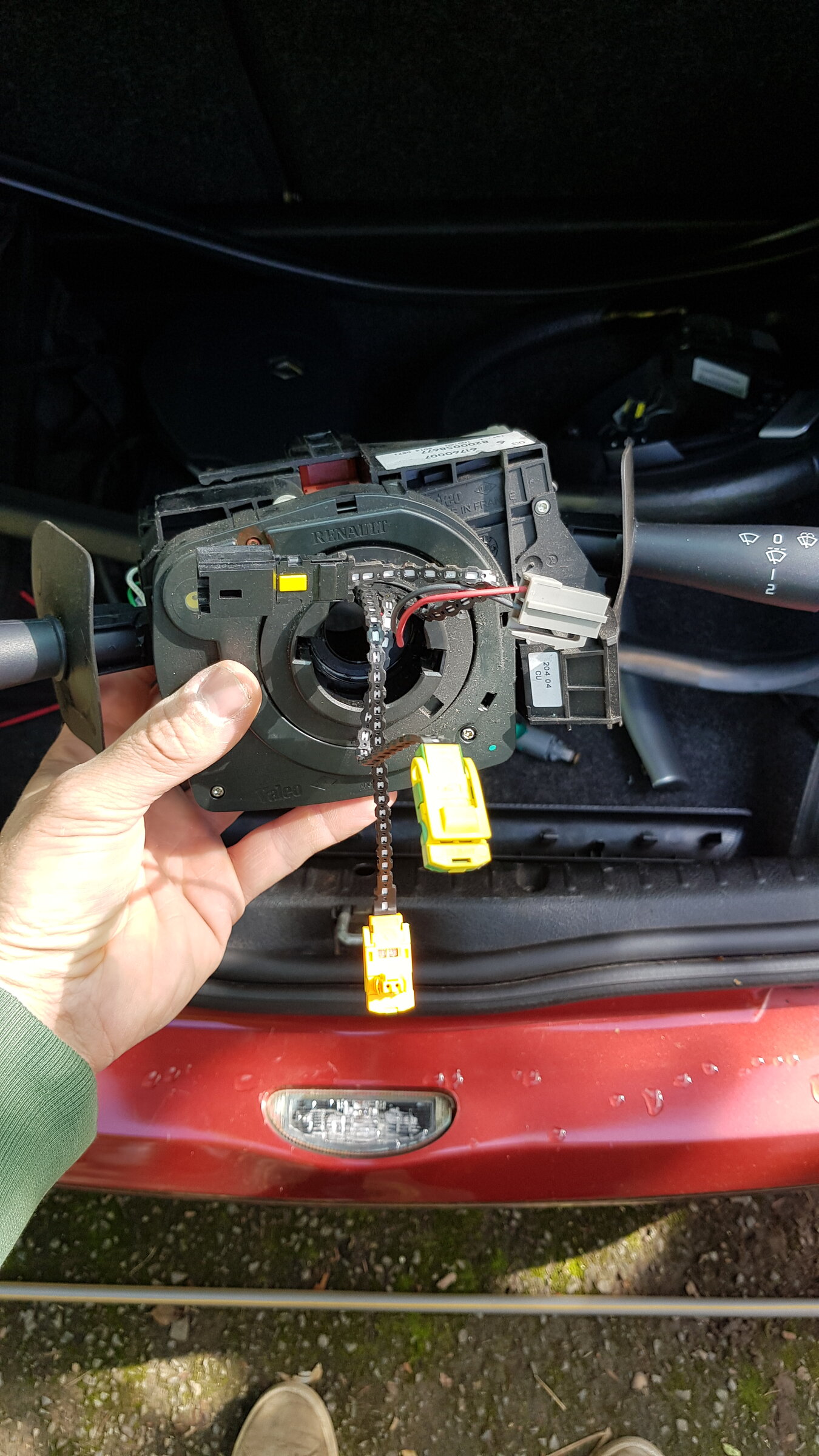

This is what I have at the steering wheel end of things

I didn't buy another loom, sorry not 100% sure on the wheel as I have the OMP wheel now. But looking at it it's straight forward plugs. The grey plug is horn, black one is cruise I would say, and obviously the two air bag connections.

Yeah I've connected everything up at the pedal end and panel, just need to pop the wheel off to do that bit

Just out of curiosity did you need an additional brake switch?.
I picked up both switches from a 182 but mine had the brake switch fitted and connected up. The clutch switch I got had the wrong connector so I've used the brake switch which I believe will work. I'll report back on that🤞

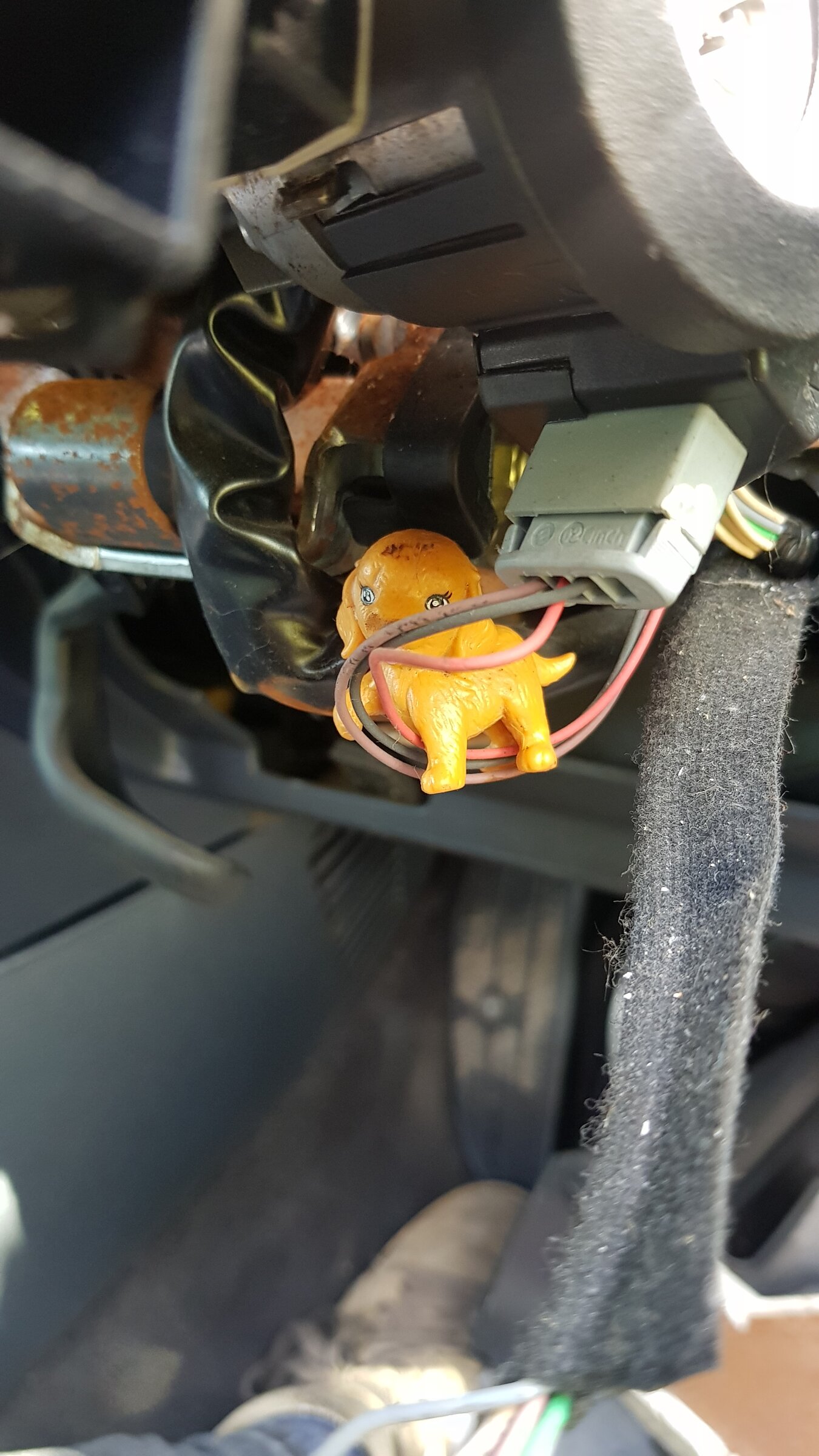

Been for a drive, all works perfectly,
but better than that I now have a new friend. I found this sat wedged in the wiring under the steering column.
