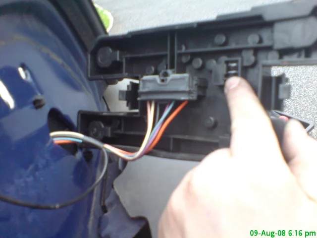

Hi all as in the title, my reverse lights arnt working...... ive changed both the bulbs with no results... the car is an old 1998 R reg clio 1.4RT.

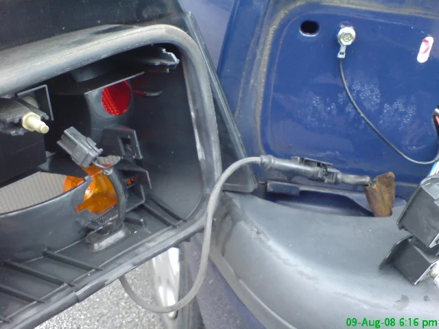

ive taken some pics of the passenger side rear light unit and there is a wire running to it that is separate to the main light loom is that anything to do with the reverse lights?
What if anything can i check to see if i can get them working again....

Probably find that the reverse light switch on the gearbox has failed. Its near the passenger side driveshaft seal on the gearbox, it has a green or brown connector.
  172
There not much, motor factors should have them in stock. Its a 2 pin connector, so its easy to test if its working. Also check the fuses before stripping. Cant remember which fuse the reverse light works off, dont think it has its own seperate fuse tho. Would be in the passenger footwell fusebox.
