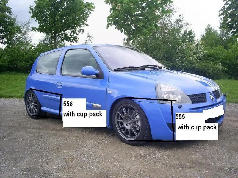

hi all i want some Eibach Springs , but if some one as them fitted to a 182 full fat cupped could thay please give me the ride height from the bottom of the wheel 16`s to the top of the arch please , mine are 555 mm front and 556 mm
rear . i'm told Pros lower by 5-10mm and sports lower by 30-35mm
but my car is cupped so i think is 5mm lower than standard .so if sone one
can measure there ride height that would be cool . for the pro's and sport .:dapprove: thank

Get sportlines mate. Wont notice much difference with pro's if you already have cup pack. Sportlines will only lower by 25mm approx, but will improve handling lots.

Prob about 25 mm, still a biggish gap between wheel and arch.

The pros dont lower the car really at all, where are the sports do realistically about 30-35mm.
Ive got the sportlines, find the ride hardly any harder then my non cup set up but it now handles much better......... and i live in a mine field of crappy roads and speed bumps and not once grinded or scraped anything..... tbh, i dont really see the point of the pros but ive not tried then so cant comment fairly, just know they hardly lower it.

lol! @ measuring from the arches. The cars are all bent as they leave the factory! ;)
