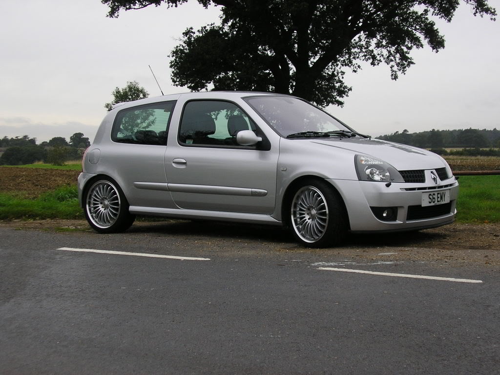

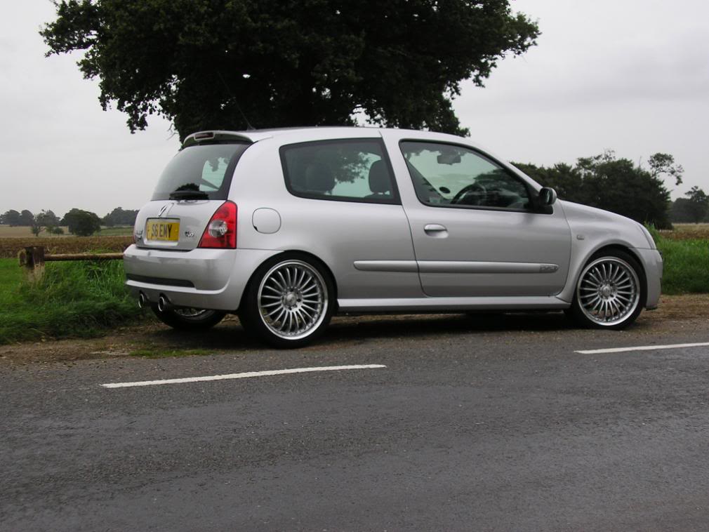

Erm i would say no ... well not without it looking like a 4 x 4 anyway. I've got 17's on mine and super skinny tyres with coilovers and that was a squish. 18's i would say you wouldnt be able to turn the front wheels and would get major scrubbage on the rear without starting to cut things away. Would defo need to change the suspension too i would imagine.
Saying that, I would like to see it done (properly!)... I think mine looks schweet on 17's but wouldn't wanna go any bigger.
Well mines lowered on coilovers, not sure by how much but quite alot, almost on the lowest setting. The suspension needs to be quite stiff with big wheels to prevent scrubbing.
