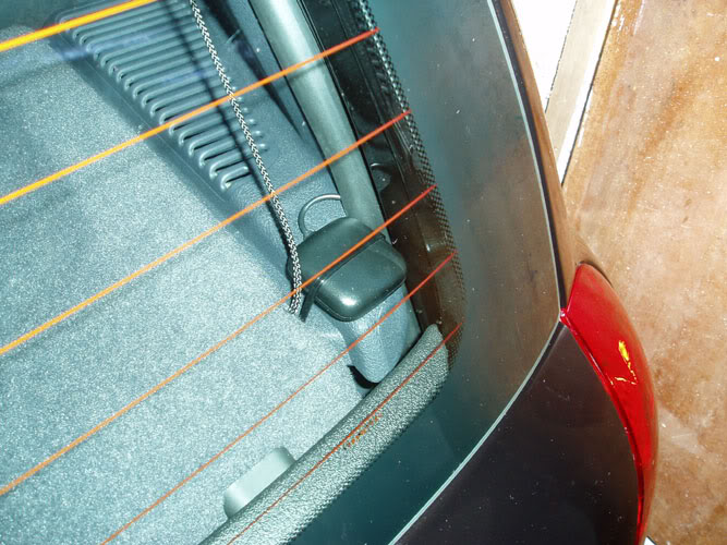

the gps arial coud do with been at the rear next to the parcel shelf, thats where ive seen others mount them.

Mine RA2 worked ok at time there at times, but others not, but was to low down for the laser detector to clear the wipers. It also dropped signal alot on the move and took a while to pick up satelittes at start up. Ended up getting the additional attenena from blackspot. Ran the cable down the dash, sill, rear quarter and placed it on the ledge next to the parcel shelf. ( You need to ask them for the 5 metre one to do this). Works 100% at all times now and as well as it did in my 205 GTI which a normal glass screen.

Brilliant! Thanks for the pic as well. I've got the RA2, but I've already received the 2m aerial the other day. At the moment, with the aerial in that small square, I'm getting exactly the symptoms you described.

With the shorter one you may be able able to mount it in the rear quarter window area. I was sent the 3m one first even though 5m one by mistake at first and it reached that far.

as r jay said thats where mine is. I had the 2 metre one but couldnt get decent signal, wire just too short to mount it anywhere decent enough. Ask them for the 5 metre one, same price anyway.

It was on this mans advice I mounted mine where I did. You need to speak to Blackspot about the 5m as it is not listed on there site. Saying that I phoned and ordered a 5m one but still got sent the 2m one! They sorted it easily enough after a phone call though.

aye, it was after a lot of messing around that I found this spot for it. It's the best place as its out of the way and you cant see the wire.
And it means its still high enough to "look" over the wipers for those pesky laser beams...

Well I phoned up and got the 5m aerial in the end, and I've run it to the parcel shelf and it works ok now - would still like it on the roof though!

Works fine on the shelf as well as it used to with the unit standalone in my old no hear reflective screened car.

I also have an Origin B2 installed but instead of going to the hassle of getting all the bits off and going through to the engine to put it in the same place as the satnav one I run it from the drivers footwell, under the door rubbers, under the plastic door card thingy with the speaker in, in the rear, into the boot area and on to the plastic shelf at the side of the parcel, exactly the same place as in the picture above.
