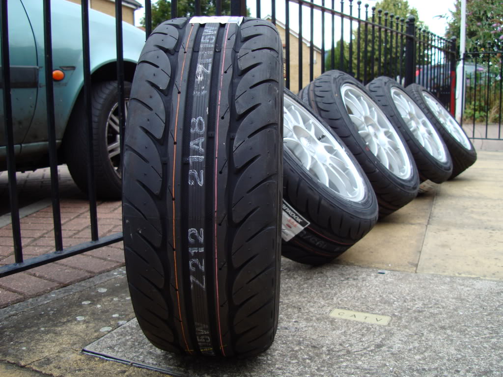

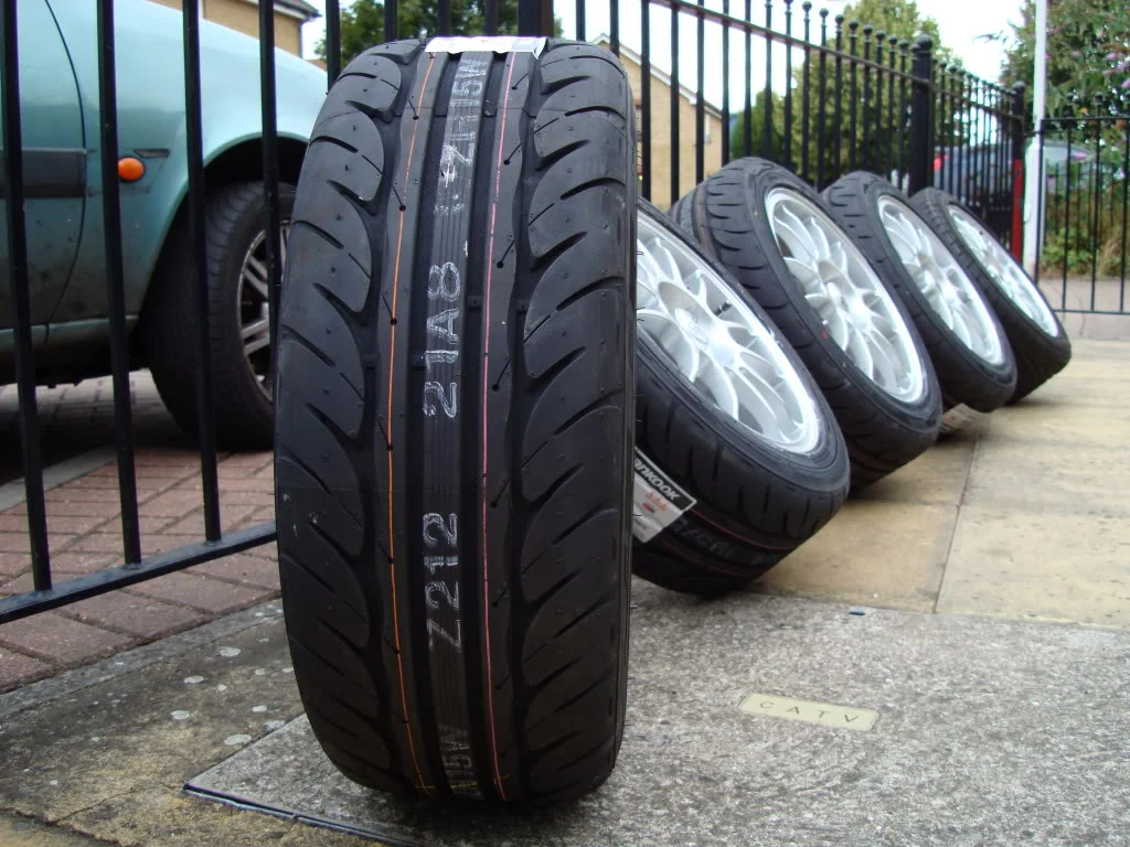

Hankook Rs2's or Federal RSR's.
Both are road legal so stick on car drive to circuit & back again.
Leave mine on from March till it gets too cold.
Done a good few road miles & will be 4 trackdays since April still wearing even & plenty of tread to go.
My avatar is my tyres.
