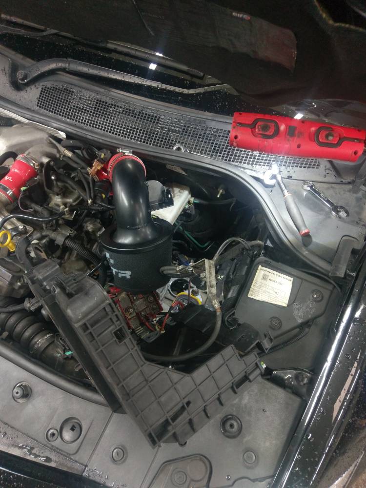

I've made a fair bit of progress this evening!

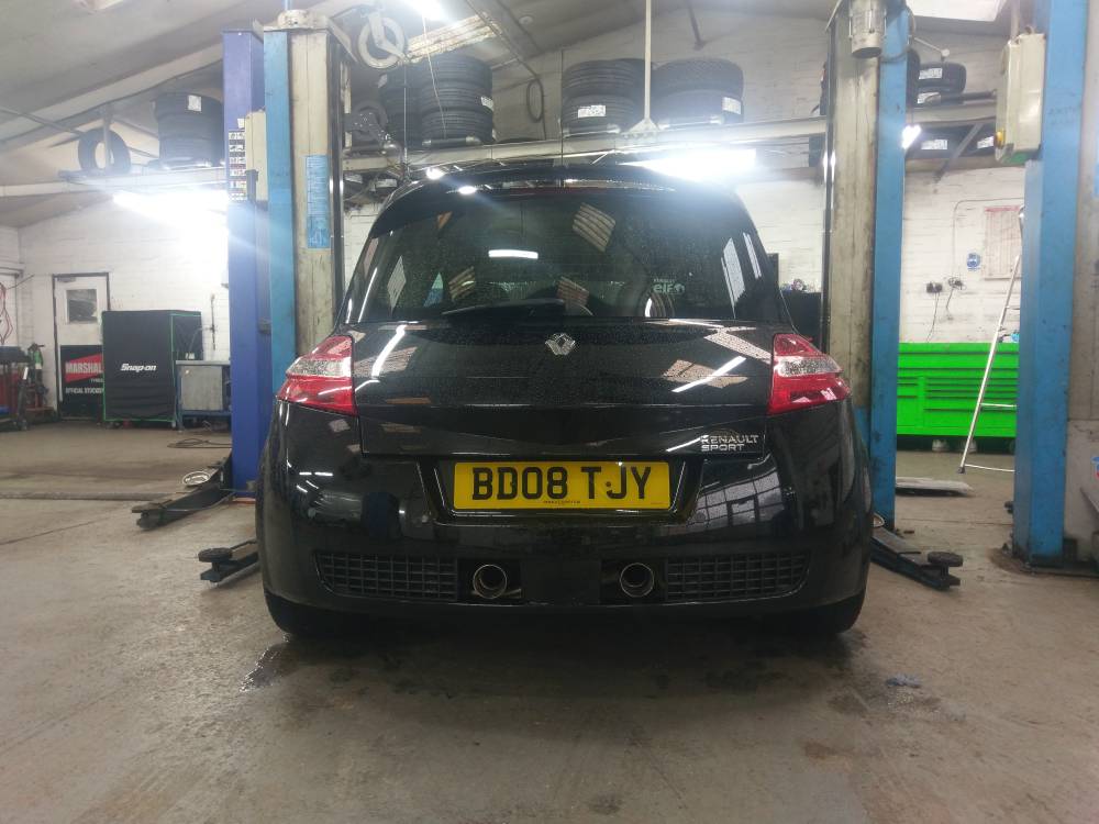

Milltek exhaust fitted, which has given the car a much more purposeful sound. It's only cat back for the time being but I'm looking forward to hearing the results of a decat pipe!
Also fitted this evening was a KTR induction kit coupled with their enlarged intake hose. I know the gains realistically are minimal, but it just sounds so bloody good! Completely changing the character of the car.

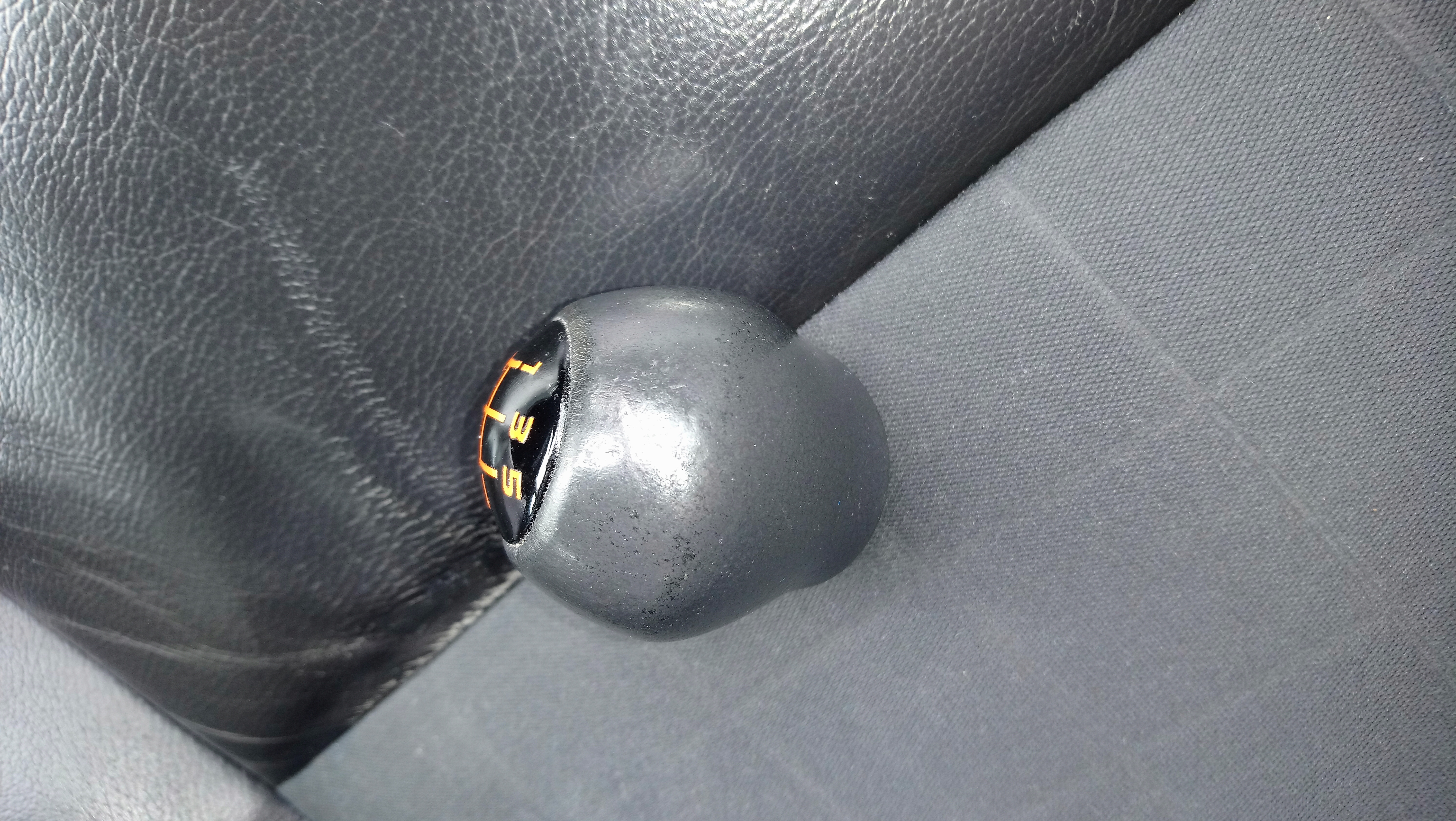

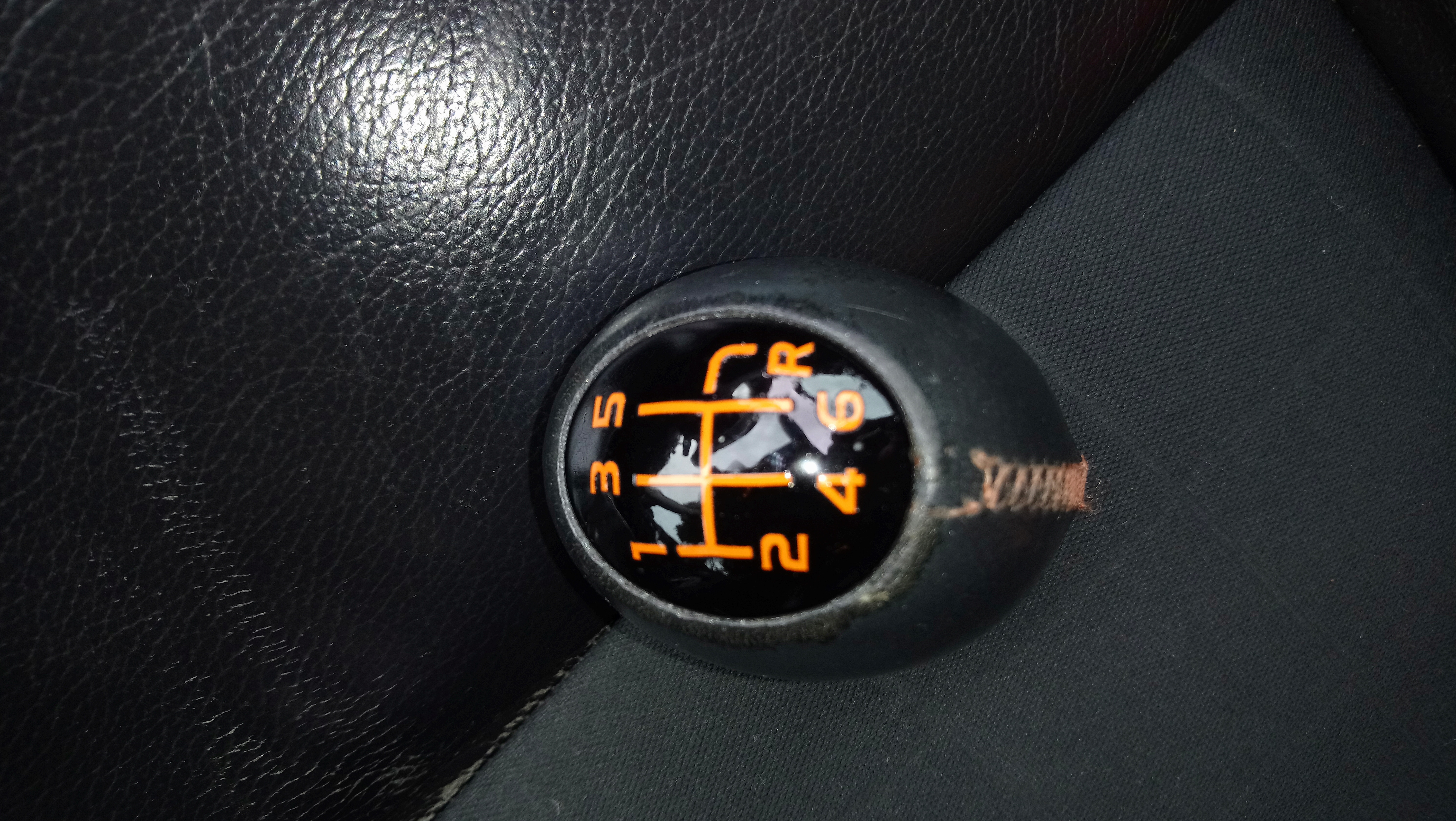

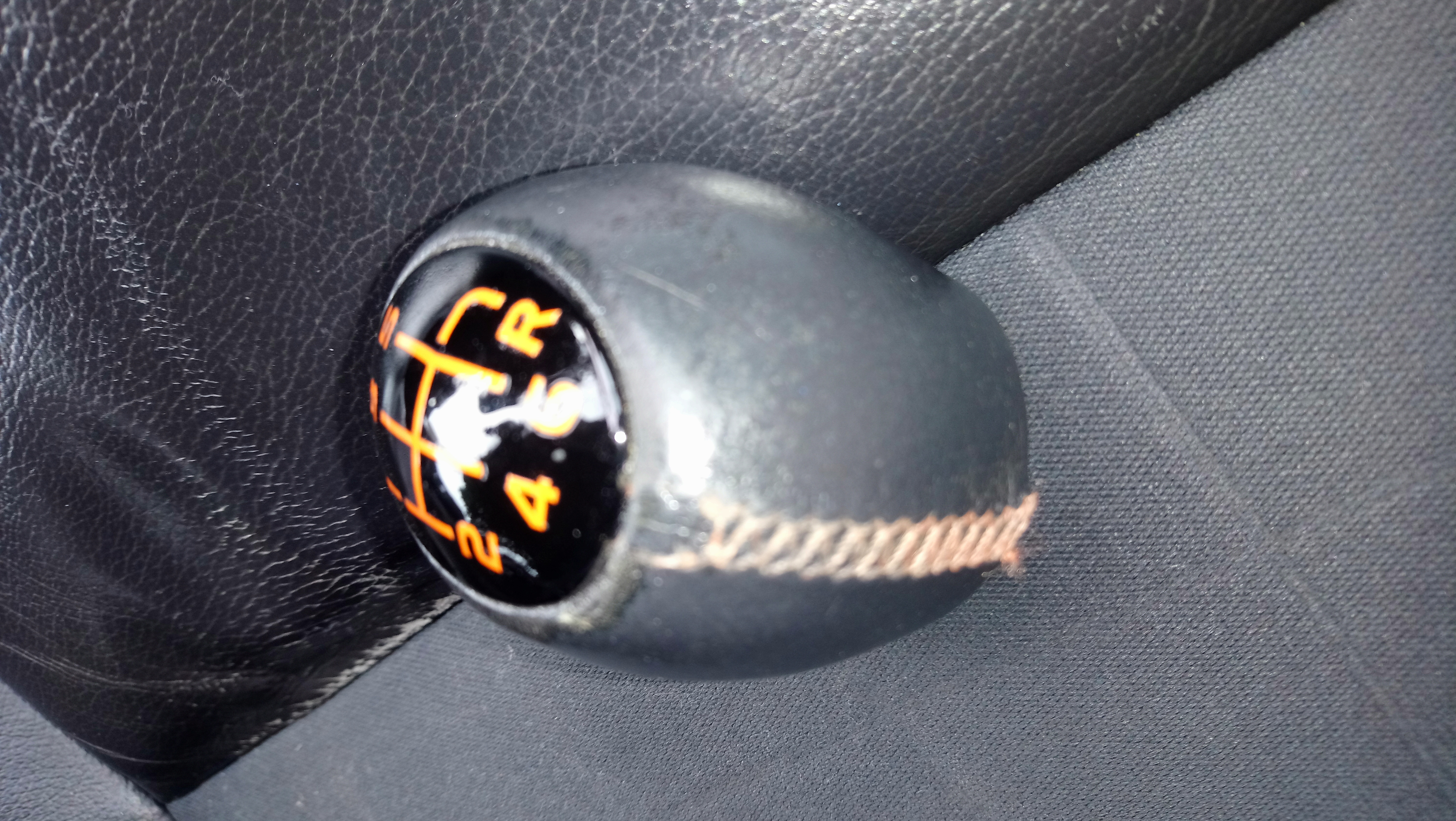

Where is a good place to get a new gear knob for the R26 do you know?
Do you mean aftermarket or new Renault one. If it's aftermarket then there isn't a huge choice. I opted for a Richbrook top gear multi fit one, £30 from halfrauds in silver or in black online. Comes with different tops you just interchange.
If it's an oe renault one then you can have my old one for a few quid. It's got orange graphics on it as mines an inferno colour.
I can grab some pics of them in a bit if you want?
Cheers james
  RS Clio 182
Cheers james
Yeah il have a look..although mine is LY hehe. I saw someone put a specialist trim guy on here but i cant remember the name.

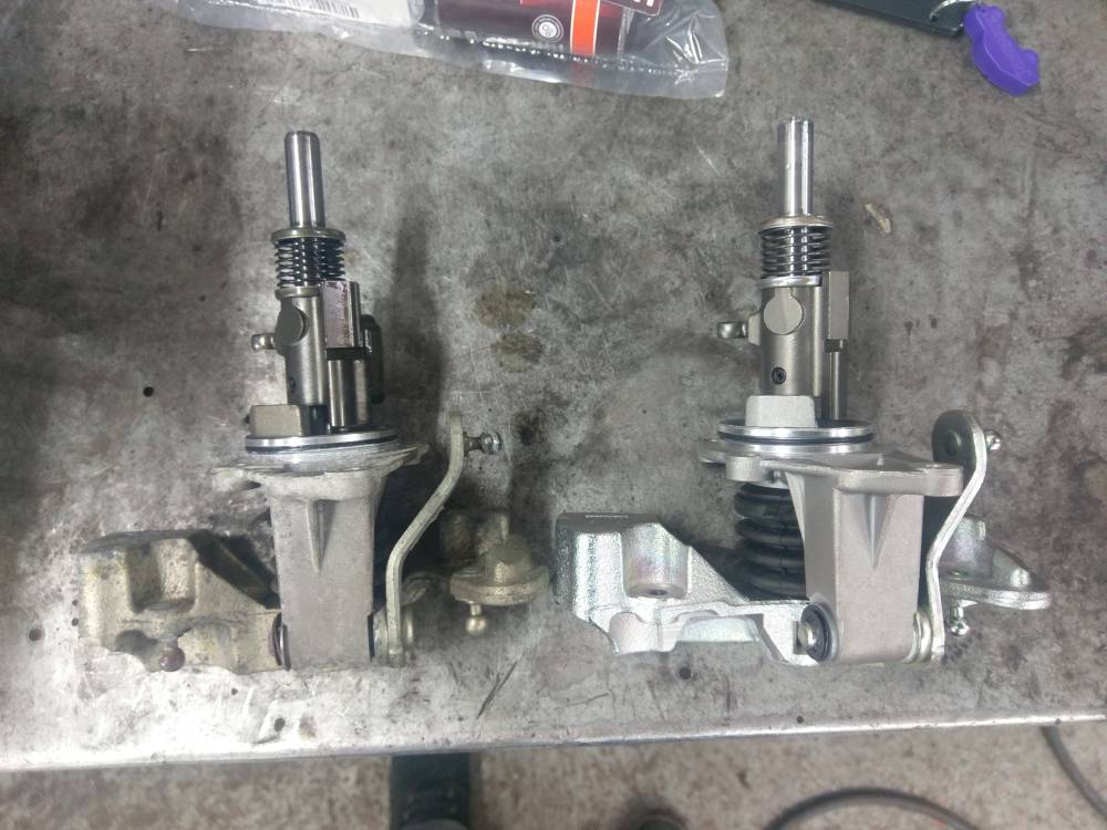

Oh what fun I've had this evening!

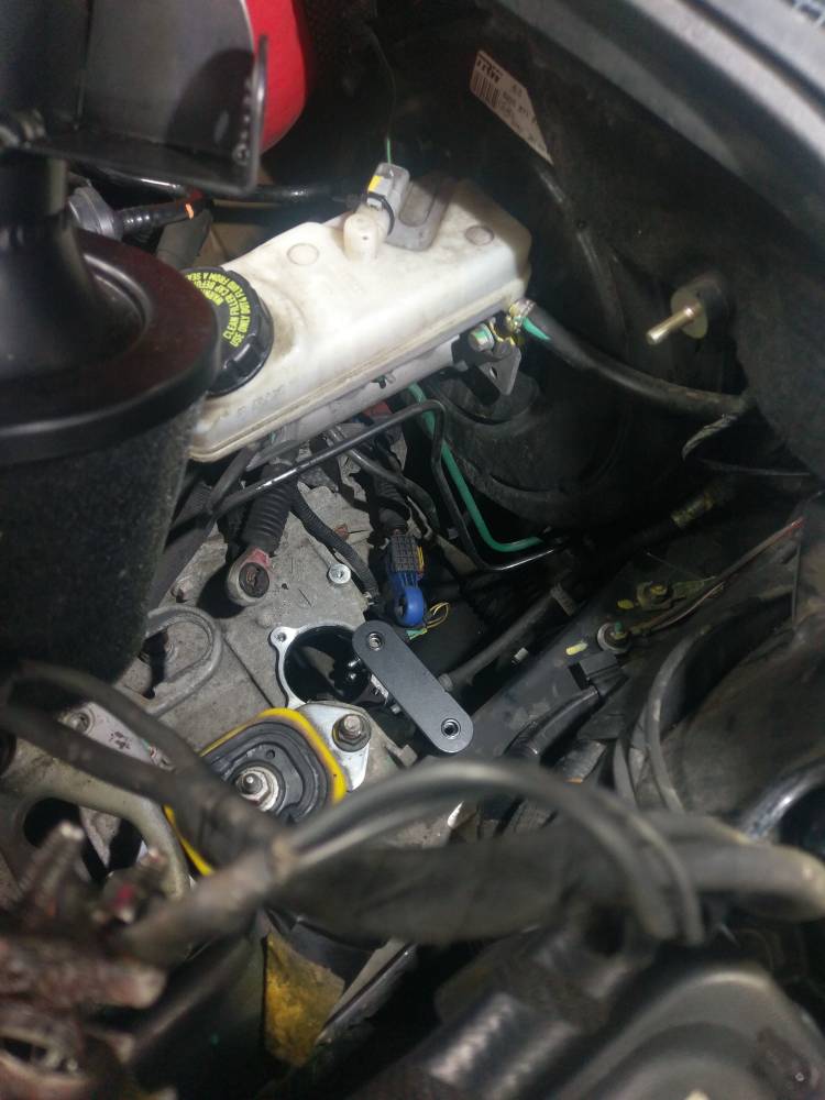

I received my gear shifter today, and went to fit it after work this evening.
Unfortunately I ran into a problem and only realised there was a fault with the shifter when I'd already removed the old one!
If you look at the photo, on the left hand side of the selector I presume there should be a ball joint that one of the cables would connect to?
I can see on the new shifter where it has been machined, and a hole has been drilled with a thread but there's nothing there.
I've emailed K-Tec this evening so will hopefully get a reply in the morning! [emoji30]
After much swearing I refitted the original shifter so I could actually drive home...

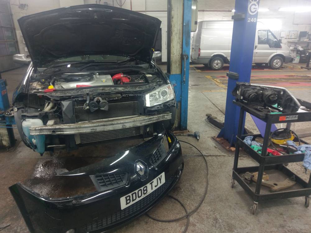

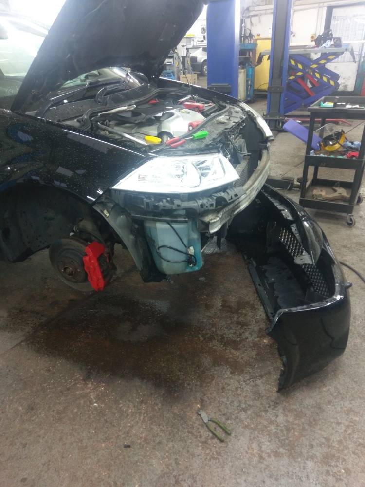

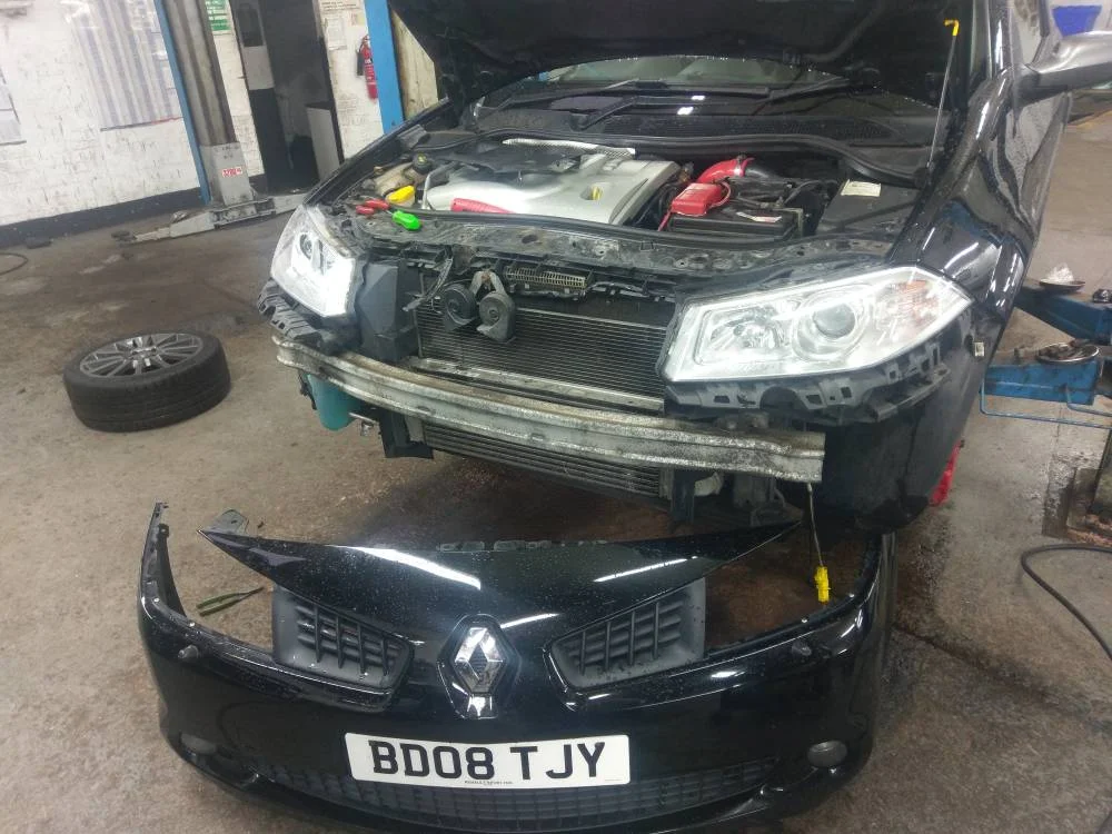

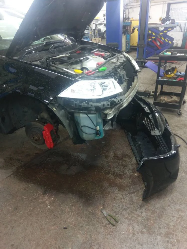

I decided to tackle a job I wasn't overly looking forward to, but it wasn't actually that bad.
I have amassed quite a collection of Osram upgrade bulbs so turnes my attention to the front end. I attempted to use the 'covers' inside the wheel arch to gain access but unless you've the hands of an infant they're useless!
In the end I thought 'f**k it' and just took the front bumper off. Which made things much easier!
I forgot to take photos of the end product, as by this point I was shattered, but they are a massive improvement.

Yep missing a ballstud there.
I can't imagine how frustrating that was.. I've learnt after years in a bicycle workshop and receiving incorrect parts to check before taking old stuff old as otherwise tools could be heard thrown across the workshop followed by many expletives.... :-D:-D
Hopefully ktec will just send a ballstud out sharpish and a freebie for your time like a an induction cleaning kit???? ;-)
RMDavis
Yeah I wasn't best pleased mate. I was just going to leave it and walk home, but it was pissing it down and would of also been a pain pushing it round the workshop this morning.
I like your idea on the free cleaning though James, good shout! :wink:

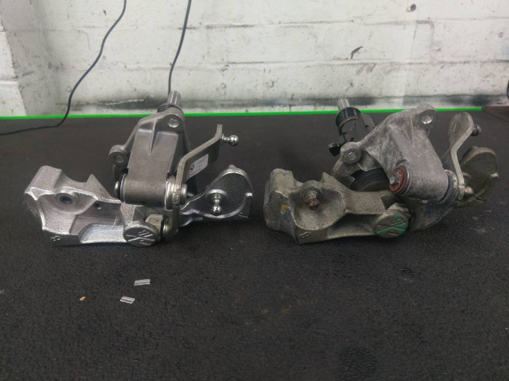

Finally got the new shifter fitted last night!
K-Tec sorted out the missing ball stud, but they did need to send two after the first one went missing through a little hole, so I was essentially sent an empty envelope! [emoji23]
After having a little experience with this job it went without any problems apart from one of the battery tray torx bolts decided to round off...
It was worth the effort though as the difference in gear selection is phenomenal! I urge anyone with a Megane to consider this modification, as it improves the driving experience no end!

S'good innit!
Completely changes the drive imo.
