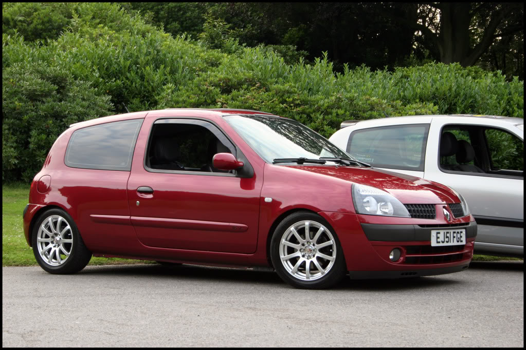

Ive got these on my 1.2 after having 40mm for just over a year. For the price you really can't complain! They gave me some lows and the ride can be rough, but not the point where id get rid of them. You can deck the front, I've got mine as far as its save to where I live. The rear is as low as it will go with the adjusters, but you can take the adjusters out if you want abit of an extra drop. Failing that get custom rear springs. I'm very happy with them and have had them for almost a year now and they haven't failed me yet. Even went to the Isle of Wight with them for a week and they were fine, if very rough! You'll prefere them to springs though mate.
Mine at its current height:

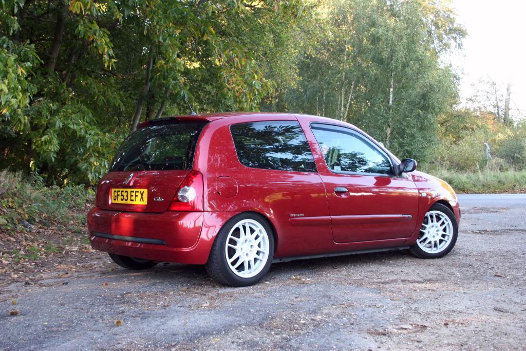

Littlegh's Clio on here, he's taken the rear adjusters out, so you can see it sits a little lower than mine at the rear:
