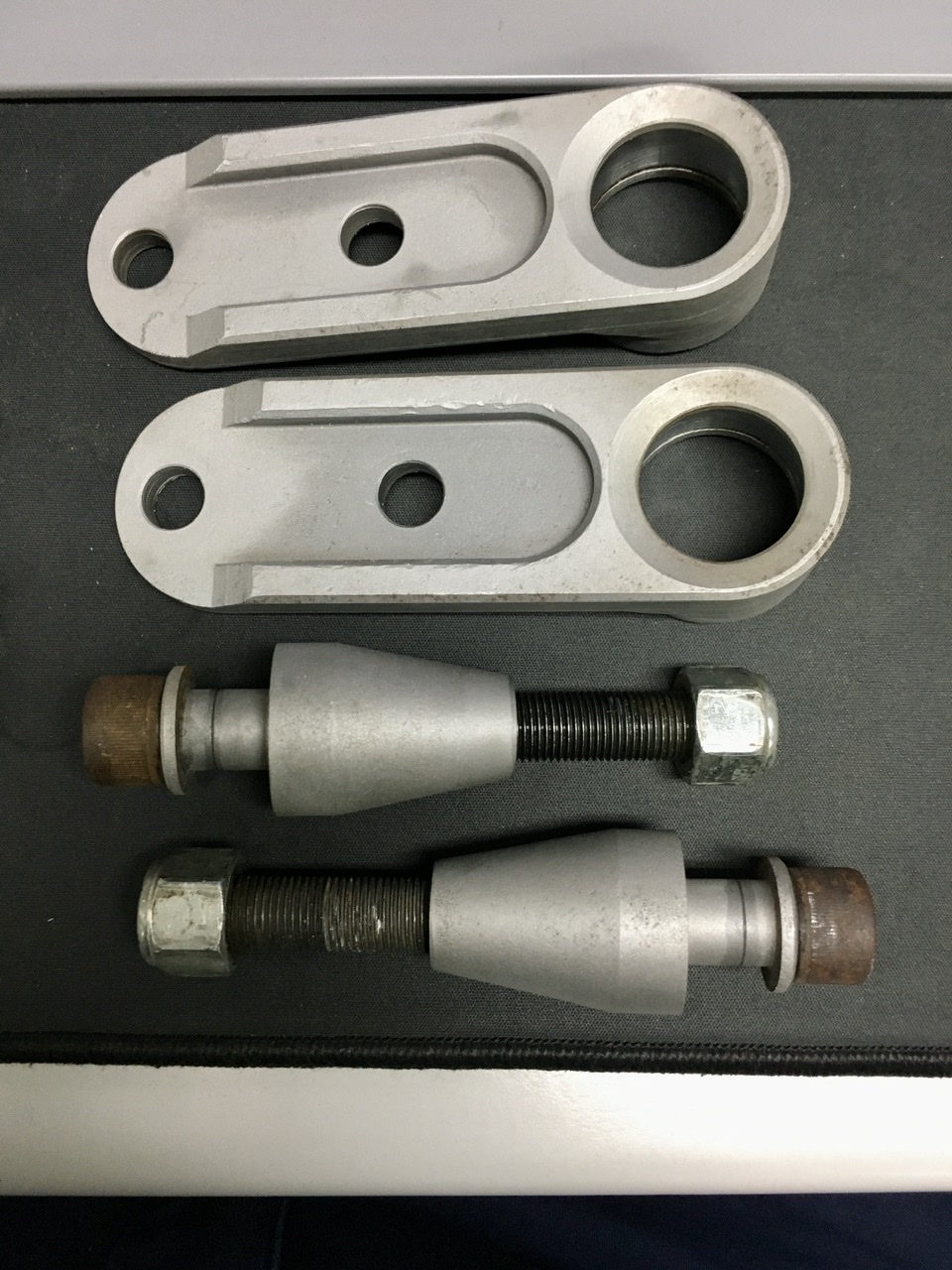

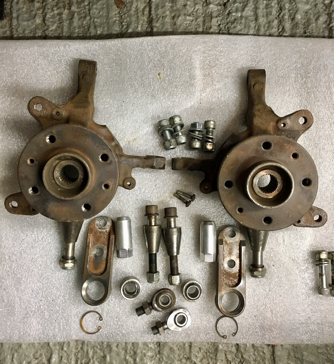

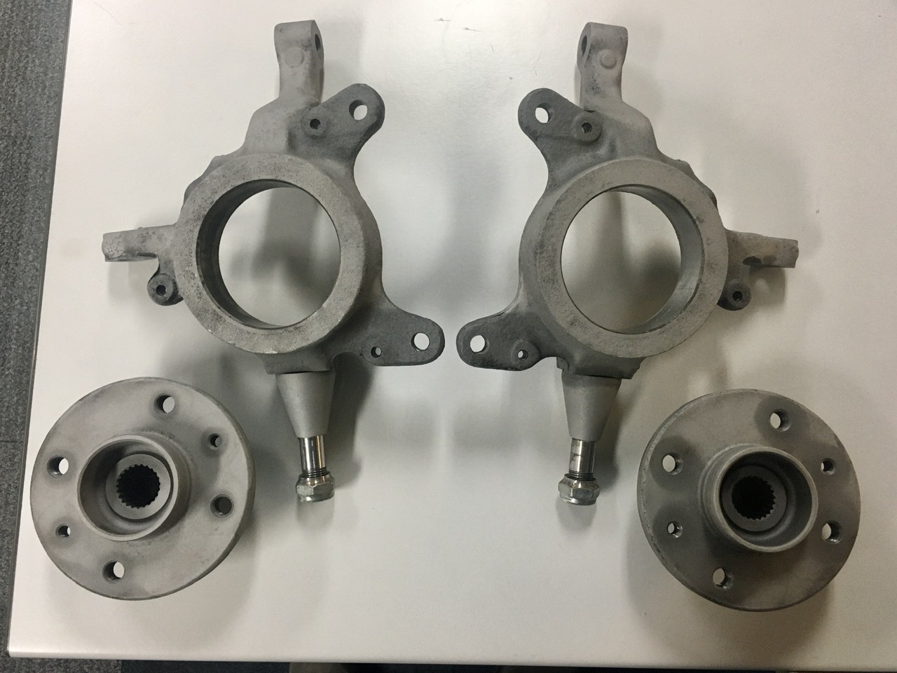

Just to keep this updated.
Hubs when they arrived, now stripped blasted ready for plating/coating.
New SNR bearings on the way with new bottom ball joints and rod ends.

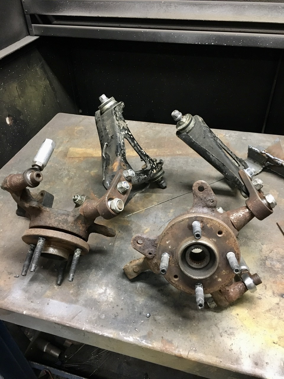

I literally bought myself a new daily as I wasnt happy to use these through winter 😂
I had them on the car for a couple of months and already they look a complete mess. Work fine still, just covered in rust.
Going to clean them up and paint the bits I can, may even fit new bearings for the sake of it.
In terms of comfort in a daily, I barely noticed a difference between these and standard setup.
