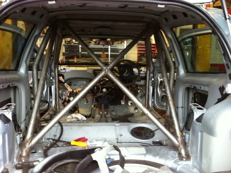

I'm going to see the final stages of my Oreca Race cage being fitted tomorrow. By all accounts it's gone in really well without to much hassle. I've paid someone who knows what they are doing to fit it properly.
I'd question the need to get a Race Plus cage unless you were very serious about going racing, even then it's a bit on the mental side.
Here is mine as of a few weeks ago (harness bars and door bars still to be fitted).

that oreca cage does look abit mental,maybe have to have a re think,but it does look so good.
how long has it taken to get it to that stage?
