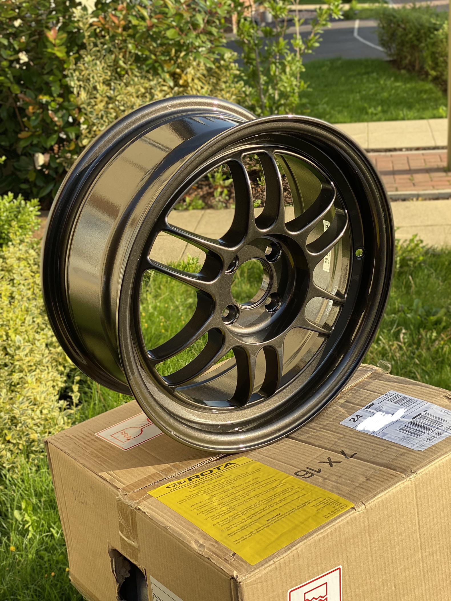

I’ve had all the usual wheels you’d find so I wanted something different.
they arrived today and I’m very pleased. Will keep you updated once they’re back from my detailer for a ceramic coat and tyre fitting

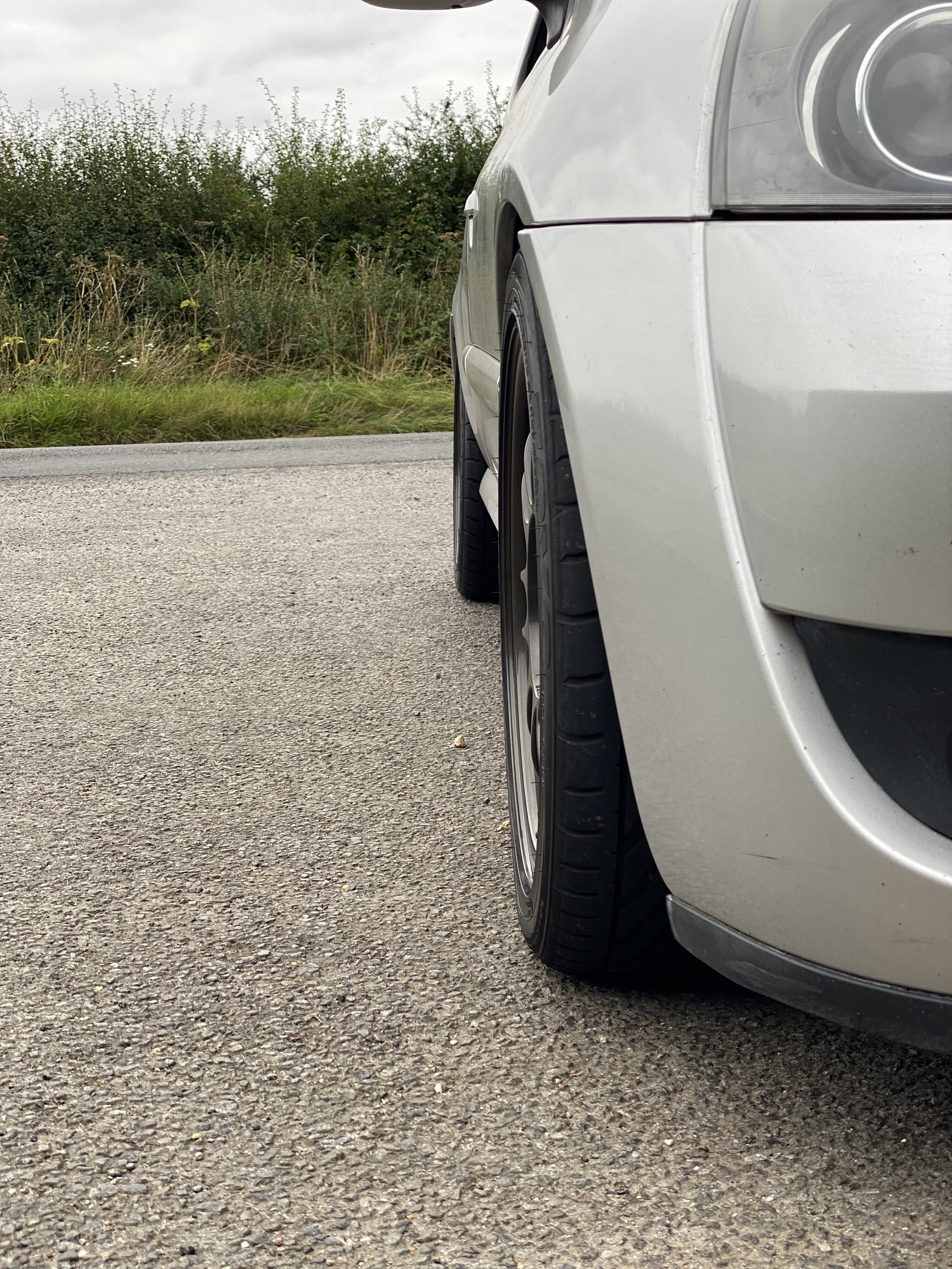

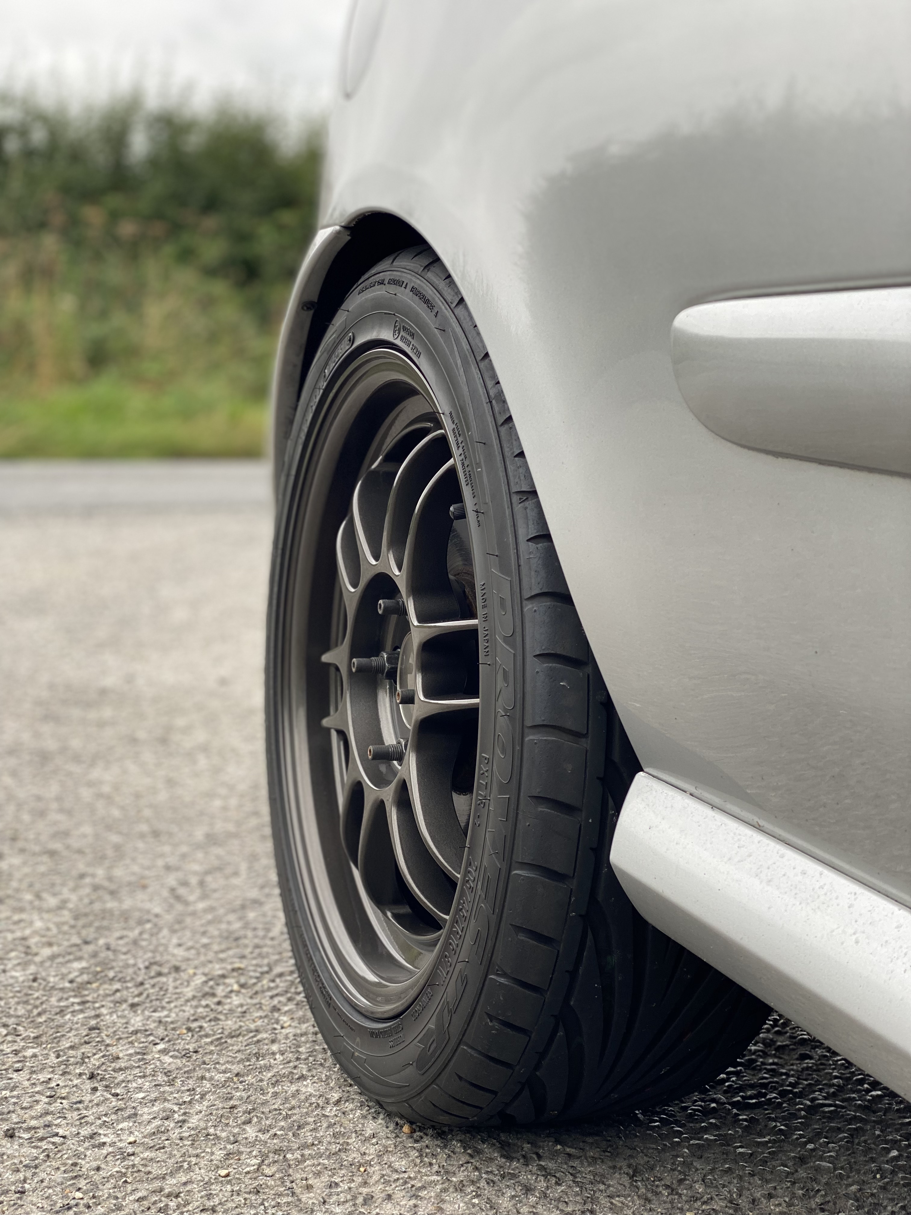

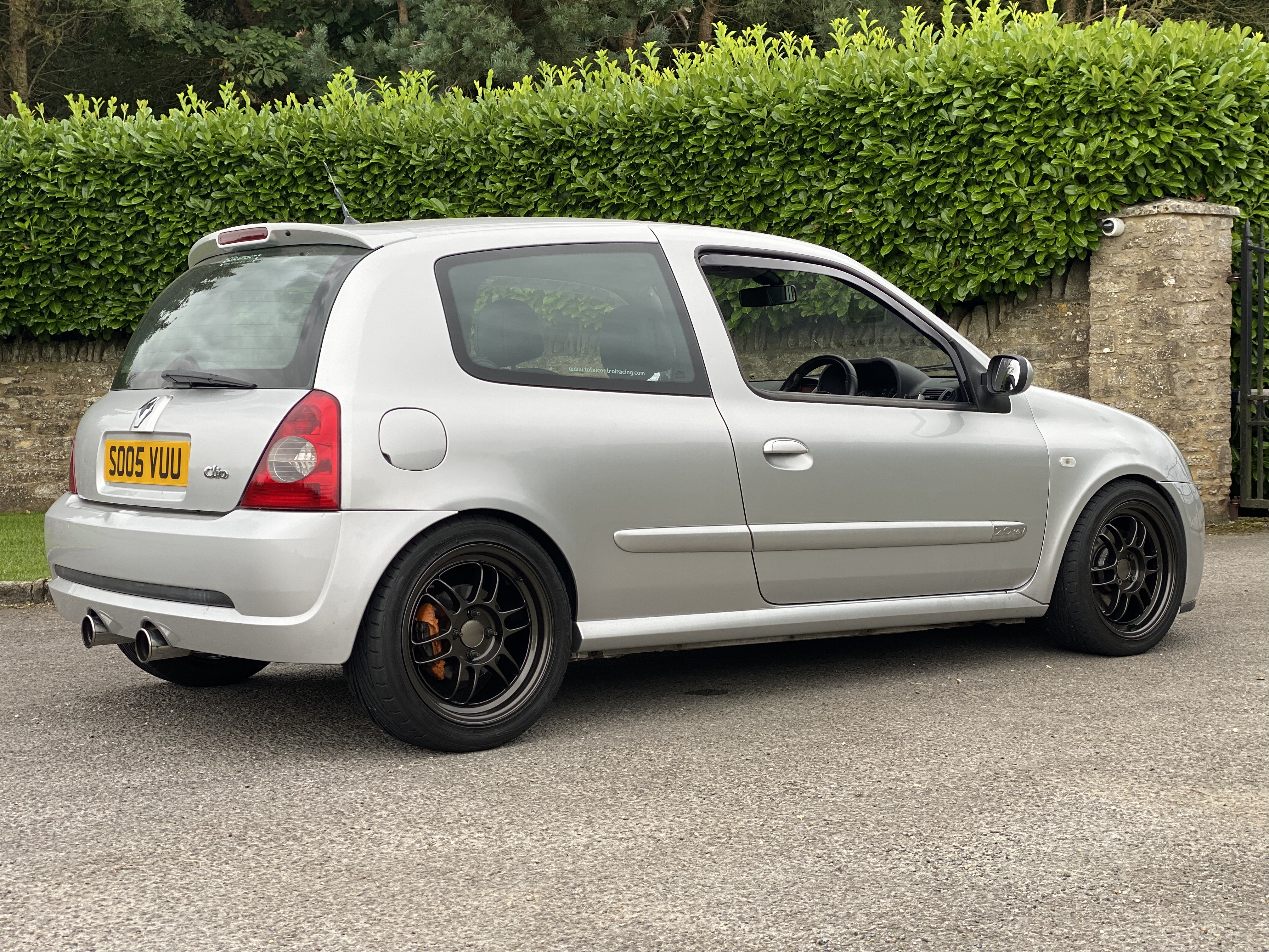

Got them on finally. I went with 16X7 ET 38.5, the needed spigot rings but that was it. I ceramic coated them inside and out and fitted some 205/45/16 Toyo Proxes T1R. 18mm PMS front hubcentric spacers and rear 10mm PMS axel spacers. I like the fattier look of the tyres at this sizes over the stiffer looking side walls of AD08R’s for example.
No rubbing at this height either so may drop the front a tad but very happy with them and they’re super light too!
