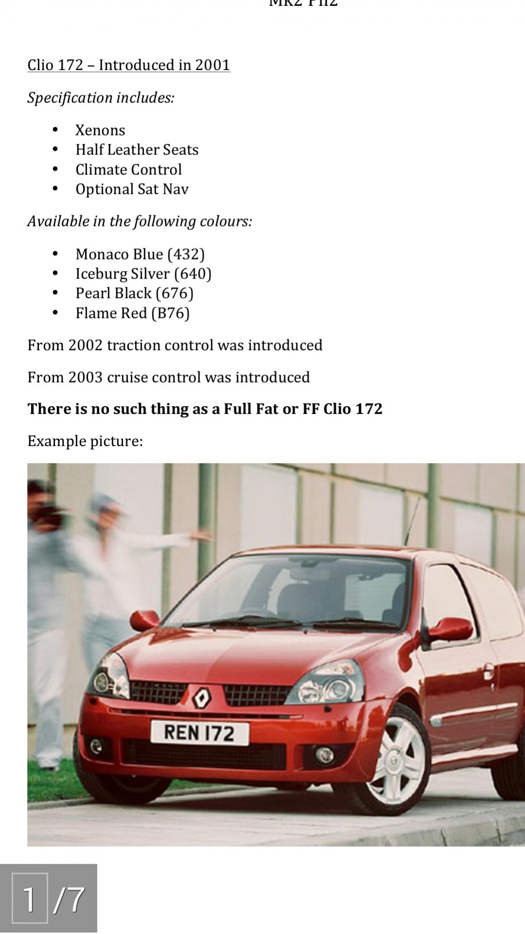

Thought there was no such thing as a 172ff??
According to who?
There is NO such thing as a "Full fat" anything, its just a slang term used on forums, and the first times Ive seen it used were about non cup 172s
I have also seen people use it to describe a 182 with both cup packs as well, but neither definition is other than what people want to call it as it has no actual renault meaning.
  2002 clio 172
According to who?
According to the author of the thread that's been made a sticky on here that I took the screen shot from. I'm not a Clio expert, just going off what someone else has posted.
  2002 clio 172
According to who?
http://www.cliosport.net/forum/showthread.php?562600-172-182-Guide-Cup-Packs-Spec-Info
Also, I know full fat isn't a term that's come from Renault themselves.
