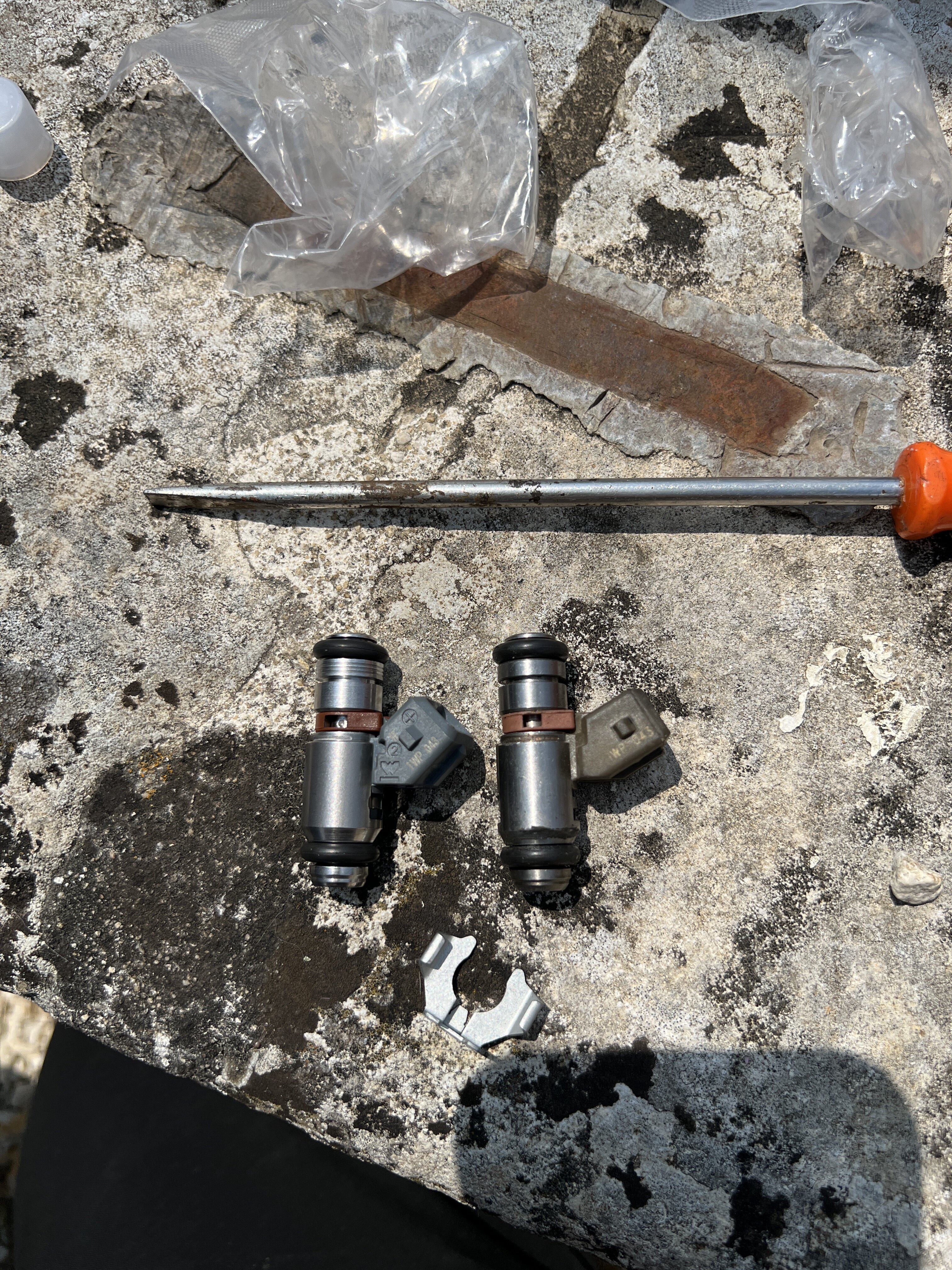

UPDATE : now the car seems to have a really feint misfire under light throttle, all is fine when I press harder on the gas peddle. Pulls fine but I just can hear and feel the hesitation when applying small throttle input. I think it’s a bad batch of e85, tried to put some more in, still the same.
I’m rooting for a bad injector. Gonna go back later today to old map and stop injectors to see if it helps.
  Clio 182 FF
Had the same problem, turns out I had fake Chinese injectors, bought proper ones and dolces the problem
you know I’ve been thinking I might have this exact issue, they’re about 1.5 years old they shouldn’t be fucked this early + I don’t actually know what brand they are. Gonna test the stock injectors later today and keep the thread updated.
I feel like my starting issues and these misfire might be connected as well
  Clio 182 FF
UPDATE : Put the stock injectors and stock map back in, it fixed the misfire AND the weird startup issue that I had, bought some genuine Magnetti Marelli 330cc injectors and all should get sorted 👌
another quick update : compared the genuine MM injectors to the fake chinesium
