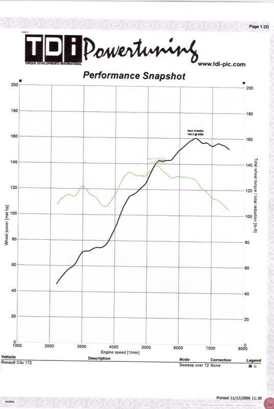

To all the people that know about RR print out's had this one done a year ago just with a Pipercross Viper Induction Kit on Cup. Does it look right and are they about the right sort of gains to see from just an Induction kit.

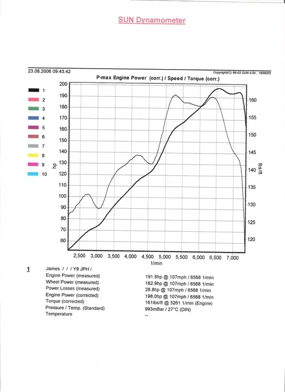

200brake cam conversion they say by their graph is 198bhp. However ive been to FOUR other different rollers now and they ALL say my car is running between 175-180bhp.
Ive spoken to the guy who set up their rollers, he says they are using all the latest software and they were 100% happy with it when it was set up.
So my conclusion to please them would have to be that everyone elses rollers up and down the country are out!
Like f*ck they are. He did say though, there are various ways where you could possibly change the results

Ring up a couple of rolling roads up and down the country and they will tell you the laws of physics state a rolling road SHOULD cross at 5252rpm.
Here is my graph after the work was completed

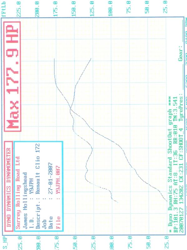

I had mine rolling roaded on a Dyno Dynamics Rolling Road(surrey rolling road) which are pretty much the most accurate rollers and best in the business, with a silenced decat and viper (without CAF last summer). Granted it was hot, but I got 169.1 @ the fly, which personally i was pretty pleased at, especially with the temperature.
Now i've replaced the silenced decat with a yozzasport decat, k-tec stealth and also fitted an r-sport, in ideal temperatures i'd like to see it 180bhp but think i'd be very lucky for much more so i'd say your reading was quite high.

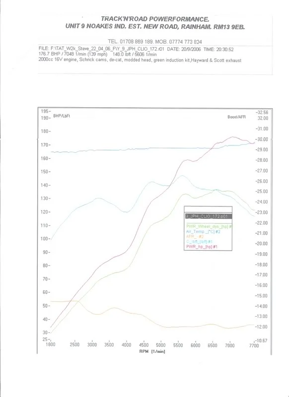

My results from the firsy rollers i went on after the cams were fitted. The guys there ALL said they could tell by the line that runs straight that the cam timing is out!
There is an issue with dyno dynamics too...Can't remember what it is. But they all read low!
This is a result from a place visited second. Now these rollers are very different as the wheels are removed and the power figures are taken directly from the hubs.
They say estimating around 18%losses the car is running at most 175-180bhp!

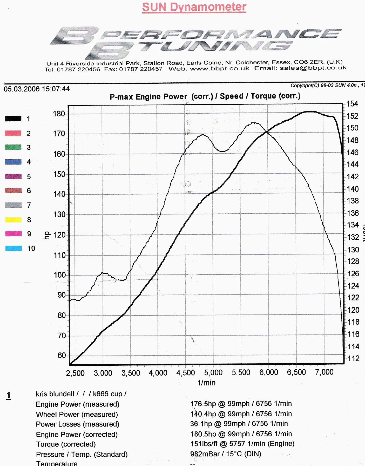

Bit strange Chris how your rolling road graph&mine from the same place look near on identical???

BB's graphs wont intersect at 5252 because the torque and bhp scales are different.
if you take the calculations from torque and convert to bhp it is correct, however that doesnt mean their actual readings are correct.

Looking at jph172's graphs, they all have broadly similar shapes.
Three of them line up with the torque peaks and troughs at around the same rpm, whereas one of them is 1000rpm higher up the scale.
I don't think anyone needs three guesses which is the odd one out!

As i said thou track n road guys all agreed the cam timing is way out&the car is seriously overfuelling.
