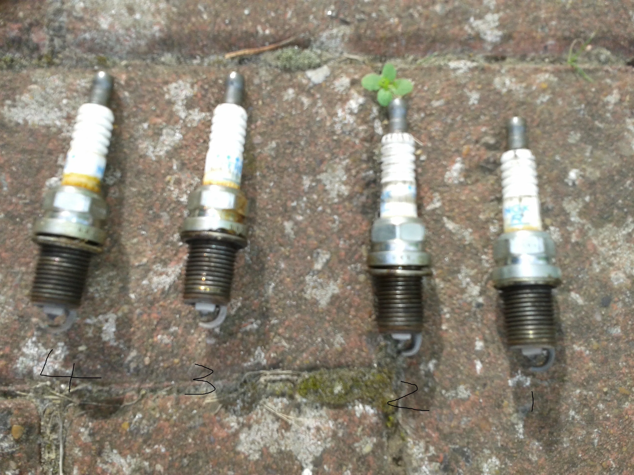

Get the proper NGK spark plugs, £40 for 4.

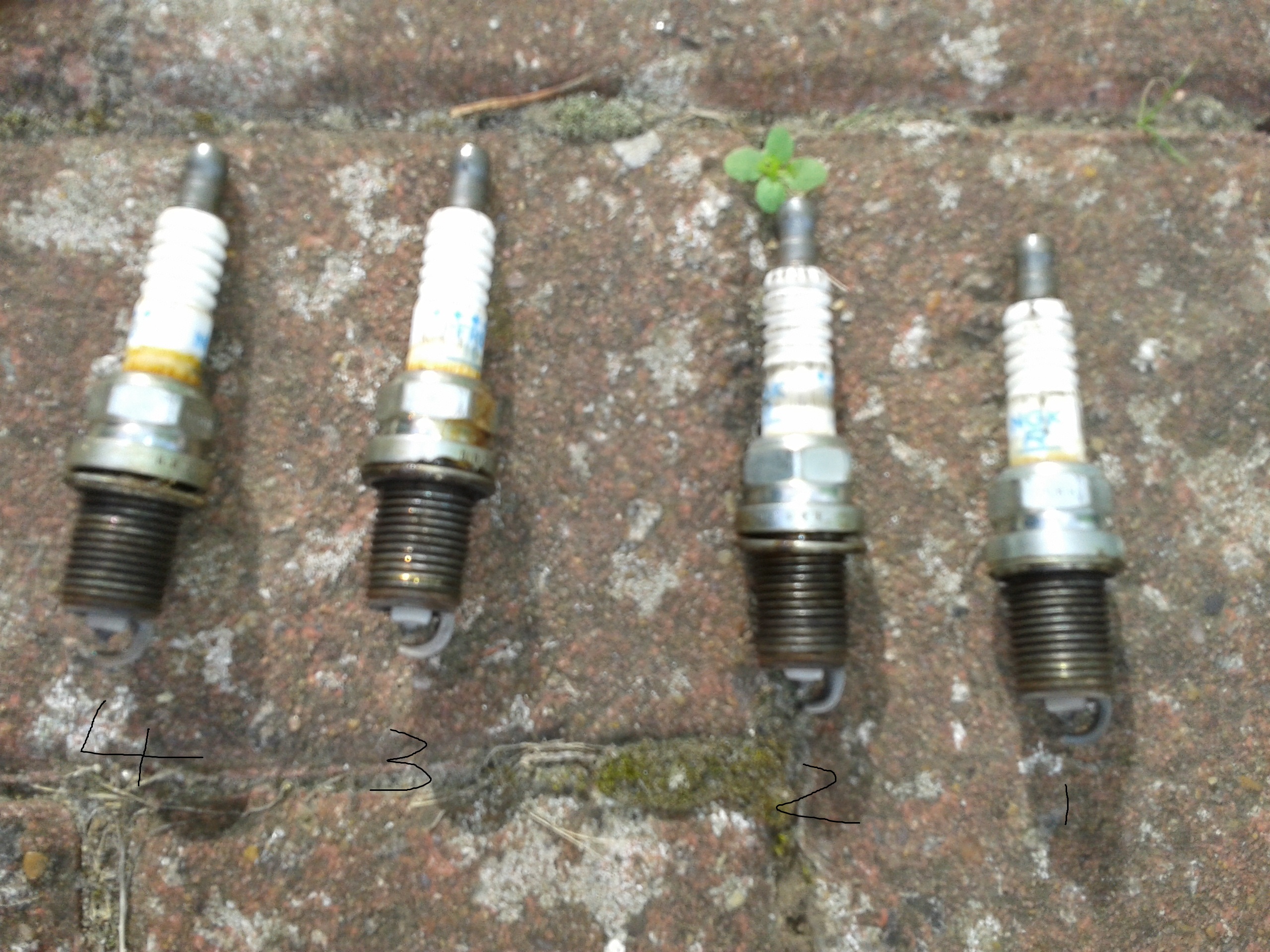

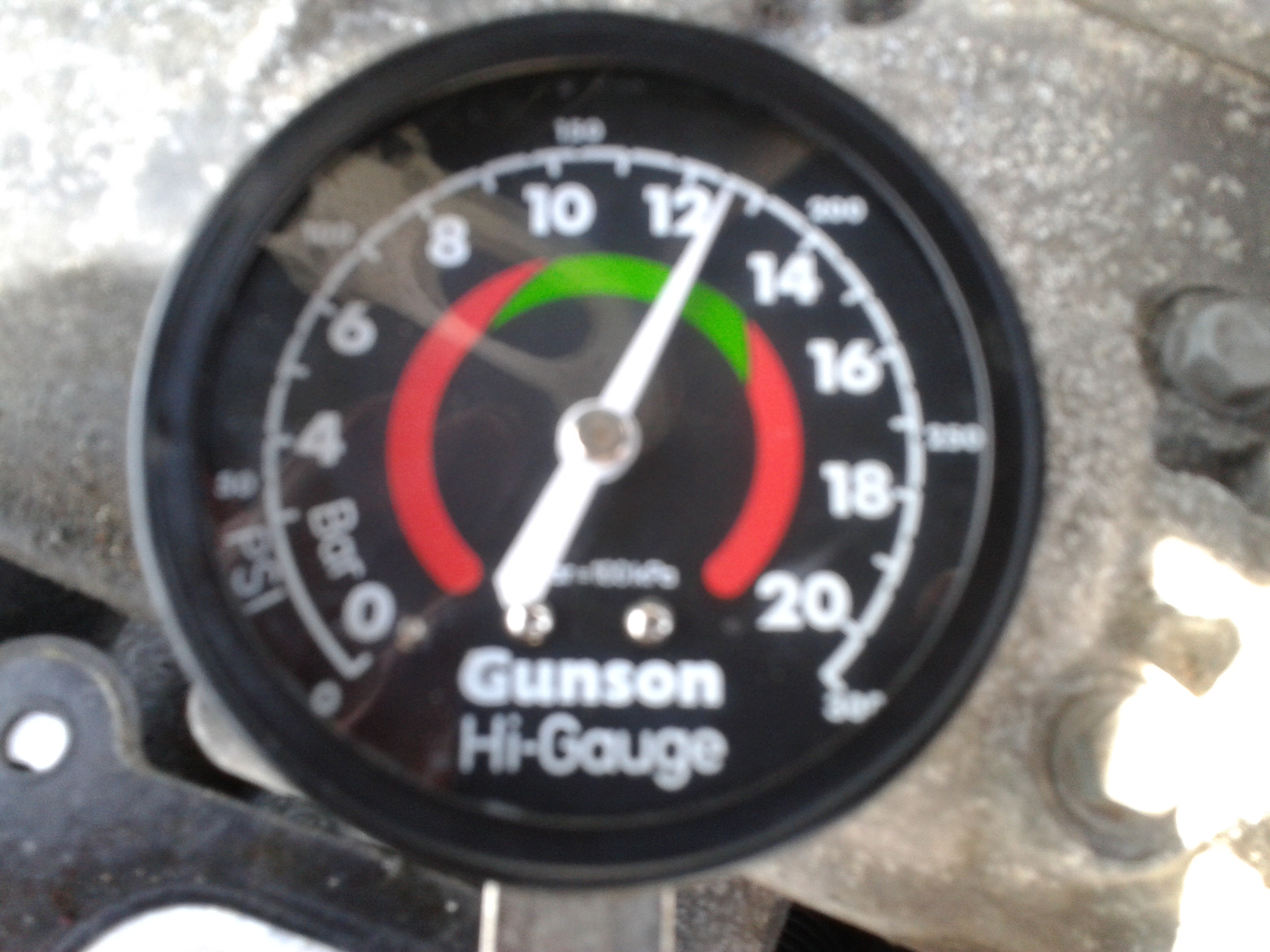

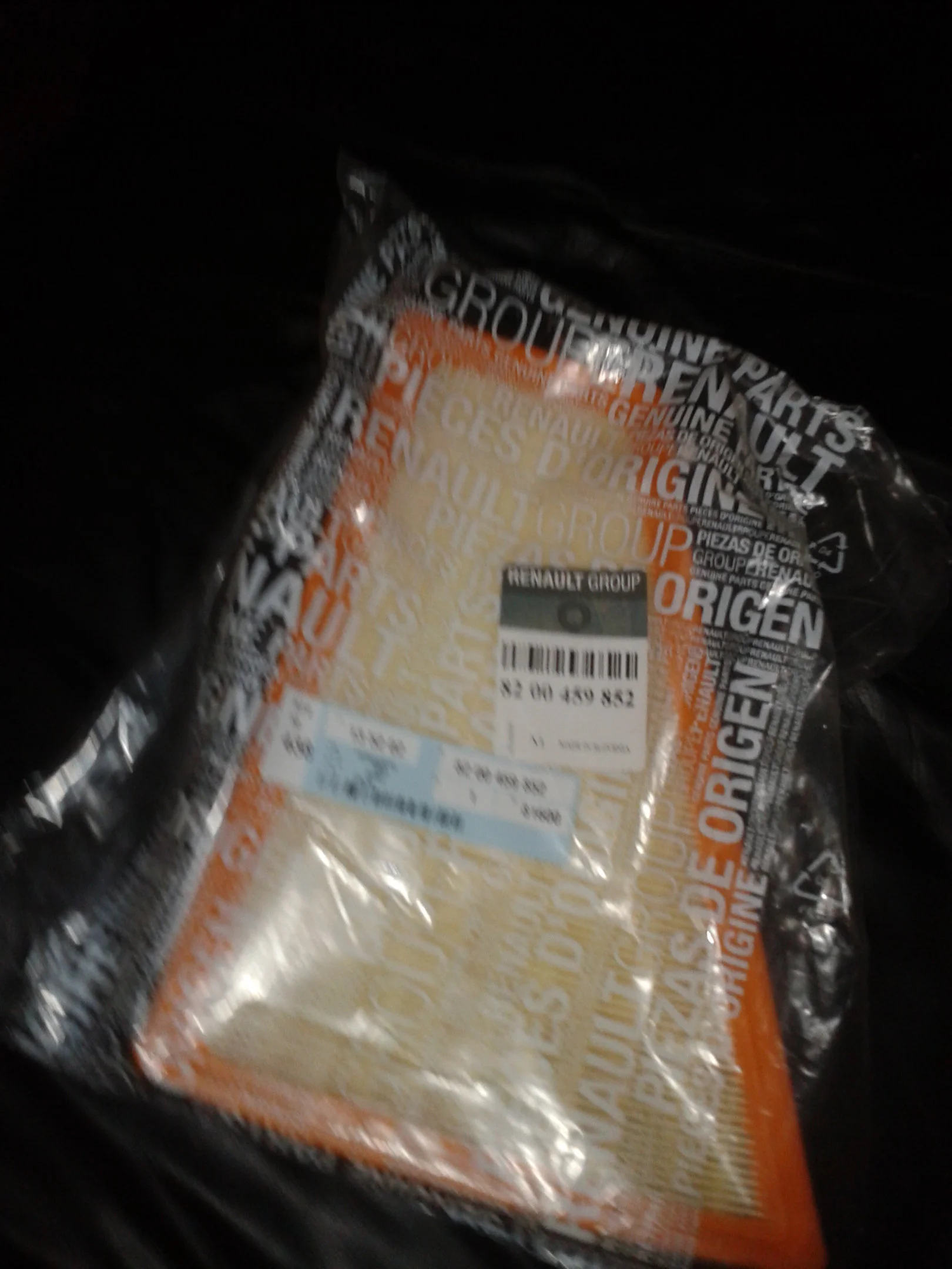

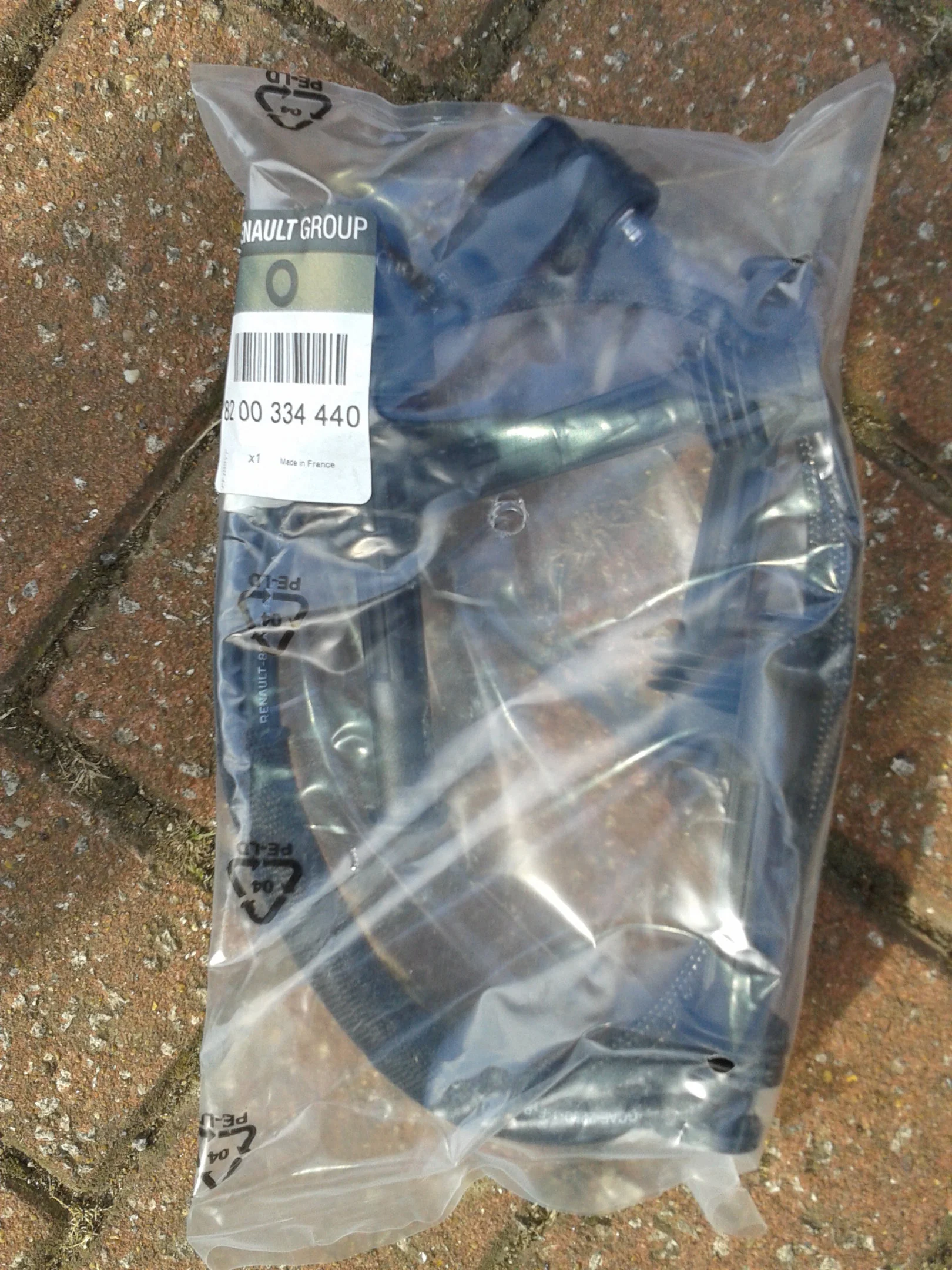

Ok thanks, I will get the plugs (they did not change them in the last service I had done), leads and lambda and change it, or have it changed. The costs are not that big.

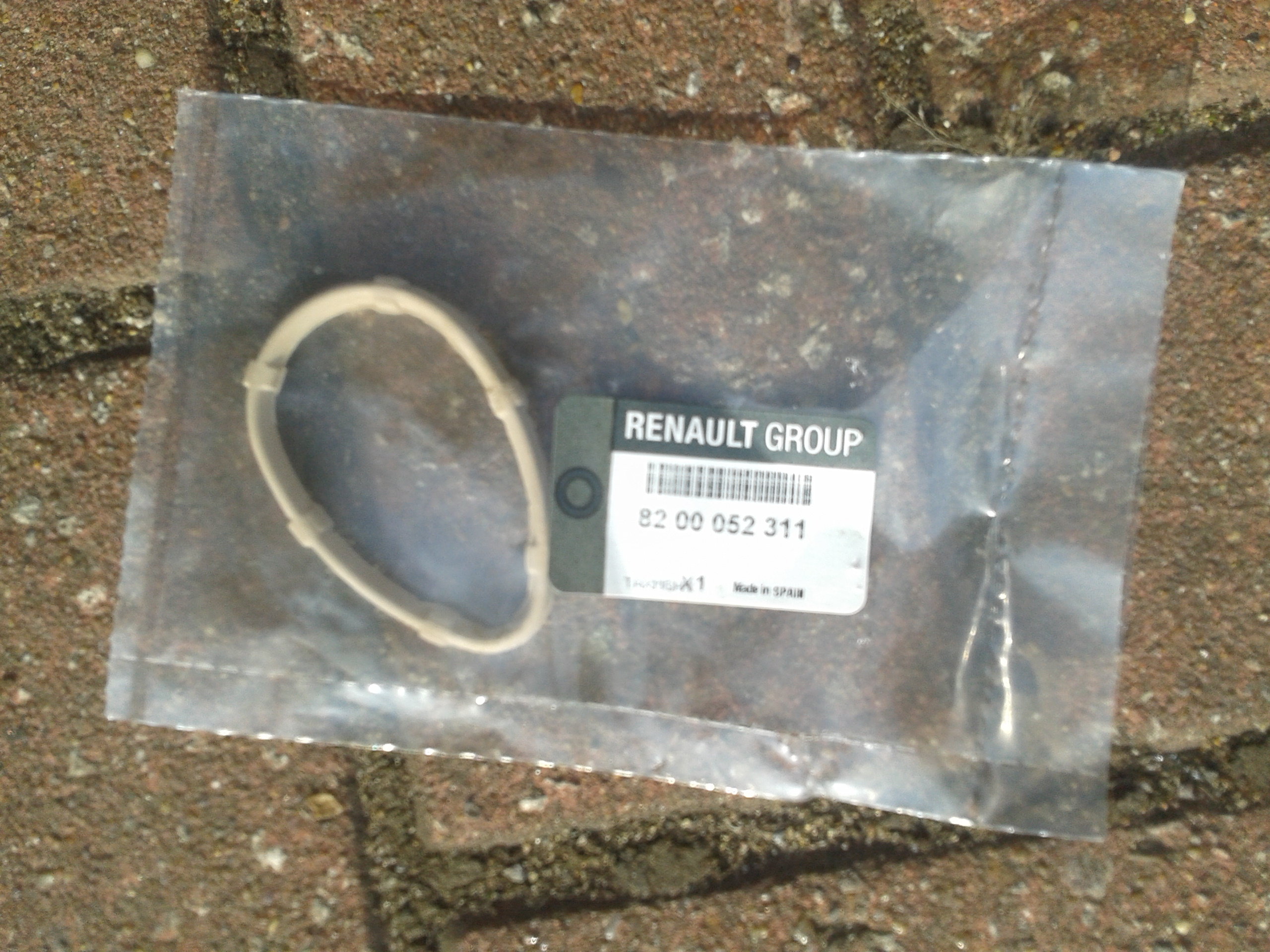

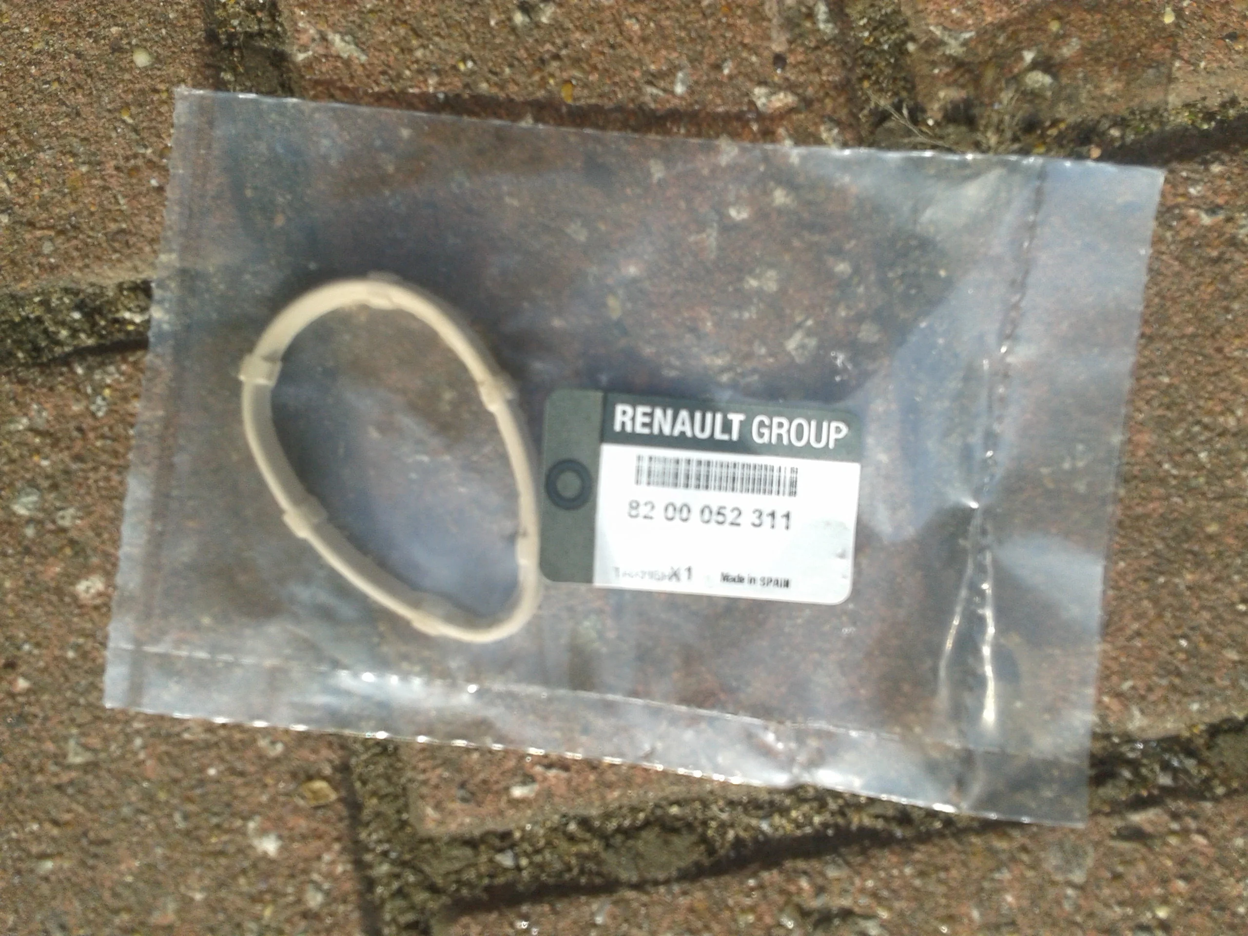

Replacing this would be a good idea also.
The one on mine was hard & brittle.

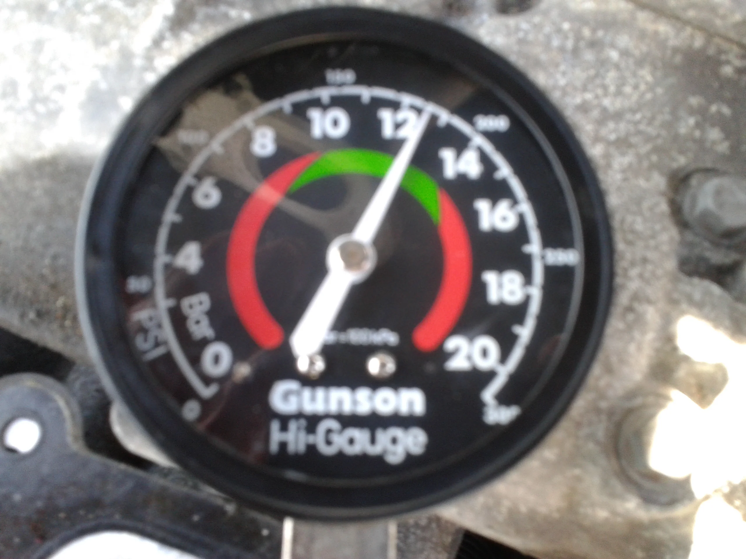

While the plugs are out, conduct a compression test.
The exact reading may vary from tester to tester, but the important thing is they all in the same field.
Genuine HT leads are £60, Bosch lambda`s £37 each.

I ordered the plugs, and I found the HT leads, but your HT-lead package seems to say "made in France" whereas I have found BERU, NGK, Champion. And they all seem to have slightly different lenghts. Would you say the NGK are the OEM? As you said the NGK plugs are OEM. But NGK is Japanese and your bag says "made in France"...
