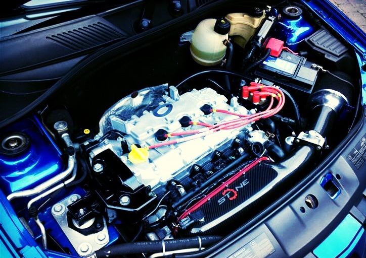

Alright, I want to have the Rs2 inlet removed from my 182 and go back to a standard set up. Is this a fairly simple job? The inlet was fitted by the previous owner and i dont have any of the standard parts, so would have to track these down.
Is this a job most garages could do, or more of a specialist job?
Apparently i need some 'paperwork' otherwise it cant be done :S
Thanks, Jordan

Piece of paper. FLOL. Take it to a specialist off here. Is it on the standard ECU? Take a pic of your engine bay and post it up as it will be easier to advise what bits and pieces you need.
haha okay, may have completely misunderstood what he said, but I couldnt think of any peice of paper that could possibly be relevant.
