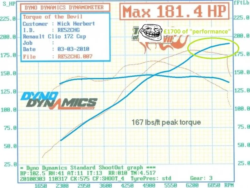

For the purpose of what you are arguing i have made a quick overlay of the graphs maybe to help you pull the cotton away from your eyes.
Your very mildy tuned engine on stock inlet vs stock RS2. One can argue they arent the same rollers on the same day, and this is of course true, but youd like to hope they are at least half way accurate, both of them being DD rollers is a good start.
Also comparing the two graphs it clearly shows I make alot more low-down torque
Could you please show me where this low down torque is, i can't seem to find it.
as well as making high-end torque
Again really? It does exactly what i first said it did when you slated me for not driving one, it holds the torque for an extra 500rpm over stock...
The only downside is that i've lost a bit of mid-range torque for all of 2,000rpm
A "bit"? You've lost 25ft/lb's for nigh on 2000rpm, how can that in any way shape or form be considered a performance enhancement? As far as the argument of "well its obviously not going to be as good as ITB's" which i can honestly understand, but its not even performing over stock inlet...
I look forward to your reply, because i expect because i havent driven one i have gotten it all wrong.

If you compare the standard graph and the RS2 graphs, you can see a good gain in low down torque, about 145 lbft at 2.5krpm staying nearly constant until 6.5krpm (standard about 125@2.5krpm, peaking in about 150 @5krpm and then dropping to 130 @6.5krpm). I would not take the second graph as a reference as it seems to have a bit optimistic figures for the modifications stated. And now tell my, why driveability is better when you have a really short peak of torque @ let´s say 5krpm against a bit less torque (10lbft) for a bandwidth of nearly the full rev range!? Don´t know why there is so much hate in here, it is our money we spend on these things, if you know it better then do it your way even if this results in a properly damaged engine. There are reasons why these kinds of inlet setups with a single tb are quite common on race cars. Maybe the RS2 is a compromise but from my point of view it is a far better compromise than standard inlets and retains the oem character of the car against an itb setup.

by looking at the graphs above, member Laine_16v has a poinit, again, just by going with the graphs.
Now, those with the RS2, have you tested against mildly modded clios to confirm the extra performance felt is not just placebo? I mean, will your cars pull away noticeable from a non RS2'd?
I have cams, and I would sware on god my car was much faster than before and had the wrong idea I would leave any other clio anytime, then I raced a stock car and to my surprise we were neck to neck in 1st gear, by the end of 2nd gear I was pulling away by just the first half of the car, then in 3rd and 4th I managed to create a gap of just two cars in between, and I have lots of money in it (but not RS2 money). I am very interested in this and not trying to fuel hate, but I was about to take the cash out of my pocket but need to be first I don't end up with a car that in real drive is actually slower and would pull better for 500 rpms before the limiter.

really you cannot get a good argument comparing two different rolling road graphs from two different places and then overlaying them. Rolling roads are dubious at best when results are compared like that. With the design being so similar to an ITB kit with airbox i'd be surprised if there were no gains, but hey thats never stopped loads of people fitting the maxogen and simota etc lol
Laine has done a fantastic job of overlaying two graphs, one result being in paint! lol Inevitably he's put the paint result line in for the RS-2 which is incorrect... Both RS-2 power/torque lines should be higher than that, it may seem like i'm clutching at straws with that but if your going to try and prove someone wrong do it properly! lol

^No way you´ll get in the 190s with a Maxogen, exhaust and remap. You´ll get 250bhp on the AMD rollers.... I think in this thread is also a lack of mathematic and reading skills. So guys: if you never learnt to compare graphs or do basic mathematic operations in school => Post tits or GTFO!
