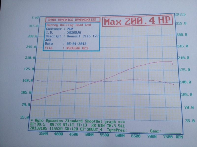

Anyone got a graph of the RS2 and 197 Cams? Is the torque line as smooth as it is with standard cams?
Just as smooth but slightly lower, when you fit the 197 cams you trade in some torque in exchange for it being far better at high rpm.
Here is Mikes Graph:
