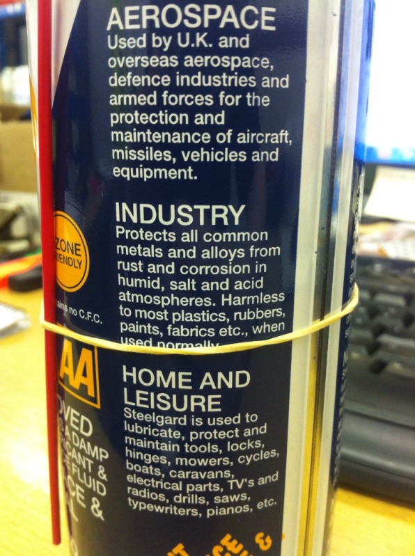

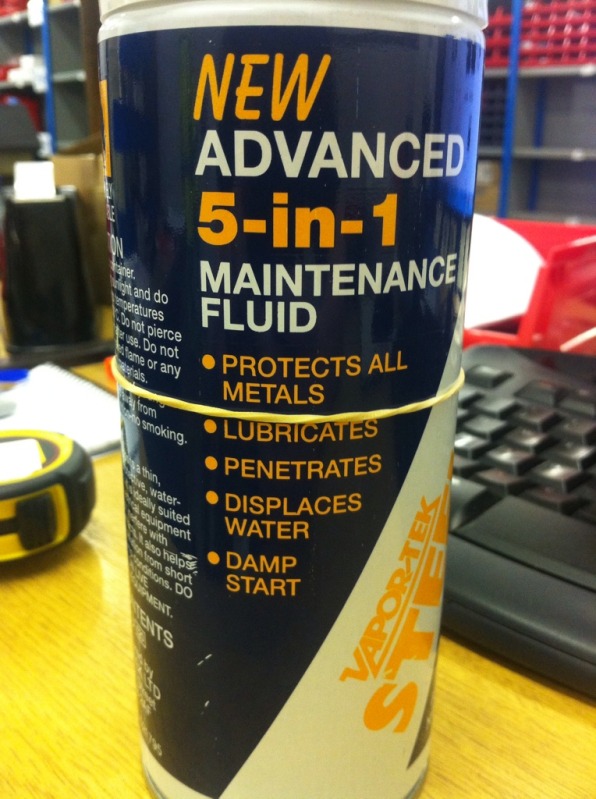

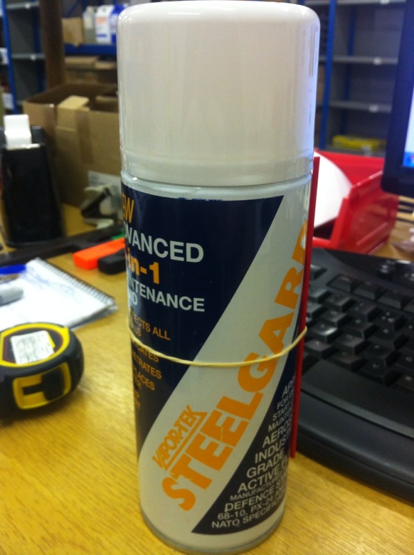

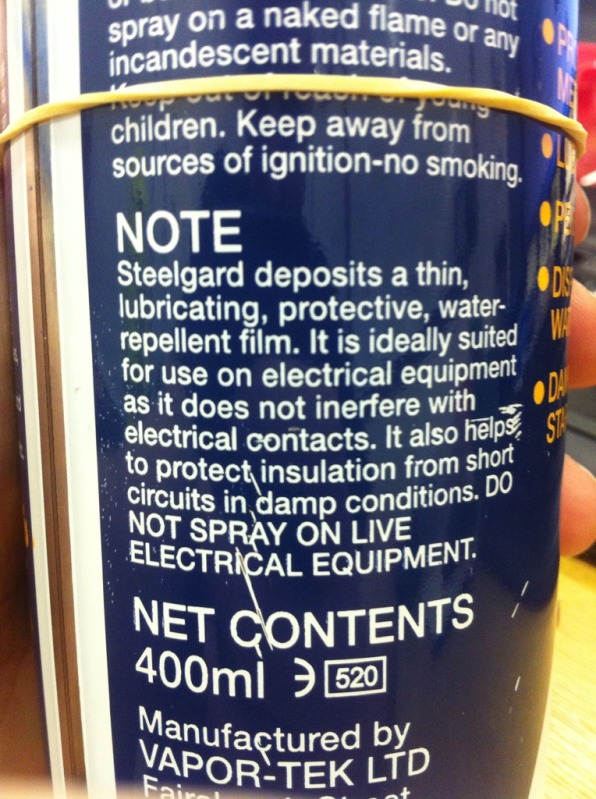

The stuff we use (just checked today ) Is made by a company called Vapor-Tek LTD
Heres some phone shots of the tin.
