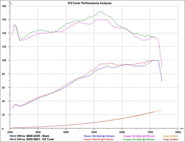

Just received my RS tuner kit, used the 6500 software with 5B03 calibration after some testing. The 6400 group N was pretty bad on my car, higher revlimit but less torque all around.

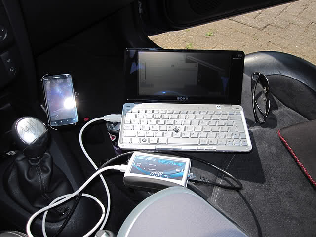

Hooked up to my laptop
The results, more torque across the entire rpm range but the same peak horsepower. You can rev it all the way up to 7500 with this calibration but that doesnt give any more power. Only more stamina (on the track when shifting would loose you time, stay in the same gear and rev it a bit more).
Well worth it, makes the car feel more alive. Also, the shaky idle has been fixed by raising the idle rpm just a bit.
