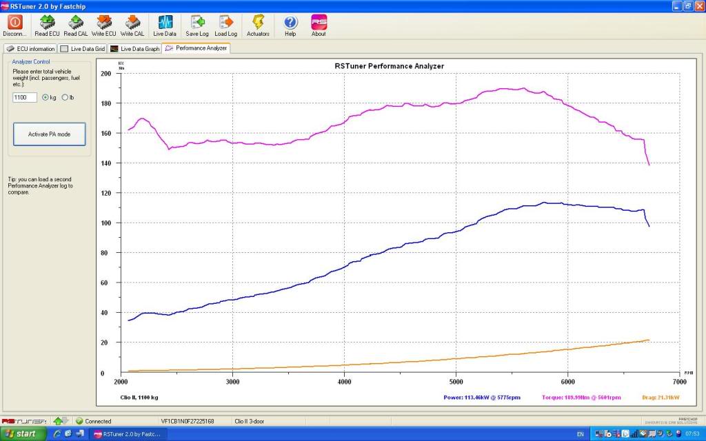

Did one this morning first time I've tried it...god knows if its correct??!!
In comparison to the RR day I did recently I had 141nm of Torque and 162.6bhp
This is showing 189.99nm of torque and 113.46kw which equates to about 152.15 bhp.
You have to keep in mind that a rolling road session is normally done indoors. And a live read done using the RSTuner is done outside. The road surface, wind and the humidity can all affect the outcome of the final result.
For a more accurate reading, you need next to no wind, a perfectly flat preferably half a mile stretch of road, which is as straight as possible.
There is not chance that the two readings you have are going to be close to one another. You have to take into consideration aerodynamic drag. Which when using the RSTuner calculates drag in KW. Which I would imagine is what you loose when comparing a RSTuner run to a Rolling Road run.
Maybe add the drag KW result to the power KW result and the outcome will be more true!?
