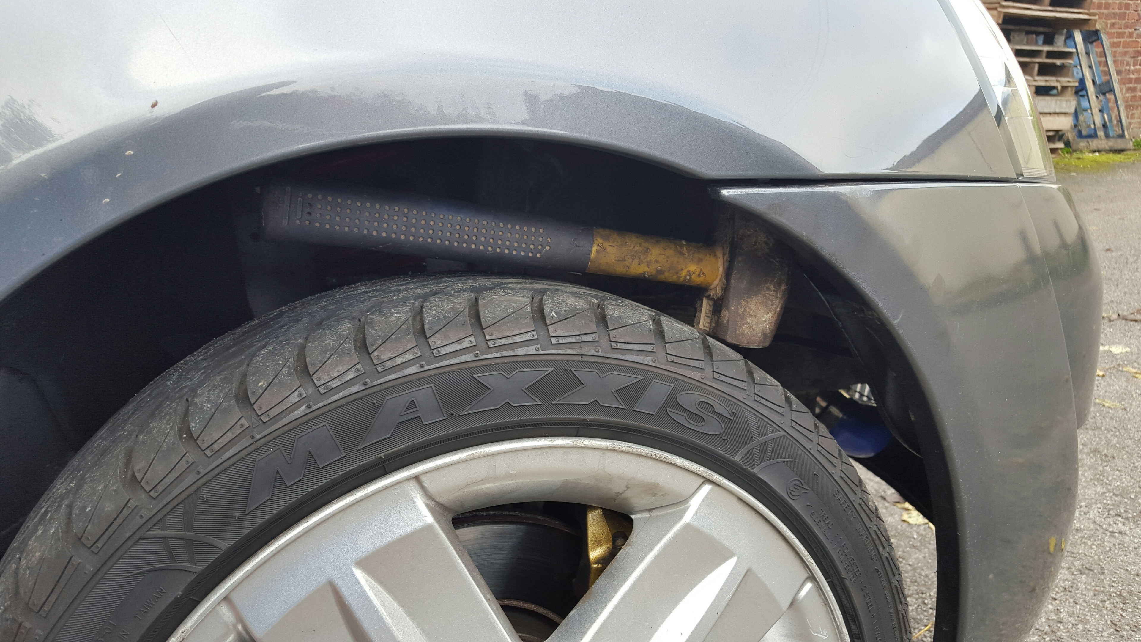

I used a hammer jacked up placed it between tyre n bracket then slowly let the jack down just to push it up abit job done no scrapping now :)

On the rubbing: if yours rubs on the bumper bracket do as in the pics above (you are lucky if so, mine rubs on the chassis near the braket)
