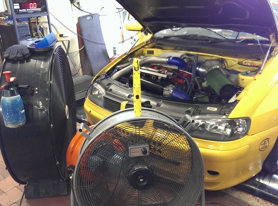

Rstuning fan is big enough that it sucks the door closed on the office when it's switched on.
Here's badger 5's setup

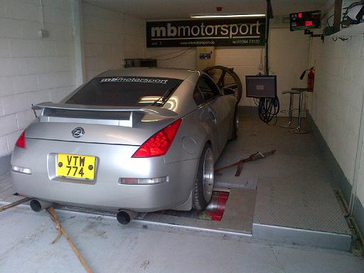

Here's what a dyno ramp rate should be.
That's boosted though? Chips turbo sounded like that at tiptons didn't it? So would a normal NA f4r still take about 30seconds on that one, or is the ramp rate adjustable?

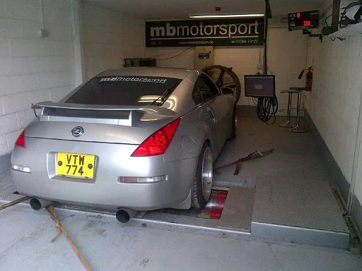

chips for reference...

any opinions on that fan I posted above? here is it in action... still 30 second ramp, but is the ramp vs cooling better? Looks like a pretty big fan?
Adey.
badger 5s fan setup struggles after a day of mapping, used him a fair bit over the last few years as im on the same trading estate, when i had my LCR we ended up misting the cooler and inlet with water to try and keep temps down.
